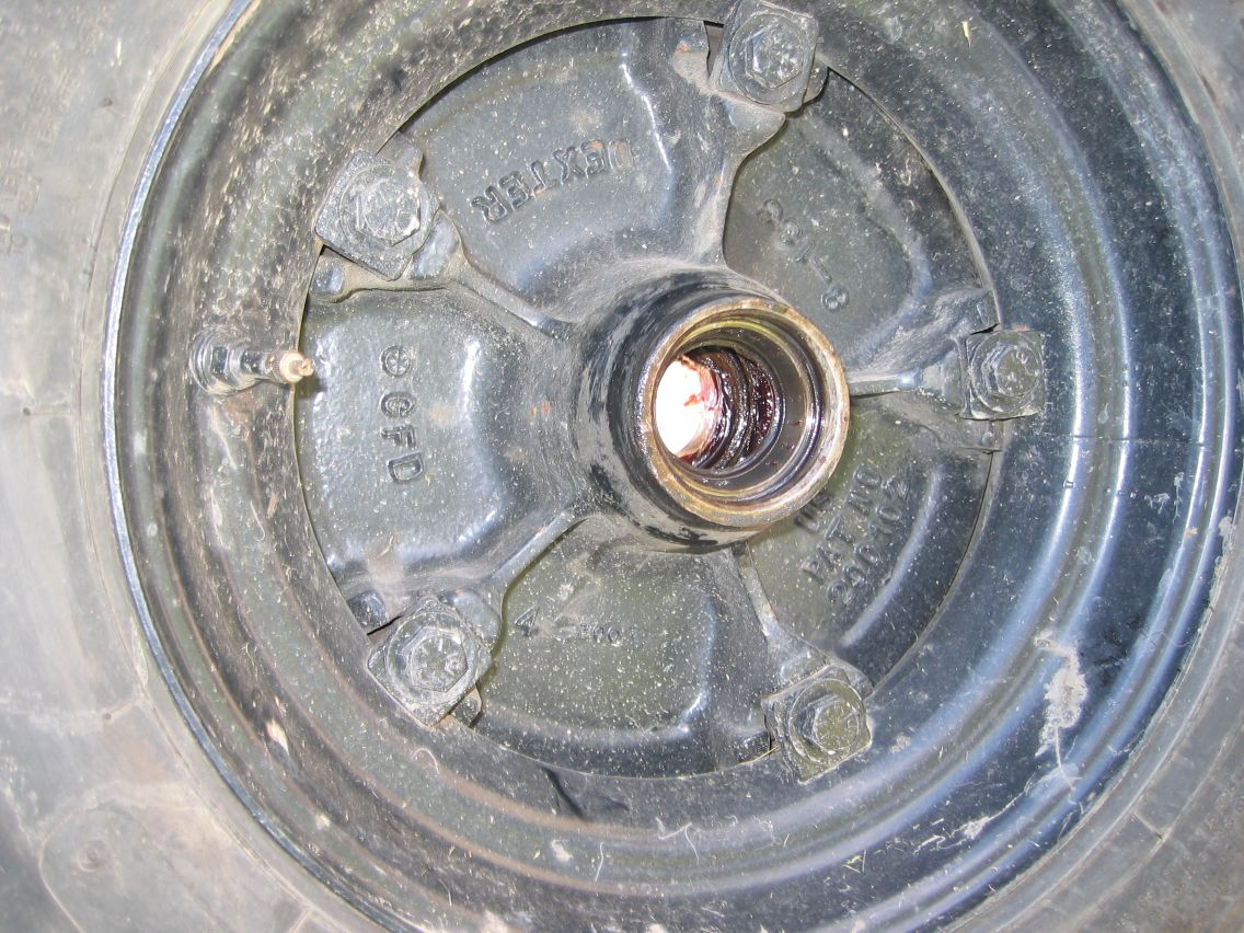

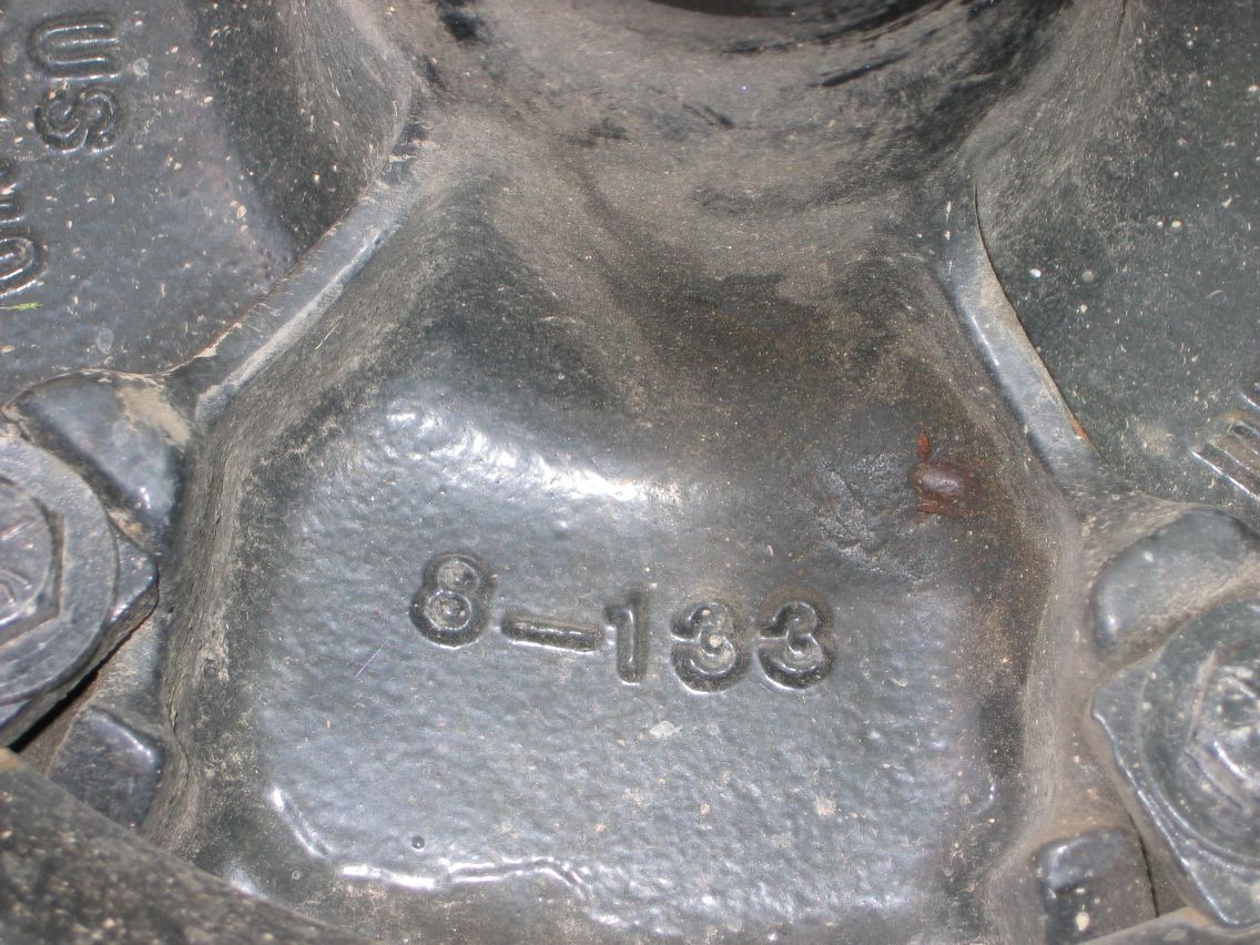

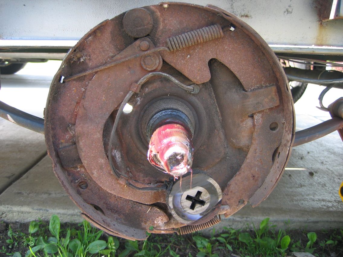

I have the ability to obtain a well used 18' trailer that needs a lot of TLC to get it on the roads legally in NYS...
One of the obstacles I have is the question around the axle brakes... Here are a couple of photos showing the hub, hub removed and brake setup.
Bottom line here is - these Dexter axles are apparently from a trailer (read single use mobile home)... and the brakes are not really supposed to be replaceable... after talking to the Dexter folks (who are AWESOME customer service kind of people) - they tell me I can get most all the replacement components I need - but I would have to grind off the large rivet attachment point at the top of the shoes - and replace with a low profile heat treated bolt.
I'm looking for opinions on the idea of replacing brakes on what is technically a non-replaceable axle (rated 6K for the mobile home - 4500 when used on a utility trailer) - or if I should just buy 2 new 6K trailer axles (the main difference is much larger bearings on the real utility axle and user replaceable brakes).
Cost for replacement parts - around $200 - plus annual bearing replacements at another cost of $200 - year over year
Cost for 2 new axles - $750 - all I need to do here is bolt the existing wheel on after the axle goes on...

Go for the new axles. More capacity and less hassle. No need to replace bearings every year in my opinion.
You also get the choice of buying a replaceable bolt on brake assemby rather than rebuilding the old one. Lots easier.:D Even I can do it.:D

I would replace the axle assemblies and get to a standard.
On my mowing trailer, if the brakes are shot, I can buy a complete axle with brakes for about the price of all the brake components. Sounds like your set is different, but I would still just look at getting to the standard designed to do what I was doing.

I too recommend replacing the axles. Be sure you are not re-installing tires that have "mobile home use only" moulded into the sidewalls. The law won't like seeing them on your trailer.

On most of Dexter's axles, you don't really need to buy a complete axle, but instead of buyng the individual components, you can buy complete brake assemblies, including the backing plate. That's easier to replace than replacing the axle. One of my brothers lives in a heavy 3 axle fifth-wheel trailer and he replaced all 6 brake assemblies and backing plates early this year.

I went through this a couple years ago too. I had built a trailer using MH axles and used it for many years. Then I heard metal to metal brake action and decided to change the brakes. To my surprise I found the same thing you did with the brakes designed for limited use and parts riveted in place. I called Dexter as well, I priced a complete changeover including backing plates but decided I did not want to put all that money and time into replacing brakes on my 16 yr. old trailer. I needed a longer and wider trailer anyway so rather than redo the entire trailer including brakes I bought a new one that suits my needs. If you can get the trailer really cheap it might be worth a few hundred for brakes.

For me it wouldnt require much thinking... $ 750 for two decent axles, or $ 450 to get new bearings and new brakes, plus a lot of work drilling out the rivets and re-doing the linings, ya might be able to do it, but how much time does it need ? plus, you still have inferior axles under your trailer. Spend those extra $300 dollar, they are earned back in 1,5 year and, knowing that your brand new axles are SAFE and RELIABLE are worth something as well.... :)

Thanks all -
Trailer - $0
New Axles, tires, and lights - $850
The ability to safely and with sound mind move tractors around to job sites - Priceless

The small bearings are the most minor of the issues... both axles need the entire brake unit replaced... but the mobile home axle design is single use - no replaceable parts for the brakes... The Dexter rep told me how I could "rig it up" - but the disclaimer was - inspections may or may no fly... and the cost of the parts to "rig" the existing set is about 75% of 2 new ones.
Also the current axles are the UTG type - so replacing tires is always more expensive...
I have finally found a place that sells Dexter axles - what I need - 6000# variety - 6 lugs - standard hub... for $218 each - everything included + EZLube bearings!
