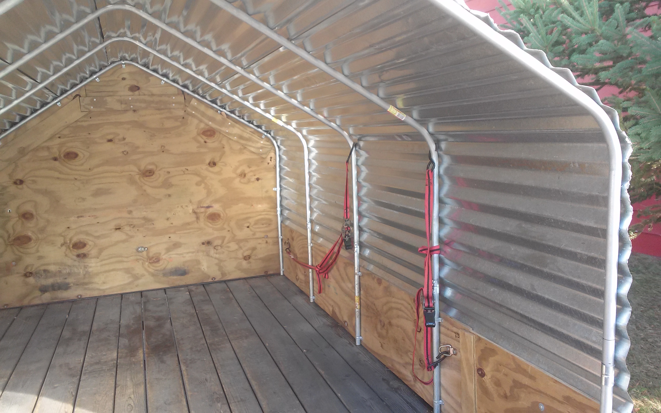

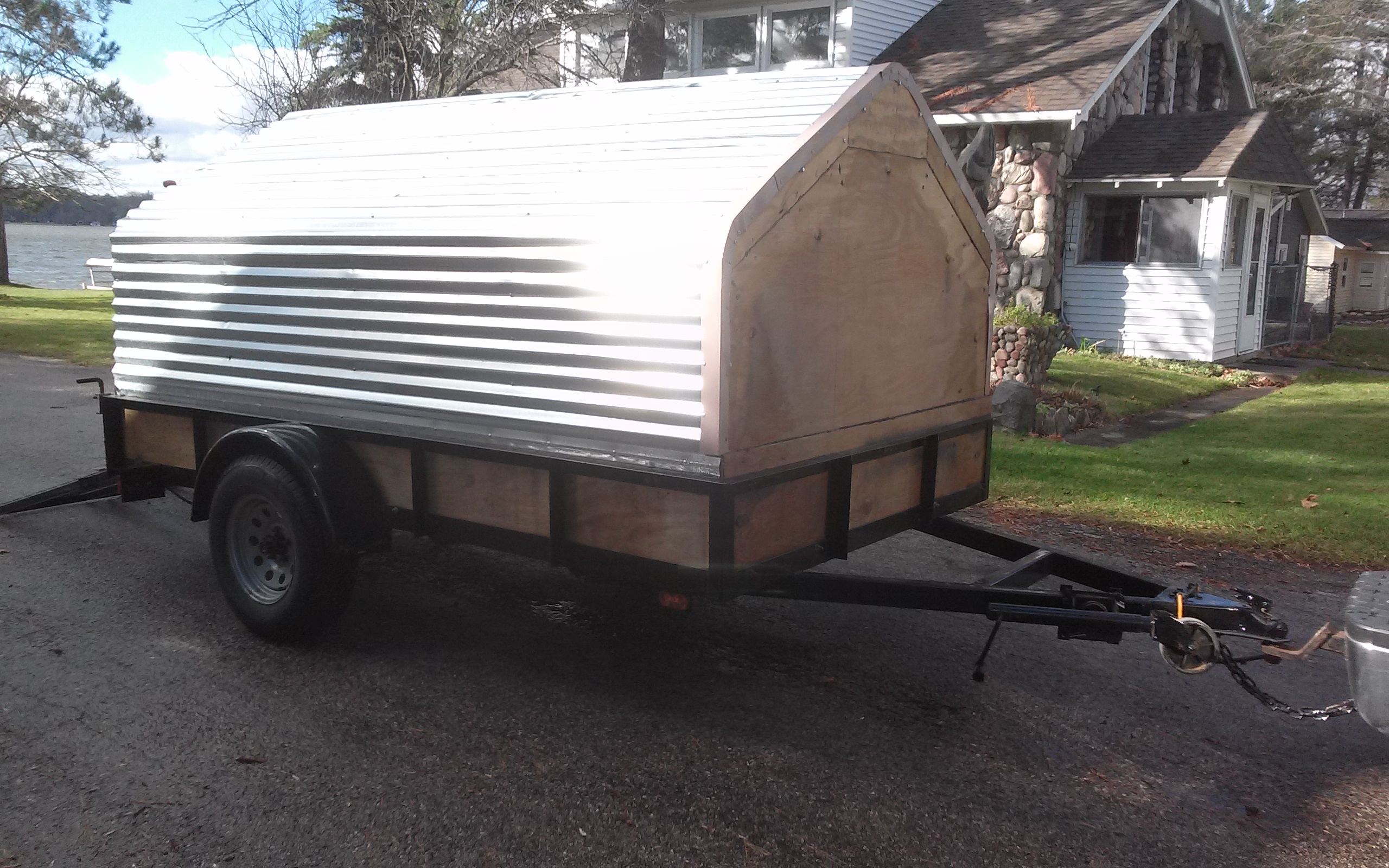

On my 6 x 10ft open trailer with 14" open sides, I fastened 1/2" exterior plywood to sides and front. Then I bent 3/4" emt for studs and rafters. Then I sheeted it with metal barn roofing. It is used around town, not on the freeway. I would consider 1" emt but it takes more to bend. I can try for better pictures if you need them. Jon

On my 6 x 10ft open trailer with 14" open sides, I fastened 1/2" exterior plywood to sides and front. Then I bent 3/4" emt for studs and rafters. Then I sheeted it with metal barn roofing. It is used around town, not on the freeway. I would consider 1" emt but it takes more to bend. I can try for better pictures if you need them. Jon <img src="http://www.tractorbynet.com/forums/attachment.php?attachmentid=466191"/><img src="http://www.tractorbynet.com/forums/attachment.php?attachmentid=466192"/>
Very well made! Nice work!!!
