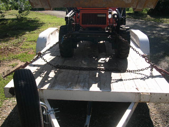

How do you guys anchor the BX2200/22/23 with chains (i.e. anchor points)? I do not see a lot of great frame options though possible.
Also, somewhere in this thread someone recommended dual brakes on the trailer. How necessary is that? I have been considering a 6.5'x16' 7000lb trailer, but seems most come with one brake axle and one idler axle.

One braking axle is sufficient (on the rear axle), but both axles with brakes will fade less and generally work better. Trailer brakes are not as good as vehicular brakes and are much more susceptible to fade, so the more area you have the easier it is on them and the better they'll work.
edit: oh yeah, tie downs. I go through the front of the frame and through the 3pt hitch .

Get your self some firehose to protect your paint,to slip your chains through.HERES how i do it,the state dot said 4 corners,and each attachment,2 chains over the tractor would constitute 4 corners they said. but lets not get into that law thing......
one chain behind the grill gaurd,THATS THE EASY ONE
another chain under the swing piston on the hoe, OR you can run it in front of the rops. i have done this but it strains the fenders,so i cheat and put it under that bh piston.
another over the hoe bucket
one to the hook on my front bucket
the tough one is that rear tractor one,when i haul my chipper,i end up with 2 on the chipper[one on the 2 point hitch] well atleast im trying to please em.

4 corners, independently tied off... I use two chains, one front and rear. But I use four binders. Each corner is tied off and bound. Slack chain sits in the middle of the trailer...
It would be nice if they gave better detail, at state and fed level. Maybe even, a picture or diagram /forums/images/graemlins/shocked.gif Doubt that will happen though.

Front. Chains attached to corners of loader frame, bound to trailer. Loader bucket is up for the picture.

Back. Note how my B8200 with the 4' rotary mower fills the 16' trailer, even though weight wise, it is relatively lite.
Also, I didn't safety wire the binders; I had just loaded the tractor to take some pictures for a similar thread this summer. Also note for the eagle eyes, I had a pto shield on order at the time...
Also note the spare tire! It has been used... Most trailers don't come with one; that is how they keep the price down. You can get the trailer for a good deal, but have to add accessories to it.

Thats a good job hooking that down,but these bxs dont have them places,the back is really tough,with the hoe on,the chain gots put on the attachment,rather than the tractor,which isnt what our dot up here wants..." TRACTOR HOOKED ON 4 CORNERS..and each attachment hooked down.this came right from the stAte police headquarters,last spring,when i went to see what i needed.
