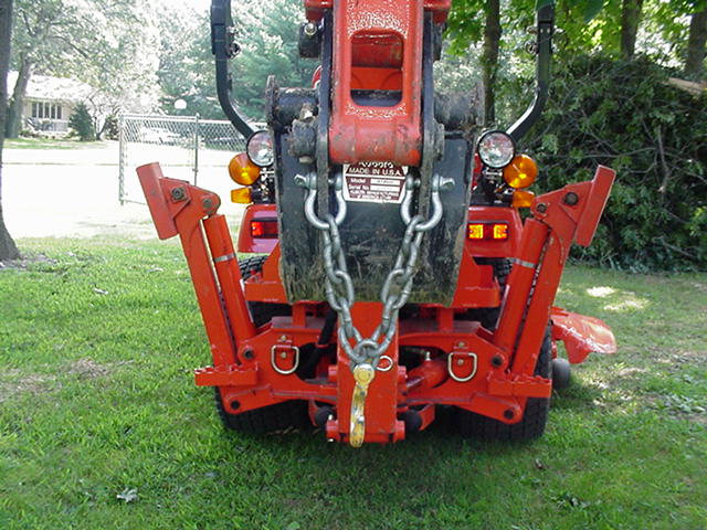

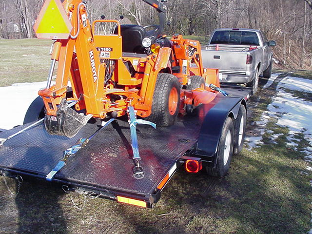

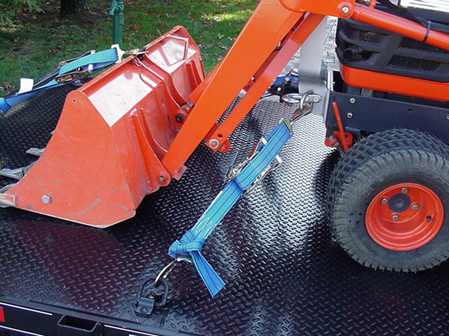

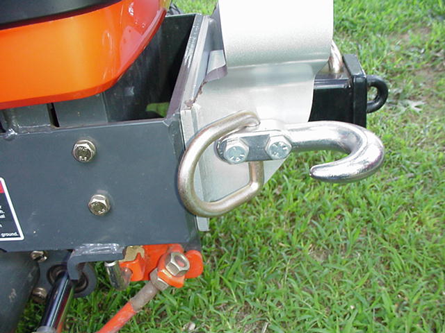

I guess I'm the guy who posted the picture of the "D" rings on the backhoe. See attached photos.We have no problem running two hundred miles to my upstate house from Long Island.

The tow hooks & "D" rings came from Tractor Supply Co. I think the hooks were about eight dollars a pair. The rings were about five or six bucks each.Please don't hold me to prices, I'm terrible when it comes to remembering prices.
The harness was made by drilling 3/8 holes in the hoe bucket web.The shackles are only 3/8, the picture makes it look much larger.The chain I had laying around and the slip hook came from TSC too.
The tow hooks were drilled on my drill press. You drill the holes as close as you can from the edge and then use a hack saw to slice them. The front rings were tapped into the brush guard and was backed up with a nut and lock washer. The backhoe rings was done the same, except it was backed up with a lock nut.
