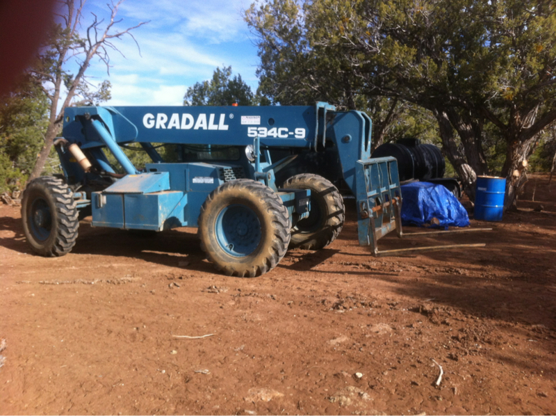

I have a telehandler that weighs about 26,000 and needs about 23 feet to be transported. I had it delivered with a big rig but was wondering if I could haul it on a smaller trailer. If so, would be required? It must have ramps. And what would be needed to pull such a setup.

You need a truck with a GCRW of at least 50,000lbs.
I'd get a single axle Mack, IH, etc. dump- older with a non electronic diesel and air brakes and a 20 ton tag. That's what I did and I'm happy. With the recession, there's a lot of backhoe and trackhoe pulling rigs out there for as cheap as I've ever seen. There's also the single axle tractors out there with low boys which are even nicer, but no dump truck body
Air brakes make the whole setup work so much better.

You will need a CDL in most places to haul that telehandler,,, the trailer will have to have about a GVWR 30K(wgt of trailer + telehandler)...Even then, you might go over the axle ratings of the trailer if you aren't careful with your tongue weight, based on where it sits on the trailer.

GVW for my F8000 is 27,500, so with the truck weighing 15,000 and the telehandler weighing 26,000, the trailer would have to be minus 13,500 :)
Looks like I'll just be paying someone like Empire to haul it if I want it moved.

Bo, I don't even know if you will find a GCWR for you truck. It sounds like you have a HD truck with air brakes so you should be fine with a tag rated at 40K.

You are not going to find a GCVR on the trucks data plate. Your truck should be able to trailer that telehandler without a problem on a suitable tag trailer. I'm not sure what your empty weight on that truck is, but I'm going to guess it is around 15k give or take. Lets say 11K for a 20ton tag, and 26k for your handler. That puts you in at only 54k gross. As long as you keep your axle weights legal you should be fine. I have personally run 3208 equipped trucks, with 5-speed Allisons :confused2: at 65-70k. You are not going to win races, but the 3208 will get you and your load there.
Laws vary state to state, but if you can legally qualify for the farmer CDL exemption it should not make a difference if you are pulling a trailer or not.
Tag trailers are cheap these days, when I was looking for my 14k deckover I found lots of used 10-20 ton tag trailers for half of what the 14k trailers were.

I actually took the written test a year ago, but then after talking to a number of people, I backed off. One item of concern was that my insurance agent said my rates would go up once I got a CDL. Another is that if I happen to get one of those photo tickets for speeding (which I did a month ago), the CDL prevents you from getting it purged with attending traffic school. It just didn't sound worth it to me to pursue the CDL.
