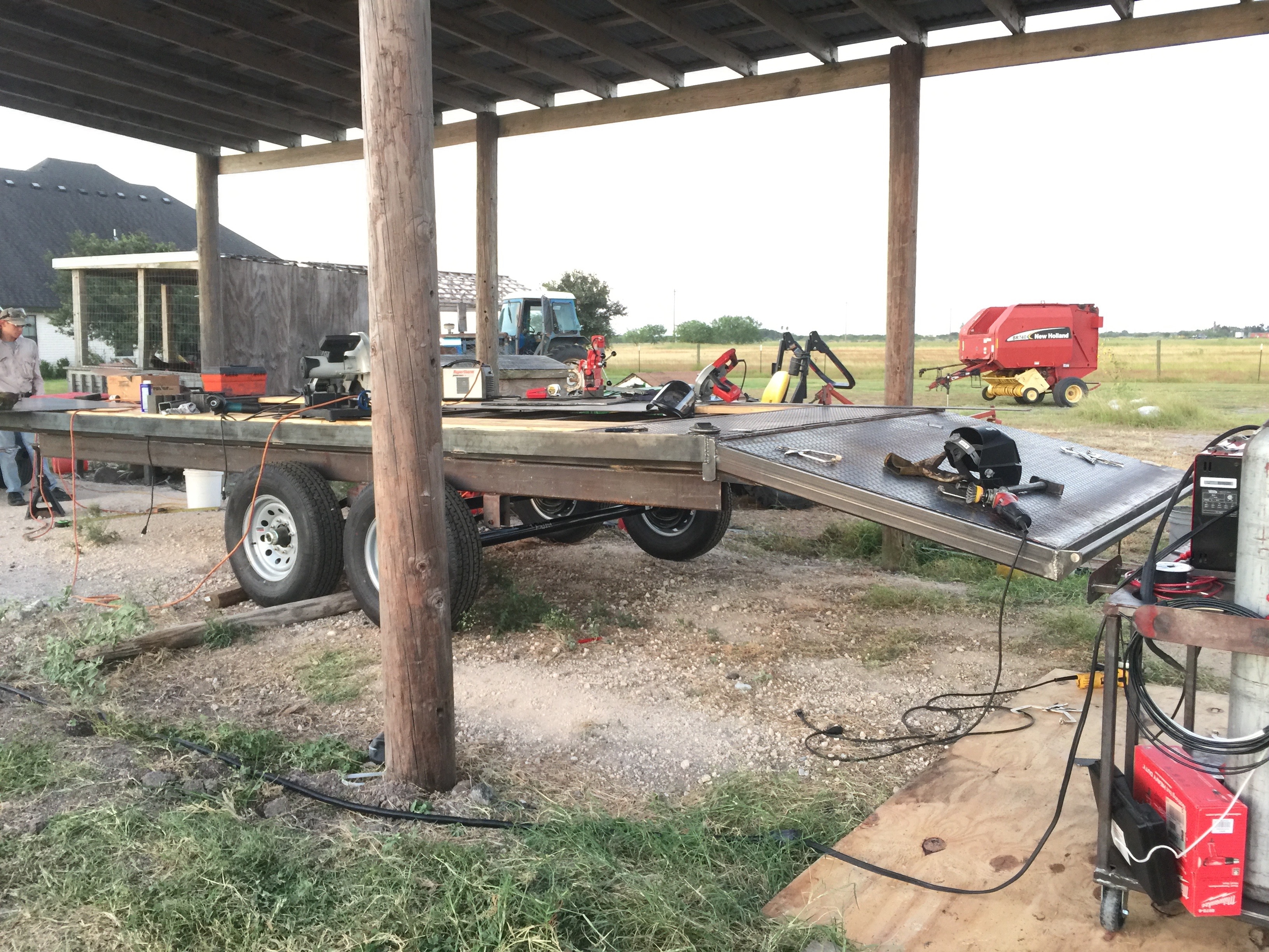

I wanted a high trailer to eliminate a lot of trucks that can tow my trailer away. I do realize that if someone wants it, they will find a way and take it. This just makes it harder to do so.

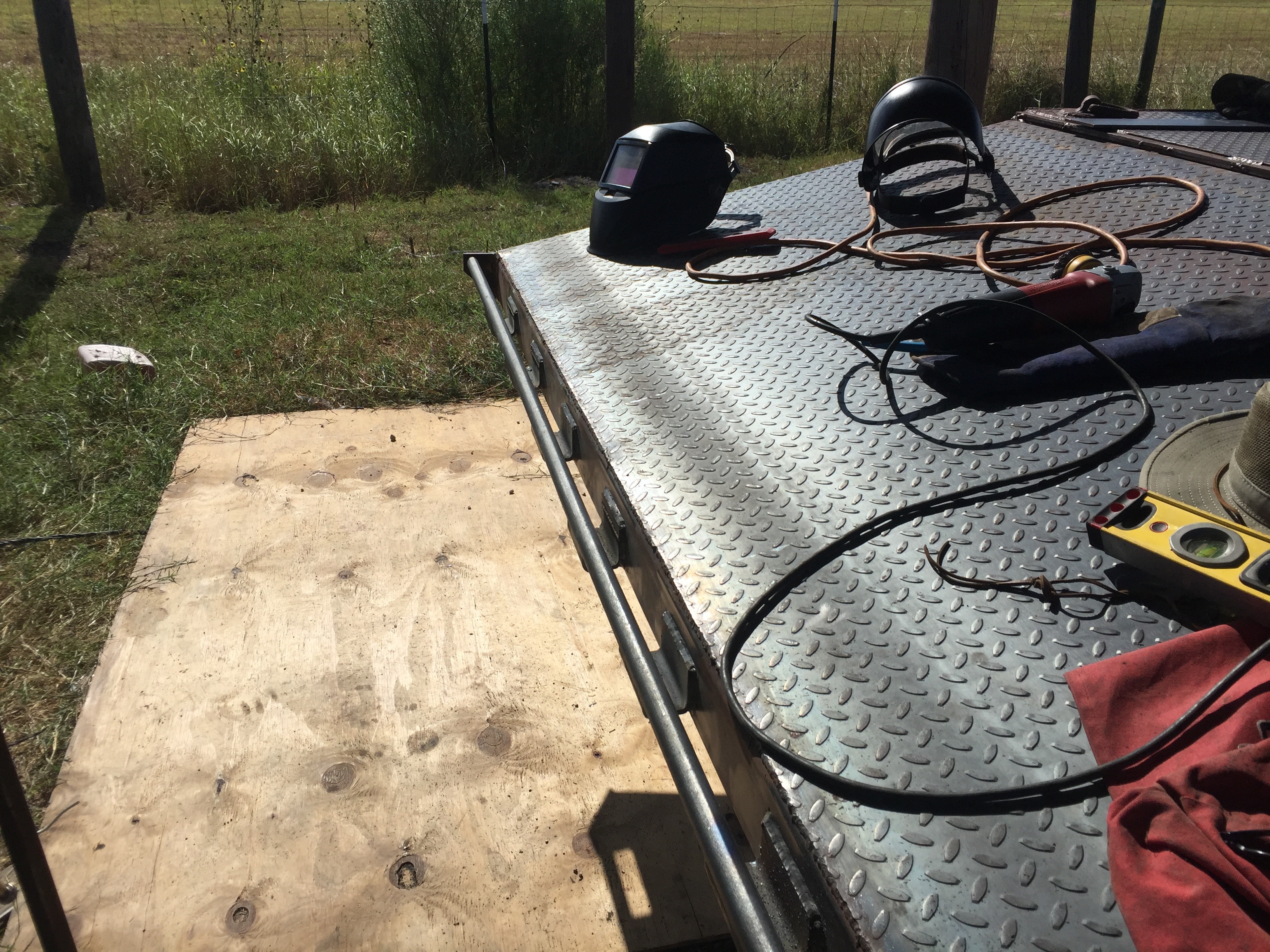

Got the dovetail decked out.

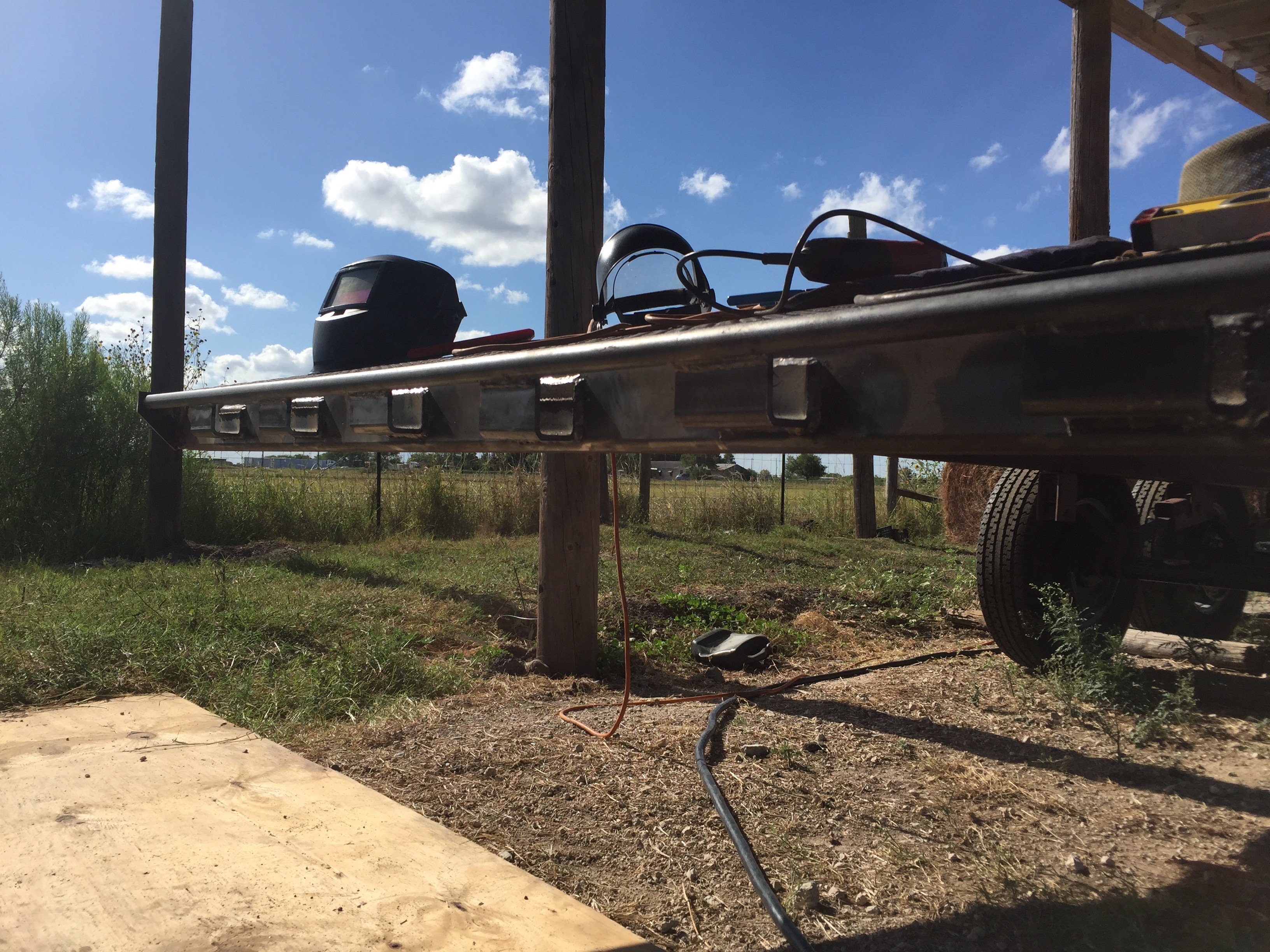

Want to place the ramps anywhere along the bar, so came up with this.
Used a 2x4x1/4" rectangular tube cut in 4" pieces, then cut in half. Centered a foot apart.
The bar is 1".
