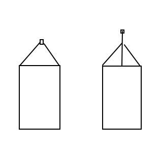

I just bought a new 6K dump trailer. The hitch assembly is so short it is hard to back up easily; needs to be 18-24" longer. Has anyone seen or heard of a manufactured solution. Or, has ny one done a modification on these light frame work trailers. There is no heavy channel or box frame members to work with. Solution needs to be legal also.

If yours is like the one on the left, change it to the design on the right.
Bruce
Bruce
Mine is the left one. That conversion would be major major project requiring a certified welder which I am not. That was my first thought process discarded for the reason.
Ron
Ron
Might be an easy task for a welding shop though.
