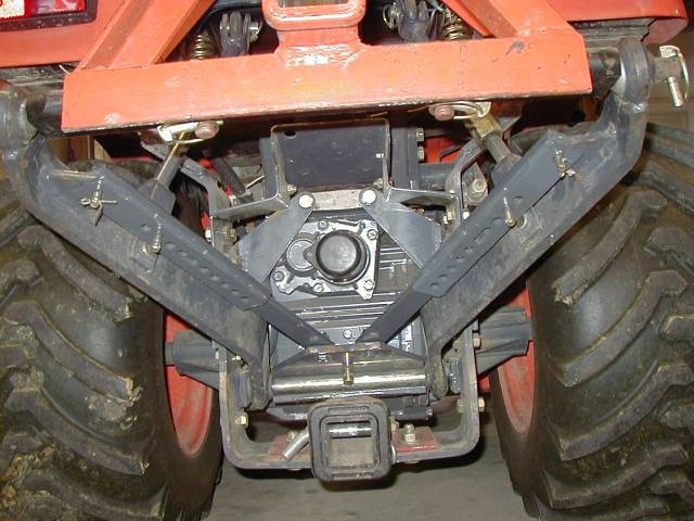

Here's a shot of what i came up with
   / Trailer Hitch for my BX2200 #15
In the last shot you can see the stabilizer links changed to the telescoping type. Possibly the best modification i've done so far. can see more pics in ATTACHMENTS section, along with several others who changed to this setup.

Milkman,
Very nice design, I have been thinking about adding a "receiver" to my design to push my trailer a little farther from the tractor for tight turns. Thanks for the photos.
<font color=blue>...stabilizer links changed to the telescoping type...</font color=blue>
Where did you get those telescoping links???? Man, I could use a pair of those!!! /w3tcompact/icons/smile.gif

Danny
Here is a link to a current thread that gives all the information needed to install lift arm adjusters. <A target="_blank" HREF=http://www.tractorbynet.com/cgi-bin/compact/showflat.pl?Cat=&Board=implement&Number=139727&page=&view=&sb=&o=&fpart=all&vc=1>Click Here.</A> I have been following this thread since the parts are from a B2910.

Milkman,
What was you total cost for the new stabilizer links?
Thanks,
Danny
   / Trailer Hitch for my BX2200 #19
Danny, I got mine from Carver Equipment. Total cost was was $53.25 for the parts, tax and shipping.

any way we could get a photo of where the lower pins are installed...that is the only part that has kept me from building one....thanks!!!!
