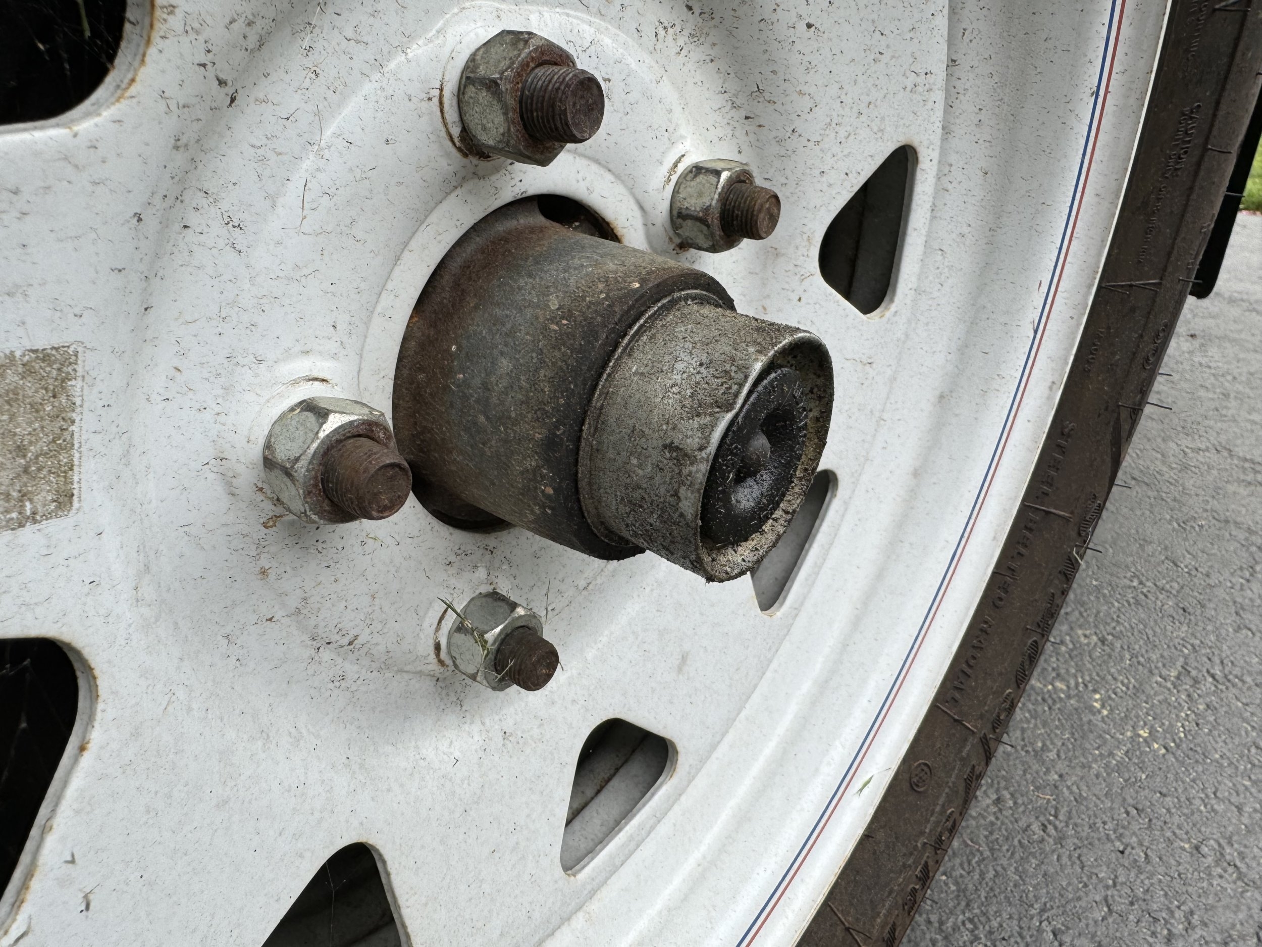

Agreed. This is weird. Just to be clear, you're saying these are EZ Lubes, with the usual rubber center plug in the cap, but you're losing the steel stamped housings that hold the rubber caps?
I've owned a lot of EZ Lube hubs, and I've never seen anything like that. The rubber plugs are leaky enough that there's no real chance to build pressure.
For anyone who doesn't know what we're talking about, look up EZ Lube hubs. They're a great rig, and they're already vented by means of a rubber cap with a grommet ring, which never fits air-tight. They're also unlike normal hubs, in that you end up totally filling the cavity with grease after a few maintenance cycles, as the new grease pushes the old grease out into that cap space, and eventually out around the grease gun fitting.

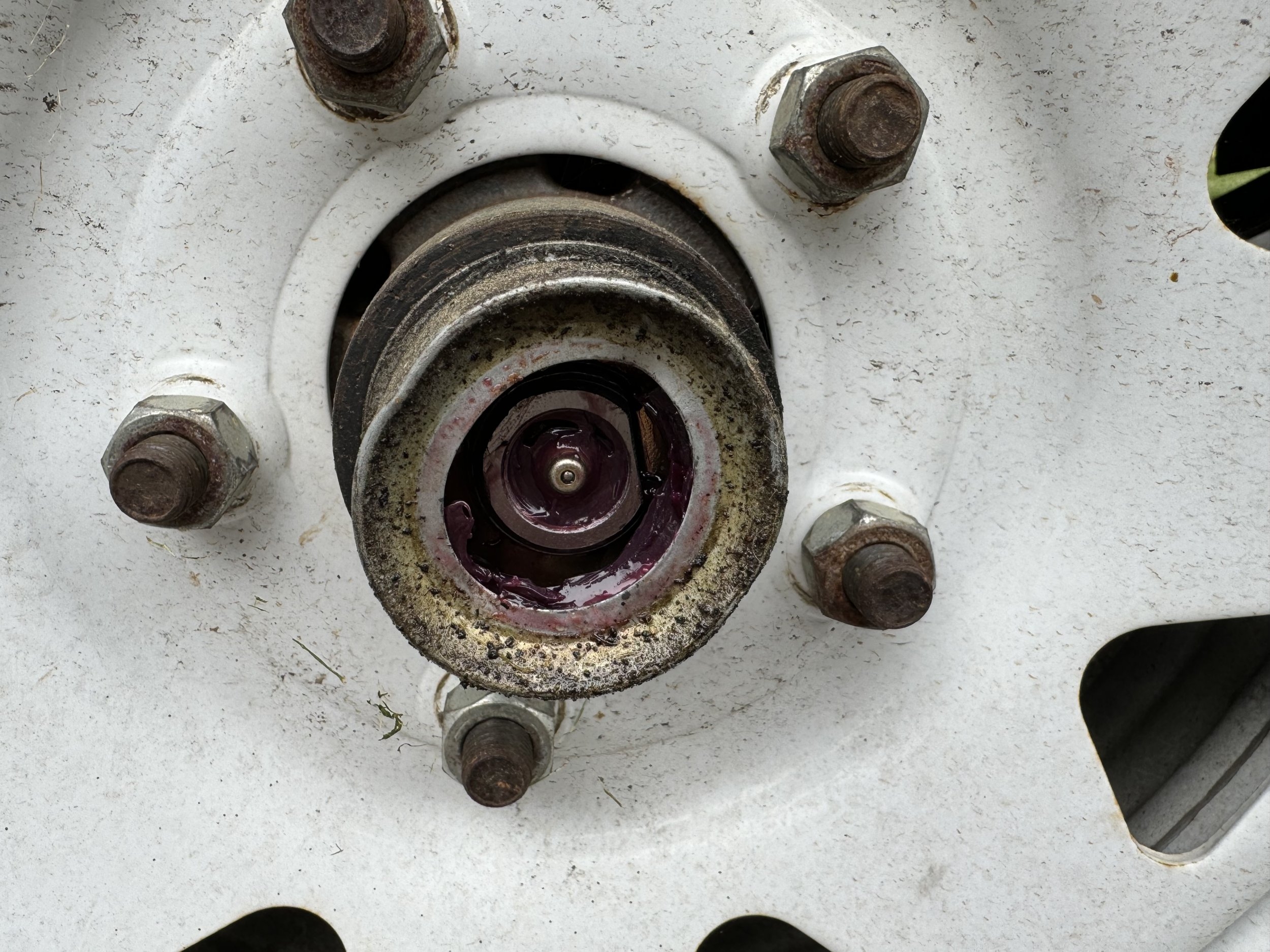

Yes they are EZ lubes. I redid all four hubs with new brakes assemblies and new inner and outer bearings and races. Reused all four grease/dust caps. Three have remained on and one was shed on the first day. Replaced with a new cap twice on return trip and shed again. Have now lost three all on the same hub. The other three original reused caps are holding just fine, at least so far they are holding after 1000 miles.
/ Trailer hubs shedding grease caps #24
Empirical evidence indicates that this is a problem with the hub itself. Maybe there is a hairline crack in the outer bore that allows the cap to work out due to force redistribution during rotation.
If close inspection and a dye pen test doesn't show anything, swap sides and see if the problem stays with the hub (I'd probably strapping tape a lanyard to the cap so it doesn't get lost) or with the original axle location. The spindle could have a slight bend that would set up harmonics that worked the cap off, but that's admittedly getting into the weeds theory wise.
Are you losing the rubber cap that you remove to grease the zerk or is the metal ring holding the rubber not staying in? :unsure:

No it is not the rubber inner plug it is the entire metal grease/dust cap. Now having said that the rubber plug I presume went with the cap

The wheel bearing may be too tight, producing more heat that normal. Supposed to be 1 flat off from slightly tight. Make sure the Cotter pin isn't interfering with the cap.

I guess you missed the temp readings that were taken of the hubs. (earlier posts) It is not getting hot or even warm. I wish it was something simple like that but so far nothing is jumping out.

One old RV trick is to dimple the sides of the friction fit area with a punch. Dimple them outwards.

It's not the heat from excess bearing conditions, but usually water vapor from the atmosphere going in and out as the air pressure changes, or the hubs see water from rain. Those caps are usually tapered in a manner that they want to come out, so any little inside pressure will do the job.

I think the rubber plug would blow out way before it pushed the metal cap out. The metal cap takes a very significant effort to get in and to seat. I may try the dimple idea but has not happened in 17 years with this trailer until now and somehow it has to be tied to the brake assembly and bearing R&R.
I have to disagree that the caps want to come out. They are a real pain to remove when pulling the hub and brake assembly.

This person had a new trailer and after 450 miles, the cap was found to have fell off, just like the OP. He got a new axle under warranty because it was "defective". Some of the people on this thread are not fans of the ez-lube system and I would agree. I grew up repacking wheel bearing at a garage and never had problems like this.
https://www.airforums.com/forums/f437/problems-with-new-ez-lube-axle-244673.html

Yeah I kind of ignored the suggestion as there is no cotter pin and I did not want to call it out so I just said nothing.
To the best of my knowledge EZ lubes never have cotter pins, maybe some do but not to my knowledge as the cotter pin would go right through the grease channel and block it so they use either a tang washer (not a fan of) or a special spindle nut retainer (which is really kind of cool device).
