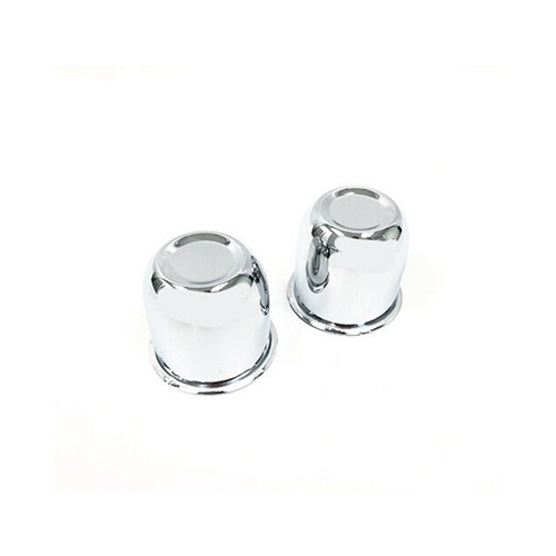

I don't care for center caps because you can't monitor the hub temps but maybe use them to hold the grease cap on. Measure the void and fill it with something.
Southwest Wheel Two Pack of 5 Lug Closed Push Through Center Caps 3.19" Outside Diameter for Trailer Wheels - X2319 | Southwest Wheel®
