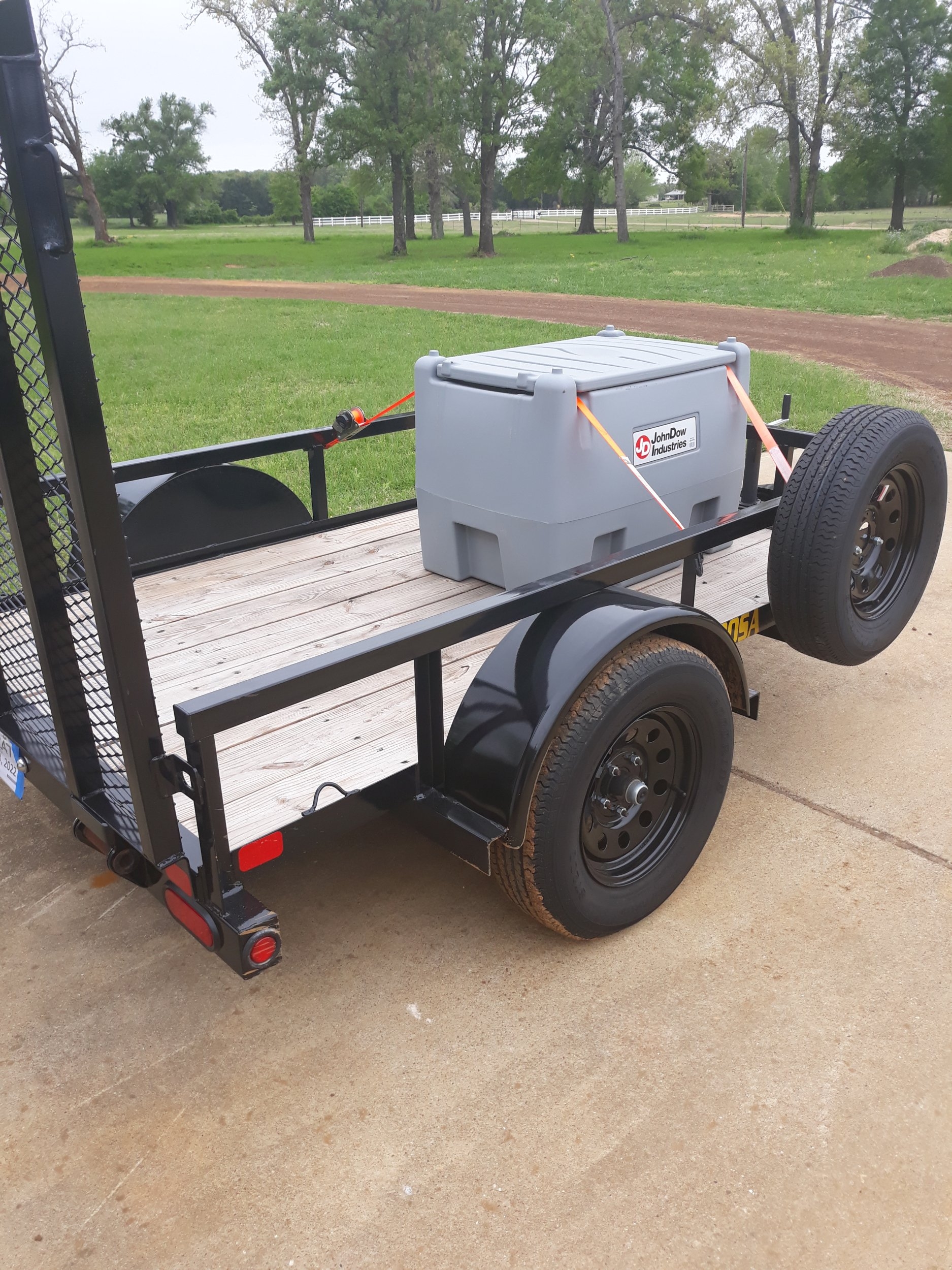

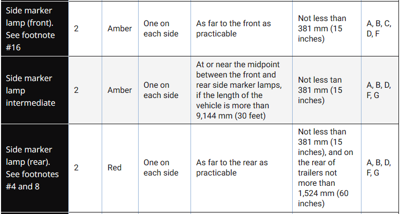

What is the correct color for the rear most side trailer lights is it red or amber? I know the other side lights are amber.
I'd look are my trailer, but I noticed that all the side marker lights are BADLY faded.
/ Trailer Lights Question - Rear Side Lights #2
Mine all have red.
/ Trailer Lights Question - Rear Side Lights #4
Red, most tailights have a red window on the right or left side so they're rear marker lights as well as rear side lights as well
