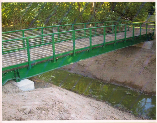

For better visualization heres a pic I found on google images searching "railcar bridge"

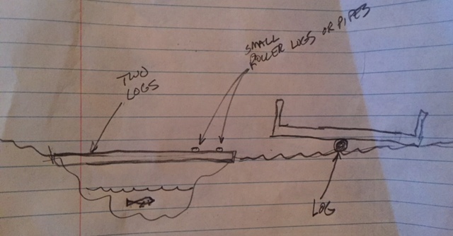

There's a way to do this without hiring a crane, and have some fun too. I would worry a little about the single axle sinking into the ground you might do all this better on logs. You have a 6000 lb tractor, but?.do you have logs? Or can you get some?
Here's an idea - skid a couple big logs across the stream and set them wider than the container. Then have them crap the container onto a fulcrum log crosswise. Set another log then drag the container over the logs, leapfrogging fulcrum logs until you get to the stream. If you can keep it near the balance point you can lift one end with the tractor. It either slides over the fulcrum log, or with luck, rolls the log, and doesn't roll on down into the stream. Cantilever it over the rollers on the two stringer logs then drag it across. You could have it halfway across just on the fulcrums.
Pic doesn't show it but the log stringers are 10 feet apart and your roller logs are 15 feet long. In the end the bridge is sitting there with a log stringer about a foot on either side.
Your stringer logs have to be sized to support about 2500lbs (each) in the center so about 12" log could do it. More roller logs is better because it distributes the load. If this option is even feasible we could work on the sizing.
