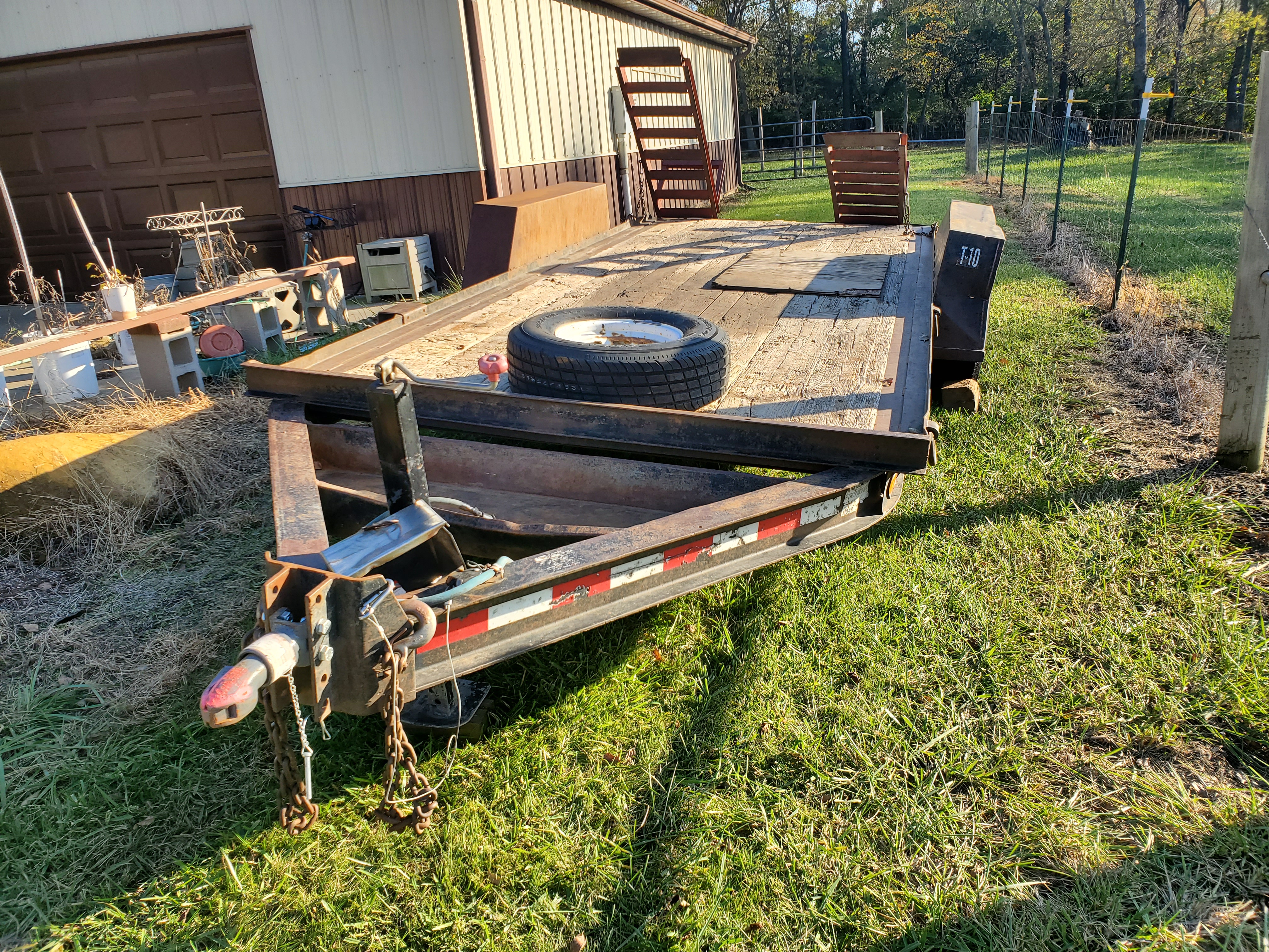

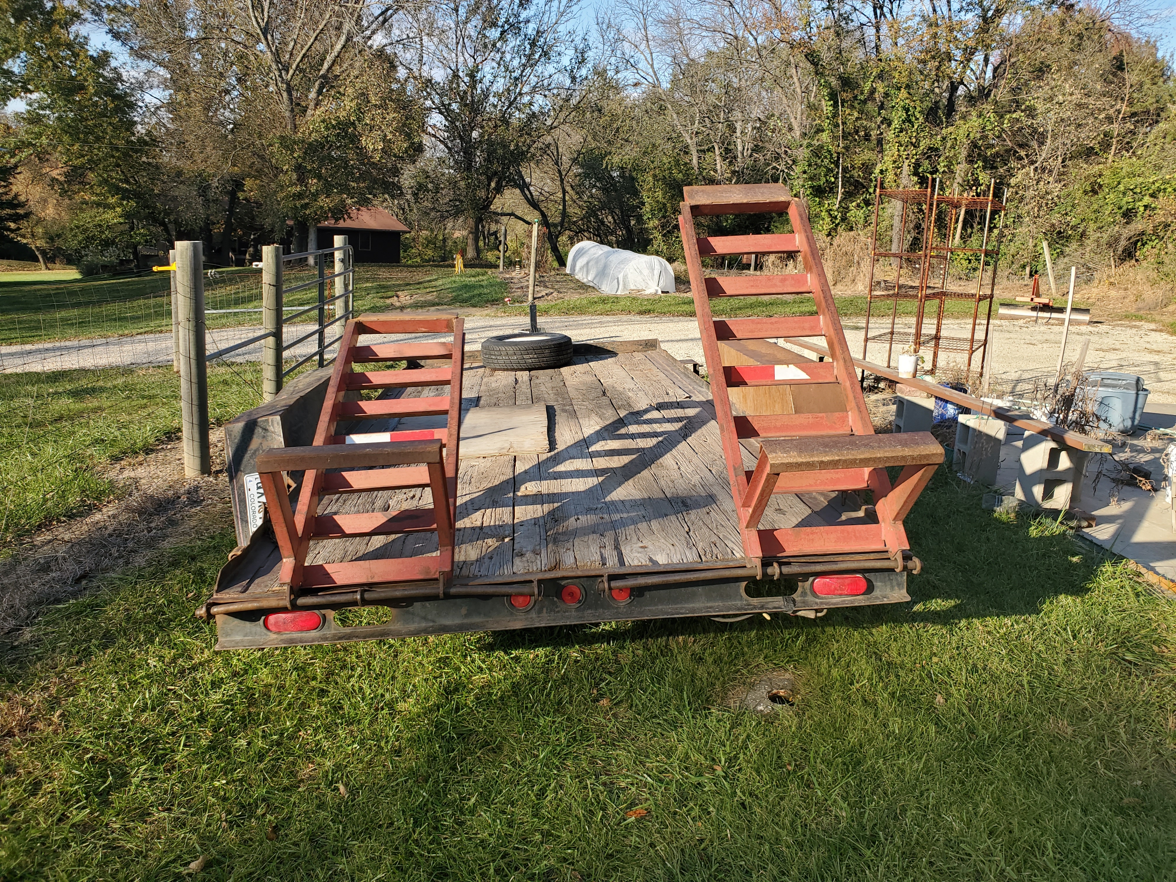

Was talkin' when I should have been listening.... Opened my mouth & bought myself a trailer.... 1997 T-10 Towmaster Nephew used it in his landscaping business.... I've hitch towed many campers/boats throughout my 65 years but have never owned an equipment trailer... This ol' girl has had some serious use & abuse but it won't see much use here... Bought it mostly for hauling my B3200 Kubota (and a host of equipment) to & from the dealer, etc...
I'll need to install a winch of some sort to trailer my tractor if it'd dead, so what type of winch should I buy? What about load binders & chains? I'll also need a 7 prong receptacle installed in my truck... Truck has a brake installed but I've never used it so I'm totally ignorant about it... What else am I overlooking?
OBTW... Paid $1750 for the ol' heap......

Nice trailer. I wouldn't worry about a winch yet. I bought a 10k HF winch 10 years ago for the same reason as you and never hooked it up and never missed it. Still piled in the corner. Get everything else figured out first.
I would get 5/16" chain for everything along with HF load binders to tie stuff down. Chain is cheap at HF. Looks like D rings are adequate. I would make sure wiring is good and tied up nice and then brakes work. Possibly I would remove and check all the hubs and brakes unless you know they are good. I bought a new GN trailer, used it for a cross country move, put 10k miles on it and brakes
were shot buy then. Trailer was only 3 months old.
Check the grease history and make sure hubs have adequate grease. Also check for tire wear and cuts and age. Tires are good for possibly 10 years at the most..
I don't know if your controller works or not adequately but new Tekonsha controllers work super.sh nicer than older style.
Others will add to this and it seems like a nice thread to learn from.

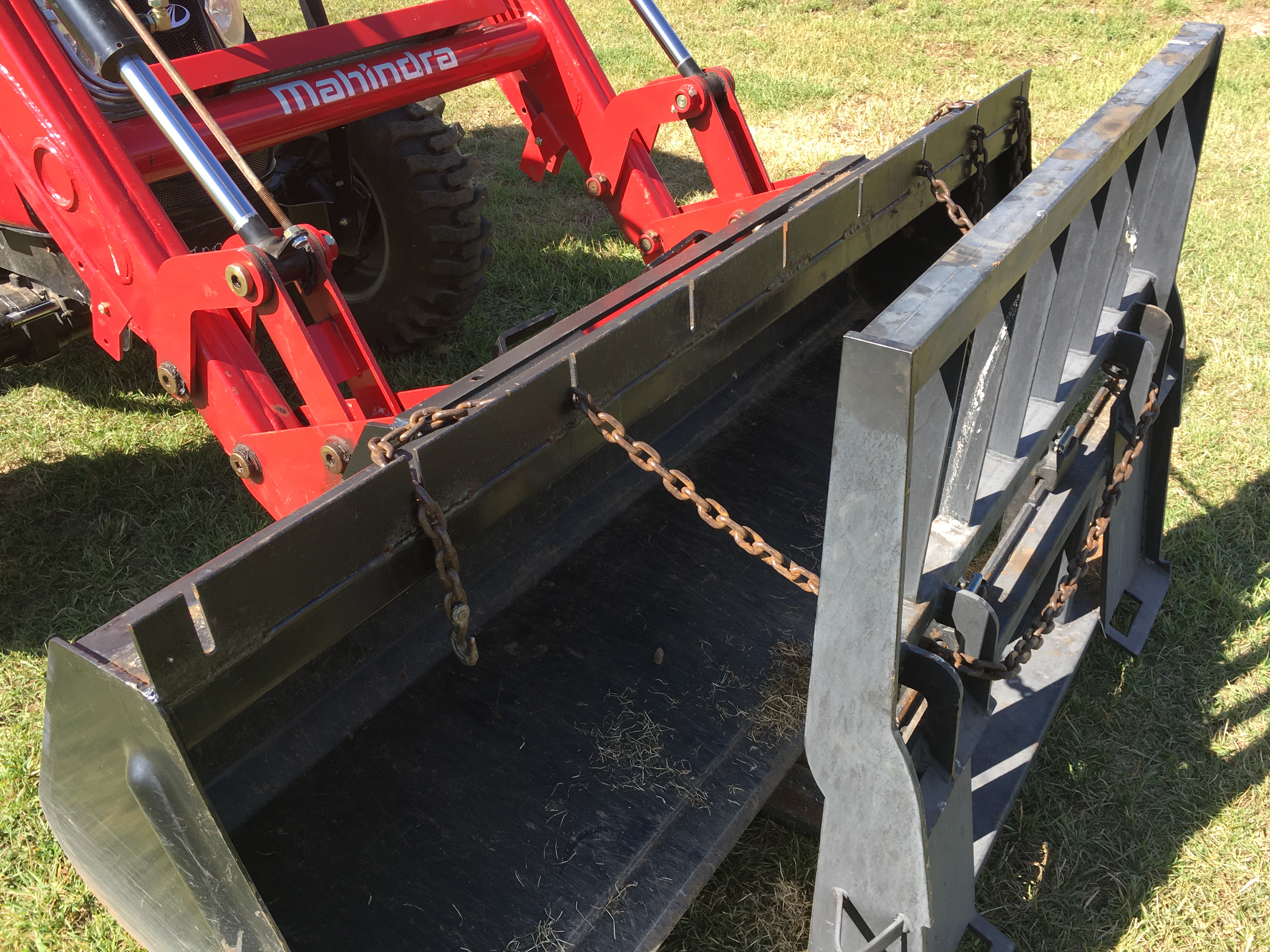

https://www.tractorbynet.com/forums/build-yourself/418641-receiver-style-trailer-winch-mount.html This link is from the build yourself forum and will show you how I mounted my winch.
You can do a permanent winch mount on the trailer or make it portable as I did, just depends on what you want to do and what your resources are. I know guys that have used 2500 lb to 5000 lb ATV winches on their trailers and they get by just fine. I choose a 9000 lb winch but I was winching heavy objects and wanted to limit the times I would have to 2 part the line. Or as suggested, you can use a come along.
In regards to chains, I prefer 5/16" grade 70 chains and matching binders. I cross chain the tractor with 4 10' chains and have 2 more 20 foot chains for implements. Plus I have 4 straps for appropriate stuff.
The nice thing about shorter chains is they are easier to work with. But, if needed you can just hook two of them together to get your 20 feet.

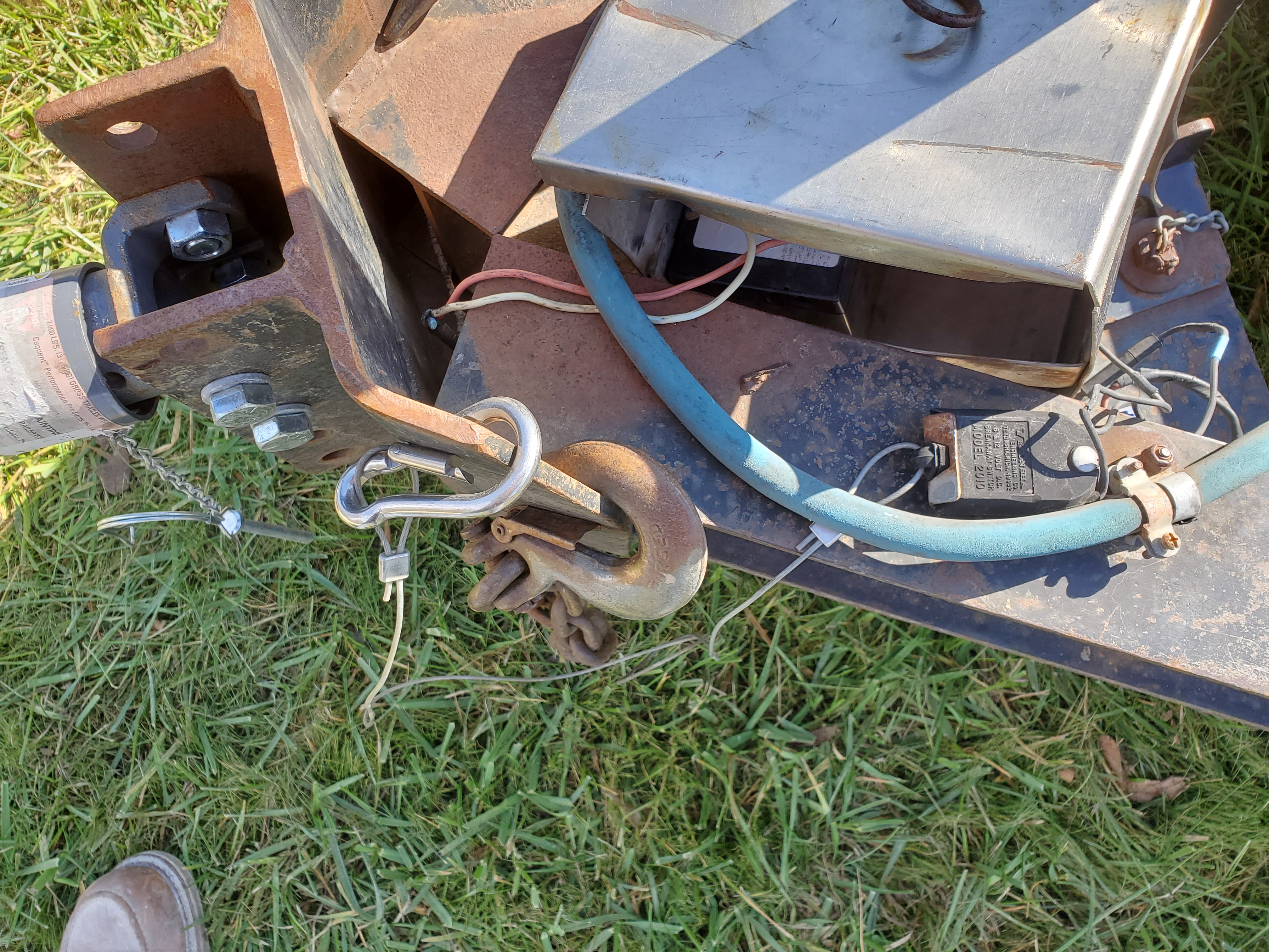

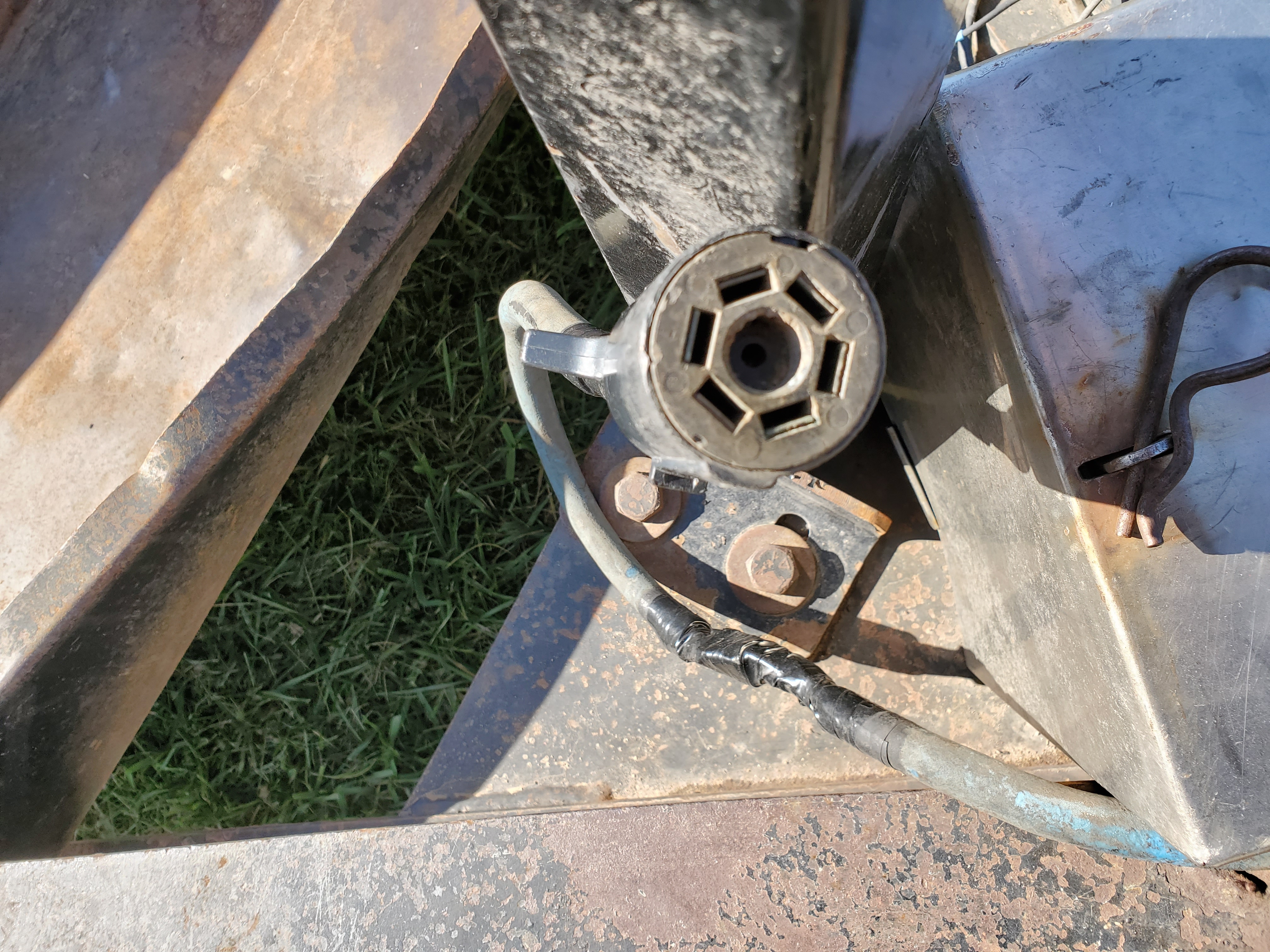

Number 4 pic above shows a missing dust cap on the front hub, and a dodgy one on the back, so I'd get a set of new caps, pull the affected (if not all) bearings and clean and repack, check the rear seal, etc. Way cheaper and more pleasant to do it now than along the road somewhere when the rain is lashing down.

What trailer wiring does your truck currently support? What is the truck?
What specifics do I need to order the correct new dust caps for this trailer?
Those look like Dexter EZ-Lube. Caps come with metal cap and rubber stopper.

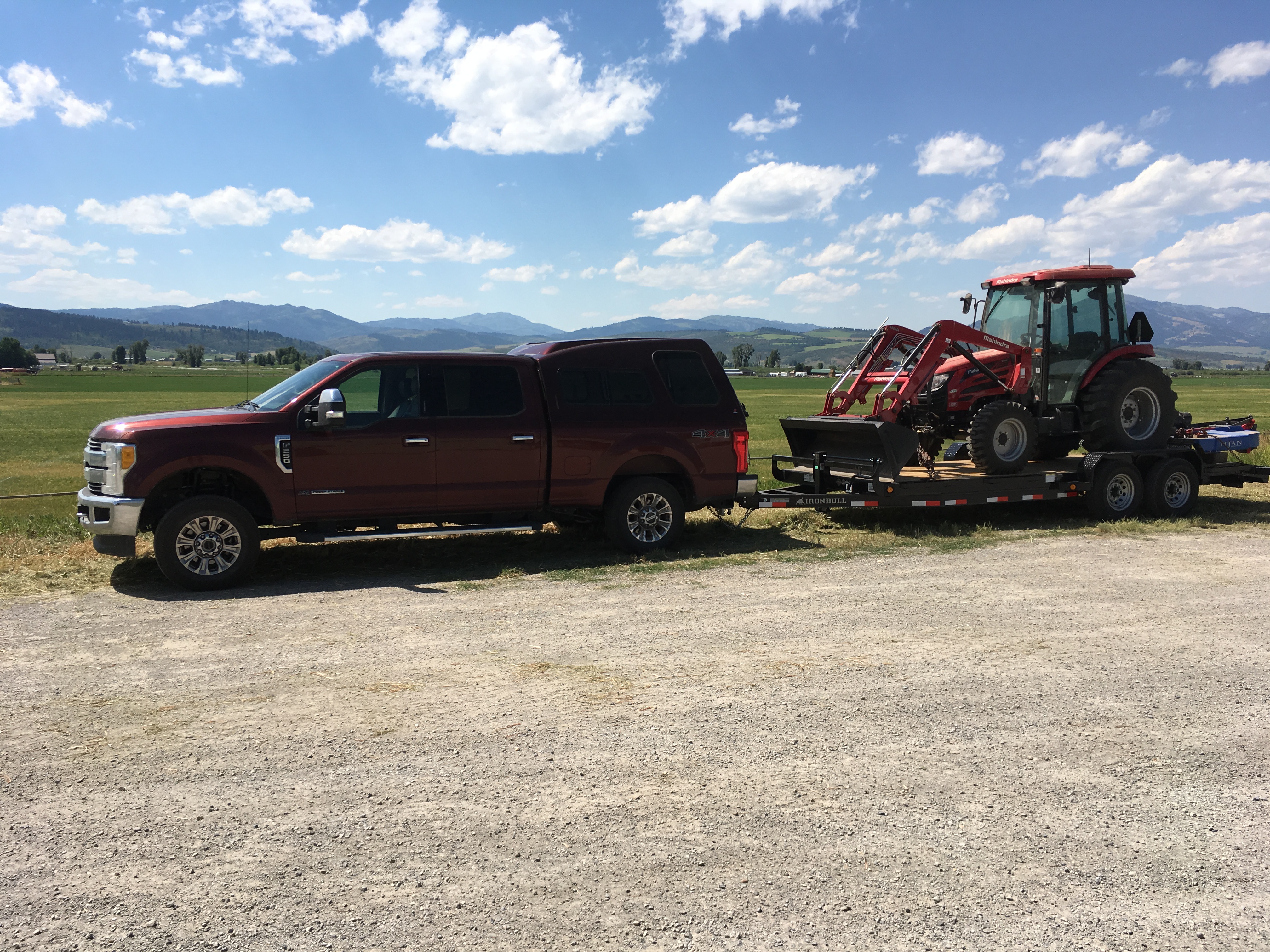

Here痴 my winch setup.
When brand new:
We keep tie downs in with the winch and battery.
To use, lift the winch out, slide into receiver, place pin. Use remote.

@Reb954, how do you like that Iron Bull trailer ?
I really like it. It is well built and handles a good load with ease. Before I bought it I had looked around at a lot of different trailers but couldn't find what I wanted. I had pretty much settled on a Walton trailer due to how well they are built, but I couldn't find one with a 20' deck and rated for 14k. One day I was traveling through Idaho and spotted a trailer sales place so I pulled in. They primarily sold PJ trailers but they didn't have one that was configured the way I wanted. I happened to see this one sitting off to the side so I asked the salesman about it. They had just gotten this one in and it was the first one they had gotten so he didn't know anything about it and stated they hadn't even put a price on it yet. I just told him to go figure out a price while I look it over. $4400 later it was mine and they threw in a spare tire.
Some of the features I liked was the heavy tongue jack that could be moved from the front of the deck to the front of the tongue so I had room to put my winch on it, the hitch is adjustable to level out the deck without having to use a drop hitch on the pickup, good wood on the deck and plenty of cross members, fenders are bolt on versus welded on just in case I need to remove them and the lights and wiring were done by someone that gave a crap by making sure all wiring was well protected and not run across sharp corners. I'm sure there were other things I liked but that is what comes to mind now.
