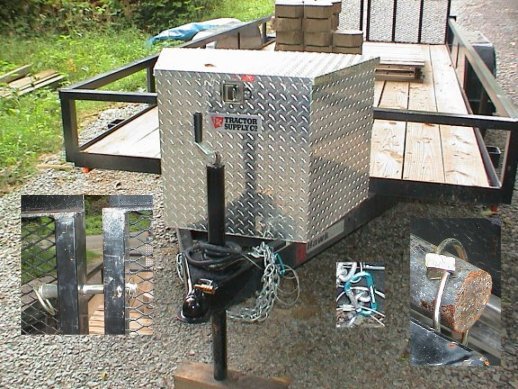

3. Tongue mounted, TAPERED, locking toolbox. If not tapered, turning clearance will be compromised. TSC for around $50 if I recall. One key in towing vehicle, one at home in the garage, just in case /forums/images/graemlins/ooo.gif

5. Buy a combination lock for the hitch. I bought one at Lowes with the right size "U" for the holes in the hitch. This will keep your trailer attached (read: not stolen when parked somewhere), and also lock it in place when the trailer is detached. This prevents anyone from backing into it and driving away with it- the ball won't seat /forums/images/graemlins/grin.gif Of course, someone can just cut it with bolt cutters, but that's a little obvious in the Walmart parking lot /forums/images/graemlins/mad.gif
6. I bought one of the Lowe's $0.96 brightly colored spring loaded snaps for connecting the breakaway cable to the vehicle hitch. Not sure what they are called, but looks like a light version of what rock climbers use for attaching onto their ropes. Smaller on one end with about a 1.5-2" springloaded "hinge" Somebody help me out here with the name /forums/images/graemlins/confused.gif

10. Between the split rear gates is a large pin that connects both when stowed in the upright position. This vibrates a lot. We cut about 2" of old rubber hose and put on this pin to act as a spacer to tighten this connection and cushion the vibration as well.

Here is the trailer tongue box I mentioned. BTW, forgot to mention: tarp. Always have one with you /forums/images/graemlins/cool.gif
Note the lock on the ball hitch and the snap clip I tried to describe. Also the insert with the rubber bushing on the pin between the ramps.
-JC

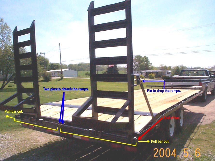

This is a picture of the removable ramp hinge pin. It makes it easy to remove one or both of the ramps to haul longer items.
I like having a "closed" back of the trailer and the side rails. Keeps things on trailer nicely, reducing the amount and complexity of tying down items.
And "no" I did not haul those blocks like they are without tying down. They are just leftovers from the wall and I haven't decided where to put them yet /forums/images/graemlins/smirk.gif
Hope this helps give you some ideas. Sometimes I really think things through too much, so it would be good if someone else can benefit from it. /forums/images/graemlins/grin.gif
