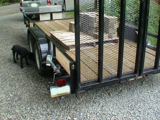

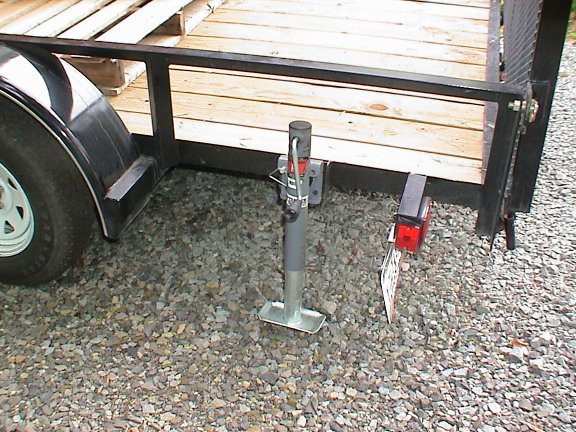

4. This is a biggie. I went to TSC and bought two side crank trailer jacks on pivots (you know, pull the spring loaded pin and flip them up) and welded one on each side between the rear wheel and fold up ramps. We flip these down and crank them a few cranks to prevent trailer tilt and excessive wear on your trailer ball lock from loading and unloading. I should take some pictures and post them. Maybe tomorrow.

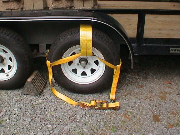

11. "Over the wheel" tie downs for hauling tractors. Wouldn't be without them. Also works great for hauling motors. Set the motor on an old tire on an old pallet and put the tie down over the motor. Holds it down and wraps around at the same time. I think around $20- $30 ea.

Oh, and don't forget to put the rear stabilizer jacks back up before pulling away /forums/images/graemlins/blush.gif (It was a good test for the welds, though /forums/images/graemlins/grin.gif )

Regarding putting jacks at the rear corners of your trailer.......
One thing I was worried about was having the MMM clear the rear deck as I drove on. I don't have jacks/stands at the rear, so when I drive on, the rear of the trailer squats at the Bota starts up the ramp. It lowers the rear of the trailer and increases the clearance of my MMM as I drive up. Also keeps the BB from digging into the asphalt!
Yes, the rear of my F150 goes up a few inches, but not off the ground or anything. Do I care, No. It's not that much and it sure aids loading......... Don't think it will wear anything prematurely either.
I do however, make sure the hitch is latched BEFORE I load/unload. If it came loose, now that would be a shocker.
My two cents: Save your money on extra jack stands for the rear........ My trailer came with a skid shoe jack stand in front. I added a roller jack stand to facilitate moving it. I left the skid shoe one on, so when I park it on a driveway, I use it and the trailer stays put.

<font color="blue"> "Over the wheel" tie downs for hauling tractors. Wouldn't be without them. </font>
Could you post a pic of these too (along with the rear jacks) when you get around to it? For some reason I can't picture what you are referring to...

Henro and all,
Here is a picture of the tire tie downs.
-JC

Here is a picture of the rear trailer jack.
-JC

Another trailer jack pic.
-JC
