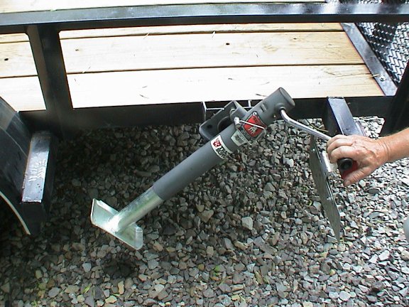

A pic showing how the jack tilts.

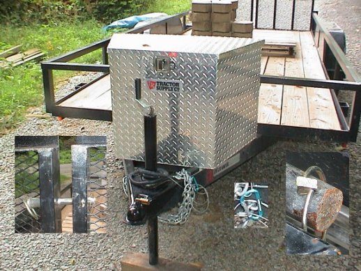

Here is the trailer tongue box I mentioned. BTW, forgot to mention: tarp. Always have one with you /forums/images/graemlins/cool.gif
Note the lock on the ball hitch and the snap clip I tried to describe. Also the insert with the rubber bushing on the pin between the ramps.

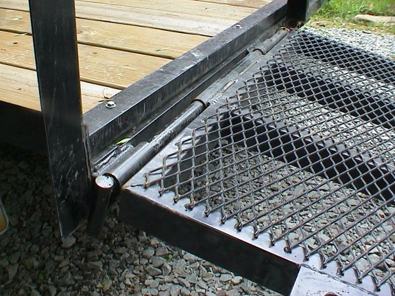

This is a picture of the removable ramp hinge pin. It makes it easy to remove one or both of the ramps to haul longer items.
I like having a "closed" back of the trailer and the side rails. Keeps things on trailer nicely, reducing the amount and complexity of tying down items.
And "no" I did not haul those blocks like they are without tying down. They are just leftovers from the wall and I haven't decided where to put them yet /forums/images/graemlins/smirk.gif
Hope this helps give you some ideas. Sometimes I really think things through too much, so it would be good if someone else can benefit from it. /forums/images/graemlins/grin.gif
