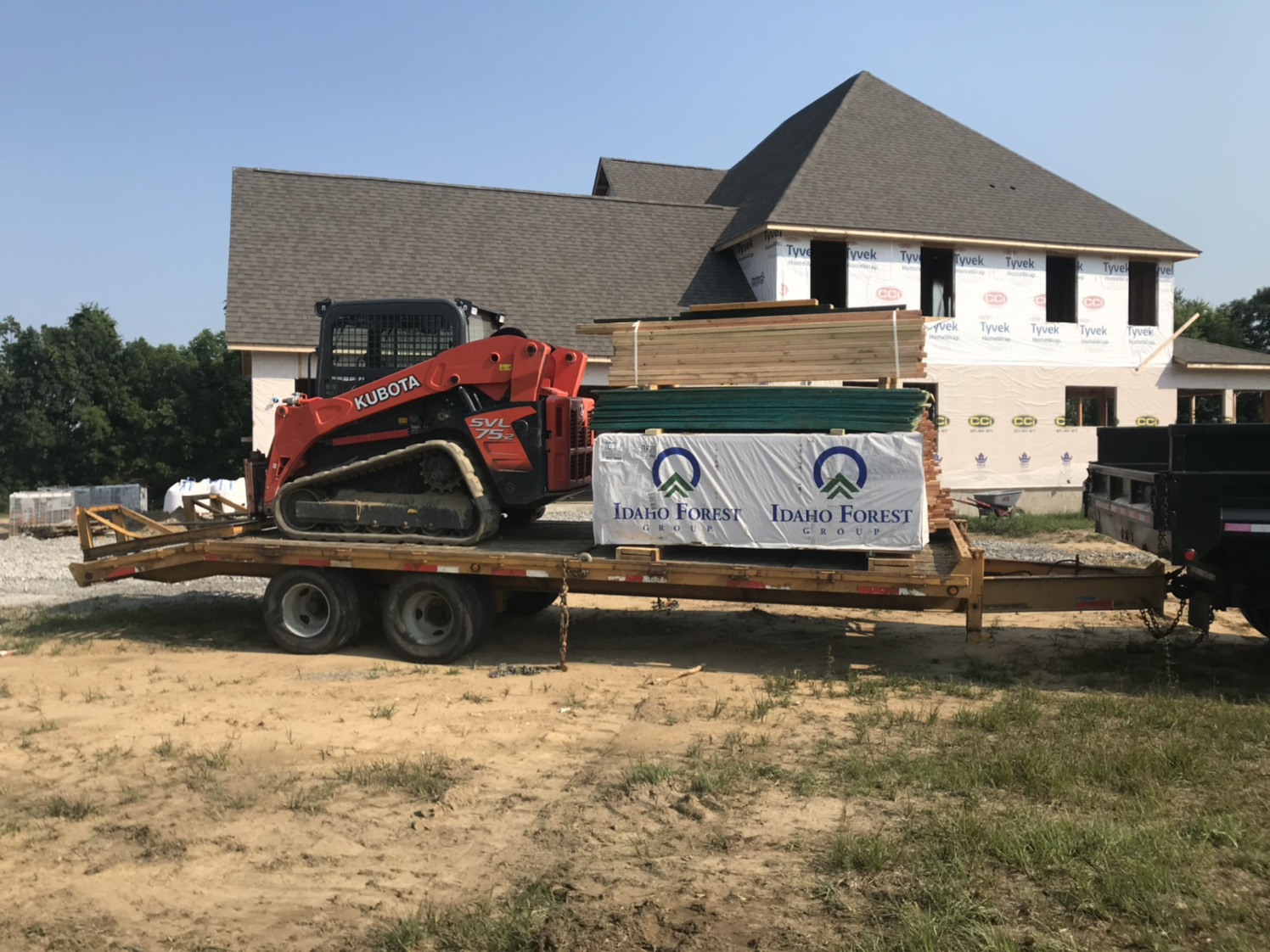

Most car trailer aren’t rated for the weight of a skid steer. A flat deck trailer is nice for side loading with a forklift but it’s also pretty tall for loading vehicles or a skid steer on the ramps. A equipment trailer with fenders and a dovetail gets my vote.

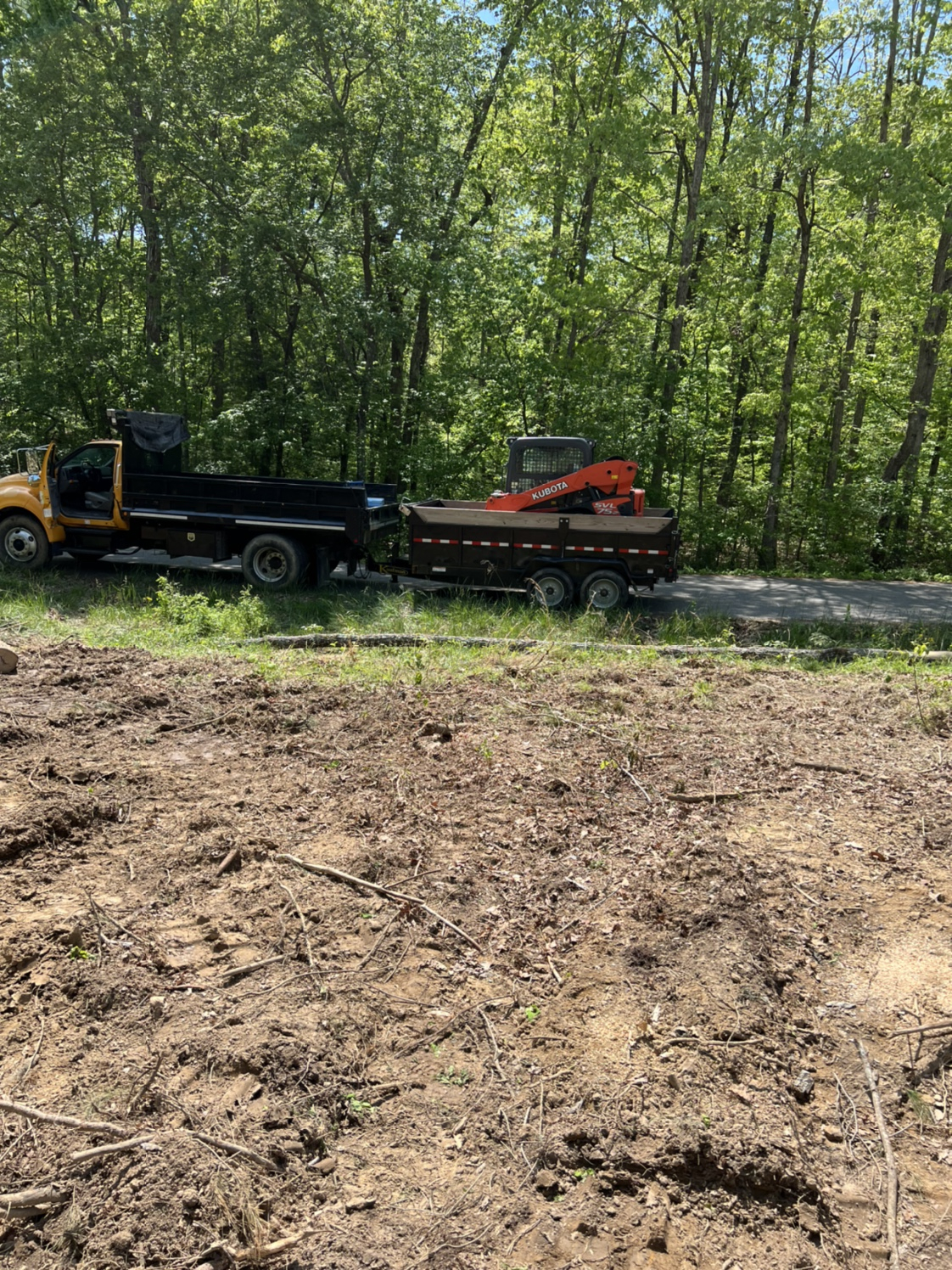

Is this for personal or commercial use? What will be your primary skid steer use? You might consider a dump trailer. A skid steer and dump trailer are like bread and butter.
I recommend a 14k minimum, no matter what style you get. A bumper pull is convenient to hook up and gets around better than a gooseneck. They do require more thought when placing your load, gooseneck is more forgiving here.
Dump trailer should be in the 14'-16' range and equipment hauler 20'-24'. If you need/want more than 14k gvw, I recommend gooseneck. I also prefer torsion axles. Again, I can't stress how handy a dump trailer is, especially if you only have one trailer.
Equipment hauler is 83"x24', 14k, Dump is 7'x16'x3', 22k.

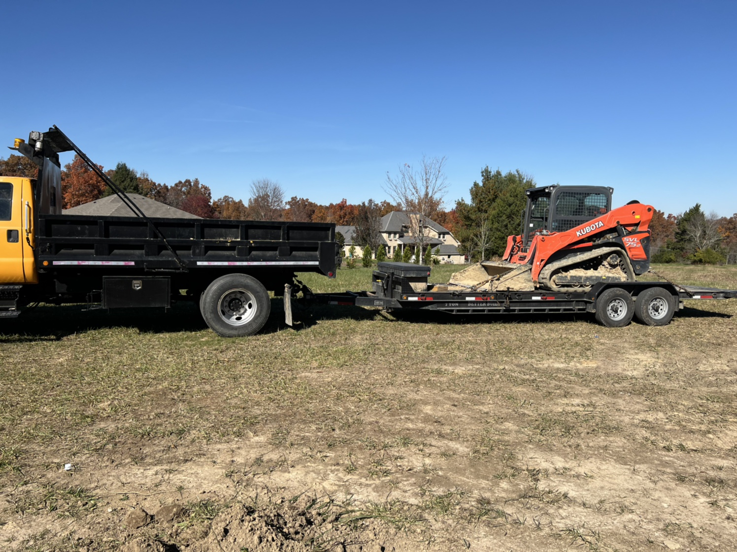

My vote is for a 14K equipment tilt trailer. The benefit of a tilt is A) only one angle needs to be traversed over instead of two making it much better for loading cars or equipment with low clearance, B) tilt trailers are less apt to drag their behinds on uneven ground because they don’t have the dovetail hanging down. Better if they need to be hauled through fields etc.
Recommend you get one with a winch plate or pop-up winch mount like on the new Diamond C’s for moving equipment that can’t move under its own power.

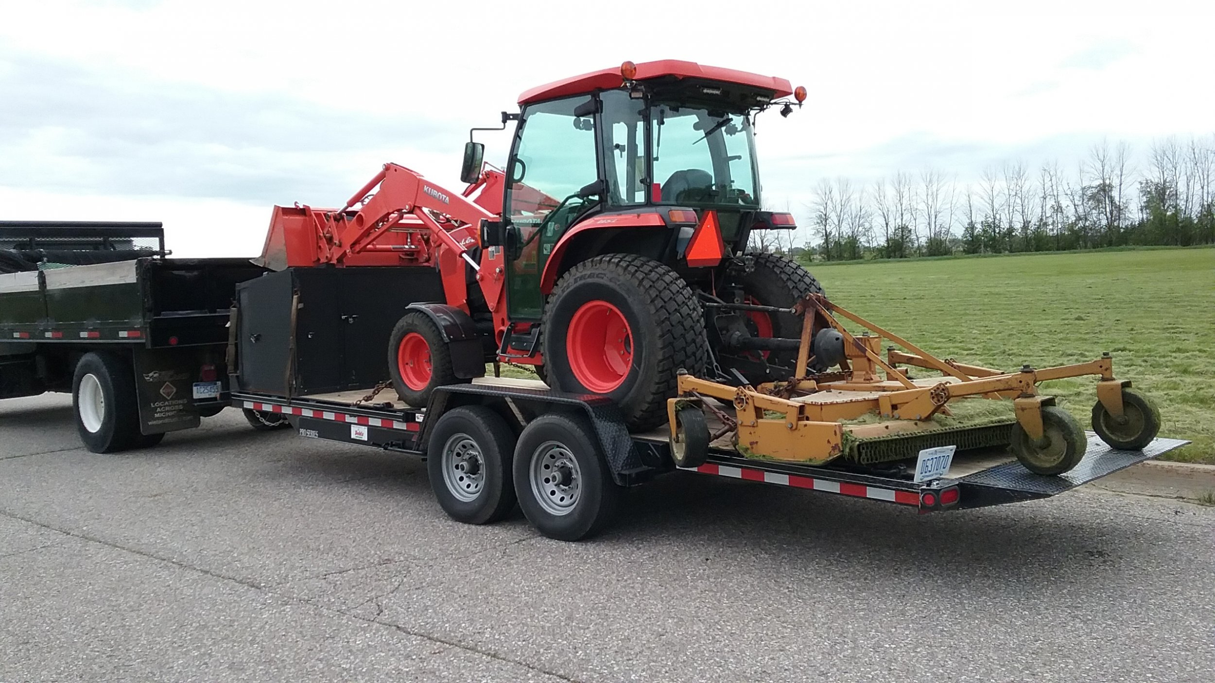

There are differences using a tilt bed. I never thought it was longer in the back end, especially in the 22' because the fixed bed is six' and 16' tilt. I think those that use the drop axles may have an appearance of being longer (because they run so low). Using the tilt is an option. If it loads hay or other things without the tilt, then it can remain locked just and any other flatbed. Those tilts with a locking cylinder can also be used to haul dirt or rock and unloaded with a tractor with loader. Just use the tractor bucket to drop the unlocked deck and lock the deck with the hydraulic locking cylinder, then drive up on the trailer using the bucked to unload. The deck will remain in tilt until you open the locking cylinder.
The main disadvantages would be --They cost more and they are heavier because they have two frames (one for the tile bed and then the main frame). My 20' 4' fixed and 16' tilt weigh about 3500#.
The advantages are the conveniences of not needing ramps and they are very low to the ground and tract VERY well and smooth. And you can use your tractor to unload if needed.
Tilt Bed Doolittle ezloader
I think a deck-over (pictured above) always has the least deck behind the axles.
