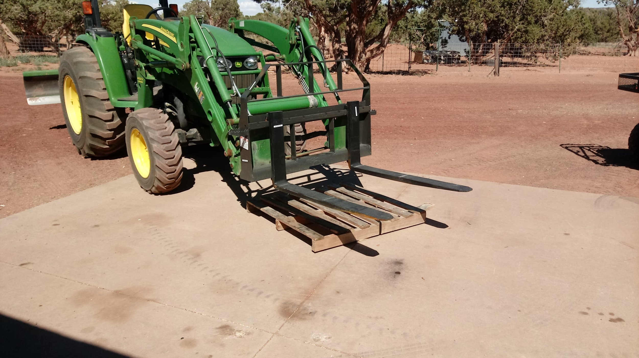

Do you find it difficult to see the tips of your forks at all? I bought a set (42") for my compact tractor, similar is size to yours but find I can't see squat until I get about 2' off the ground. I find myself not using them and always go get my Bobcat if I need forks.
@nisaacs ,. I took this picture from the seat with the forks slightly rolled back. The tips are slightly visible. With the forks flat and completely down I can’t see the tips.

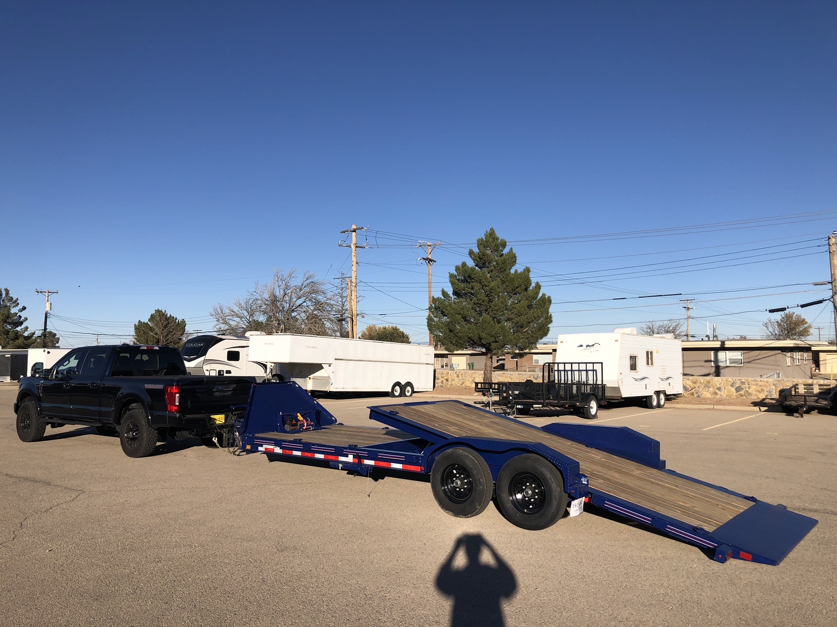

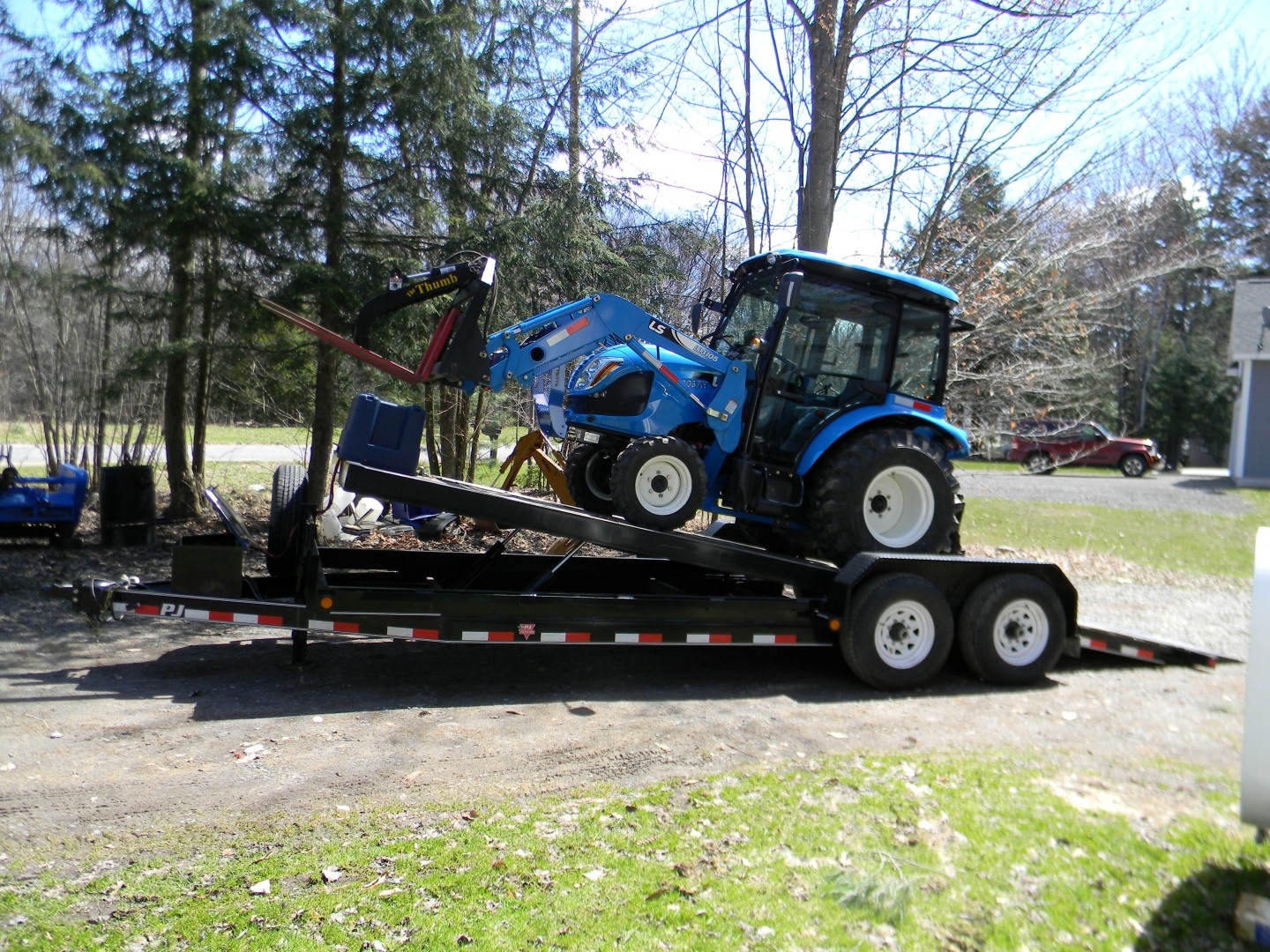

My tilt deck doesn’t lock up and it starts to go down before the back wheels hit the deck. If you drive on fast the damper cylinder will hold it up enough get the back axel on. If I absolutely had to solve that problem I could hold the deck up with a floor jack until the vehicle was loaded. I’m not in the business of hauling vehicles so that’s not proved to be a problem. A hydraulic tilt deck would solve most of those problems but my trailer is gravity. I actually like the gravity better. It’s a lot faster for routine loading of equipment and doesn’t require maintenance.
My tilt deck is gravity and has an inline valve to control down speed or hold deck up.
/ Trailer question - skid steer #57
I’ve used one in the past that was like that but mine doesn’t have a valve on it. It probably wouldn’t be a hard modification if that was an important detail.

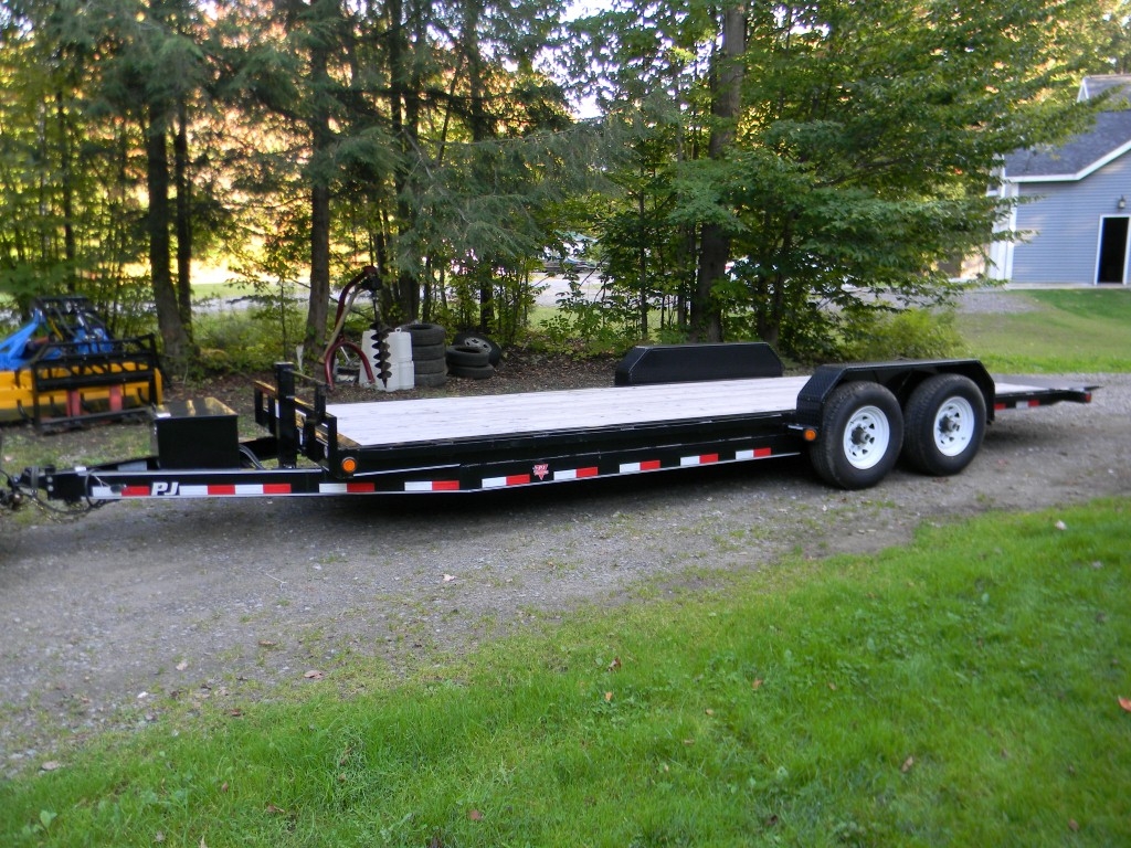

I can load 3 attachments on my tilt trailer maybe 4 depending on which ones. If you’re renting them it would be even less of a problem. Just load them sideways and set them off with your machine at home. I can stack my pallet forks or grapple or my stump bucket inside the regular bucket and set that on the front non tilting part of the trailer. Then drive on again leaving the 3rd attachment on the skid steer. I also drive a flatbed truck which reduces the issue. That’s basically adding another 8 ft of deck space. My zero turn would go up the trailer you pictured no problem. I had another equipment trailer in the past that didn’t have a dovetail and my zero turn couldn’t go up it. It would get stuck at the top. I can load my zero turn on my tilt deck no problem. The annoying thing is when my brother comes along to help with his zero turn. Maybe you could drive both mowers up at the same time without the deck going down. I’ve never actually tried that idea. Even if it did work it would still be annoying because both mowers don’t get parked at the same time. We have a car trailer with ramps that we use when we’re bringing 2 mowers. I could load a car on my tilt deck no problem. At least I think I could, I don’t have a car. Loading a 4 door pickup causes problems. My tilt deck doesn’t lock up and it starts to go down before the back wheels hit the deck. If you drive on fast the damper cylinder will hold it up enough get the back axel on. If I absolutely had to solve that problem I could hold the deck up with a floor jack until the vehicle was loaded. I’m not in the business of hauling vehicles so that’s not proved to be a problem. A hydraulic tilt deck would solve most of those problems but my trailer is gravity. I actually like the gravity better. It’s a lot faster for routine loading of equipment and doesn’t require maintenance. View attachment 854801
Nice setup.
How long is your trailer?
/ Trailer question - skid steer #59
Nice setup.
I think the tilt is 18ft and the flat is 6ft. I could probably get away with moving the toolbox to the neck with my current tow vehicle but my dump truck had a 2ft bed overhang and that wasn’t an option.

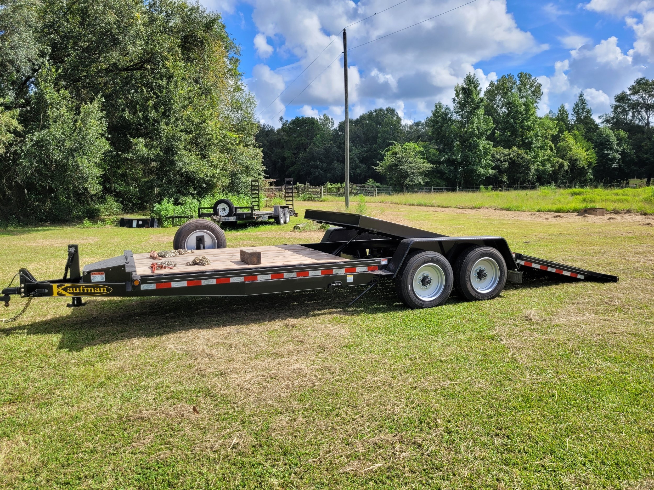

I think I am going to go with a kaufman trailer. Got it down to these two:
The extra 2k of weight is about $1200 extra. I am pulling it with a 3500, so I don't think that matters. However may downgrade to a 2500 someday.
I have a bobcat T595 that weighs about 8100 lbs.
Why can't I find the empty weight on these trailers to figure out the payload?
Also, any thoughts on slightly upgraded trailer... worth the extra cost even though I don't really need it?
Thanks
