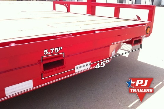

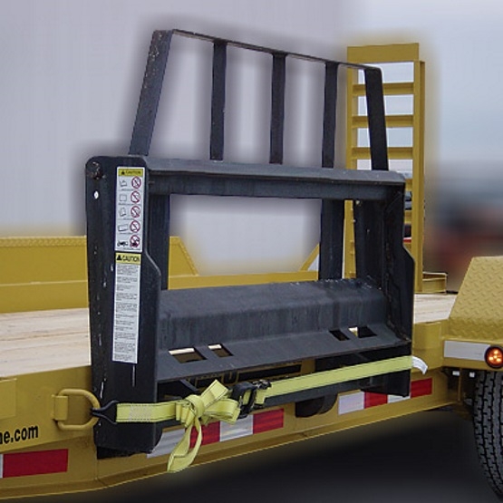

anyone have pictures of "fork pockets". Not sure what they are.
More pictures:

Thanks for your initial question in the trailer post series and the link from my question on what fork pockets are. I had never seen this option on a trailer. It is a great option that I will want to include on my implement trailer.
I learned something new today about a useful trailer option.
(thanks for helping me spend more money but it will be money well spent as I will not have o use space on the trailer deck for the pallet forks)
My contractor friend has fork pockets on at least one trailer of his. I just thought it was a handy and secure way of carrying the forks.
