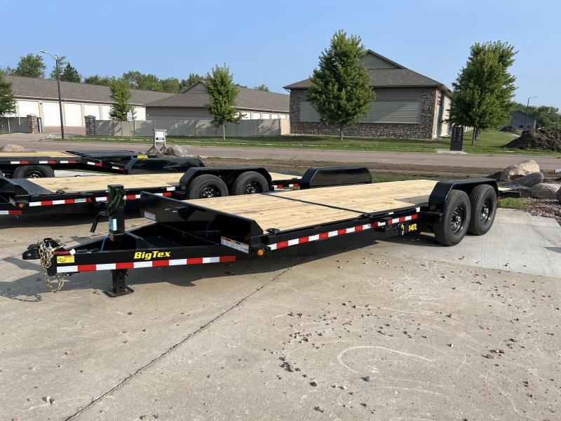

I ended up getting a bigtex 14TL-22 (14k 22ft tilt trailer, 16+6)
First trailer outside of RV's
First thing I am going to use it for is renting some skidsteer attachments. Can anyone give me a quick primer on securing these things? Recommendations on tie downs? Use fabric tie downs for these attachments? Brush cutter, grapple, etc... around 1000 - 2000 lbs

Did you get fork pockets?

Ratchet straps will chafe or cut if they rub on stuff. I cut one half way through early on cranking it down on a bar stock grill guard. It wasn't even sharp, but did damage to the strap. I generally use chain & binders for all my machines & implements now.
I still use straps for other stuff or machines if I can guarantee they won't hit anything but a smooth surface or won't rub anything.
