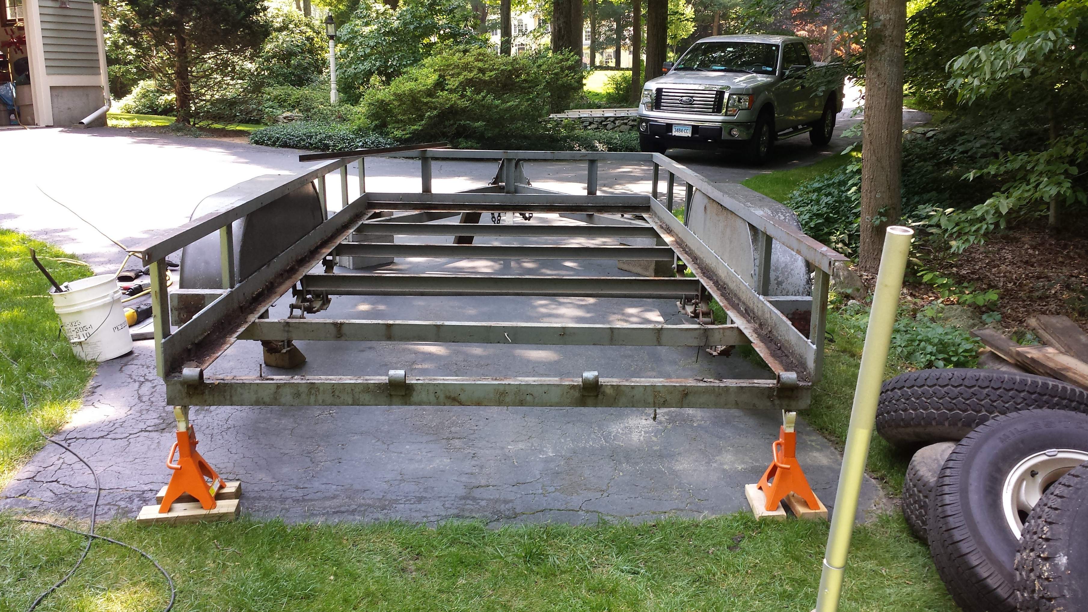

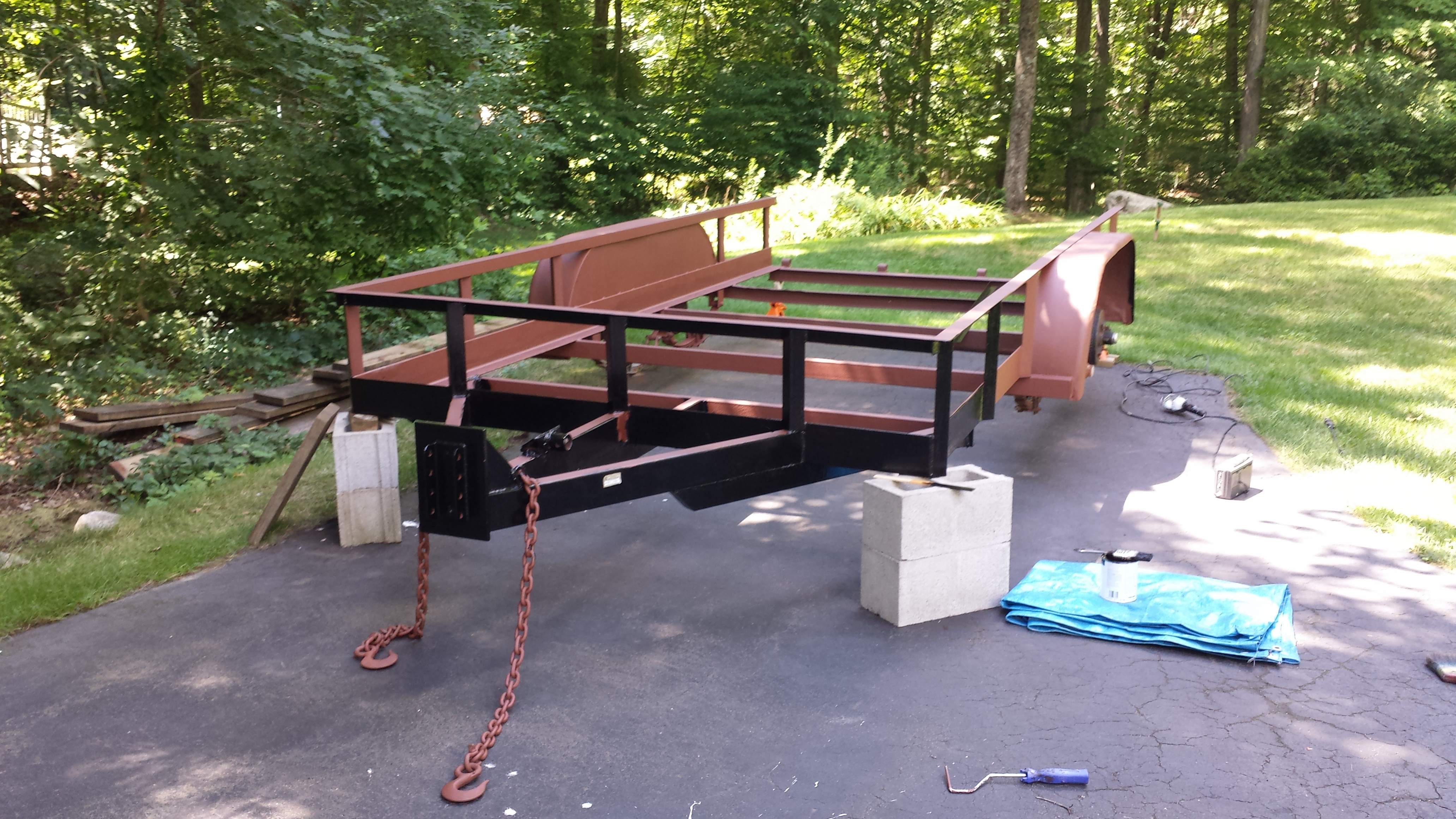

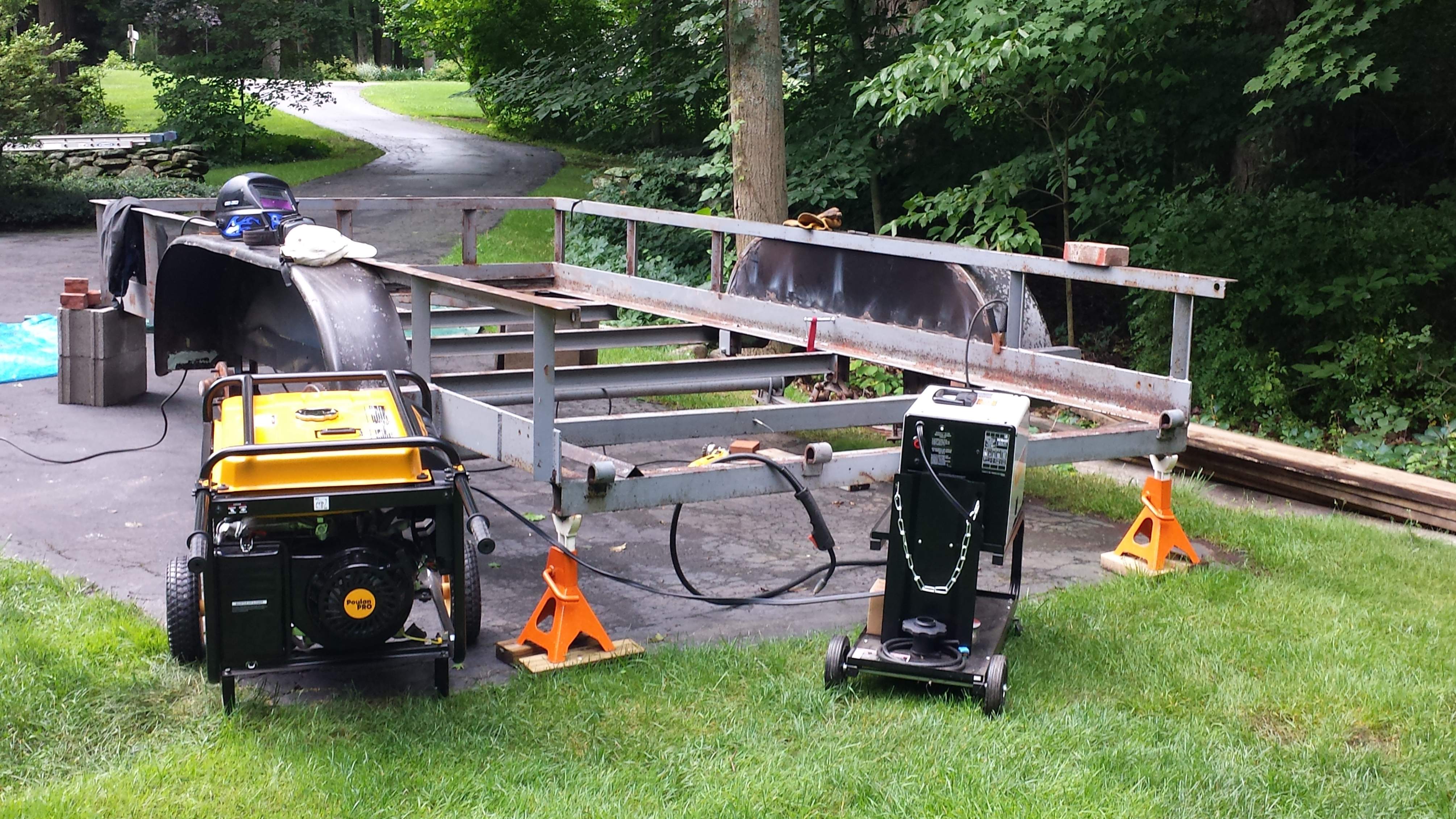

Then after about a week I thought, suck to have a trailer I don't trust to put my tractor on. I also hate junk, so began the end of my free time this summer. I started tearing it down to pieces, literally and rebuilt it from scratch. The only thing that stayed in tact was the front, but it got heavy modifications. As you can see I basically started from scratch. I pieced in a new side rails to where the bend started then also "sistered" another 3x5x.25 inch angle over top of where the axles are and over the weld joint to add strength. The pictures on the right are during during dissemble and the two on the left are the rebuild.
Great job on the rebuild!
