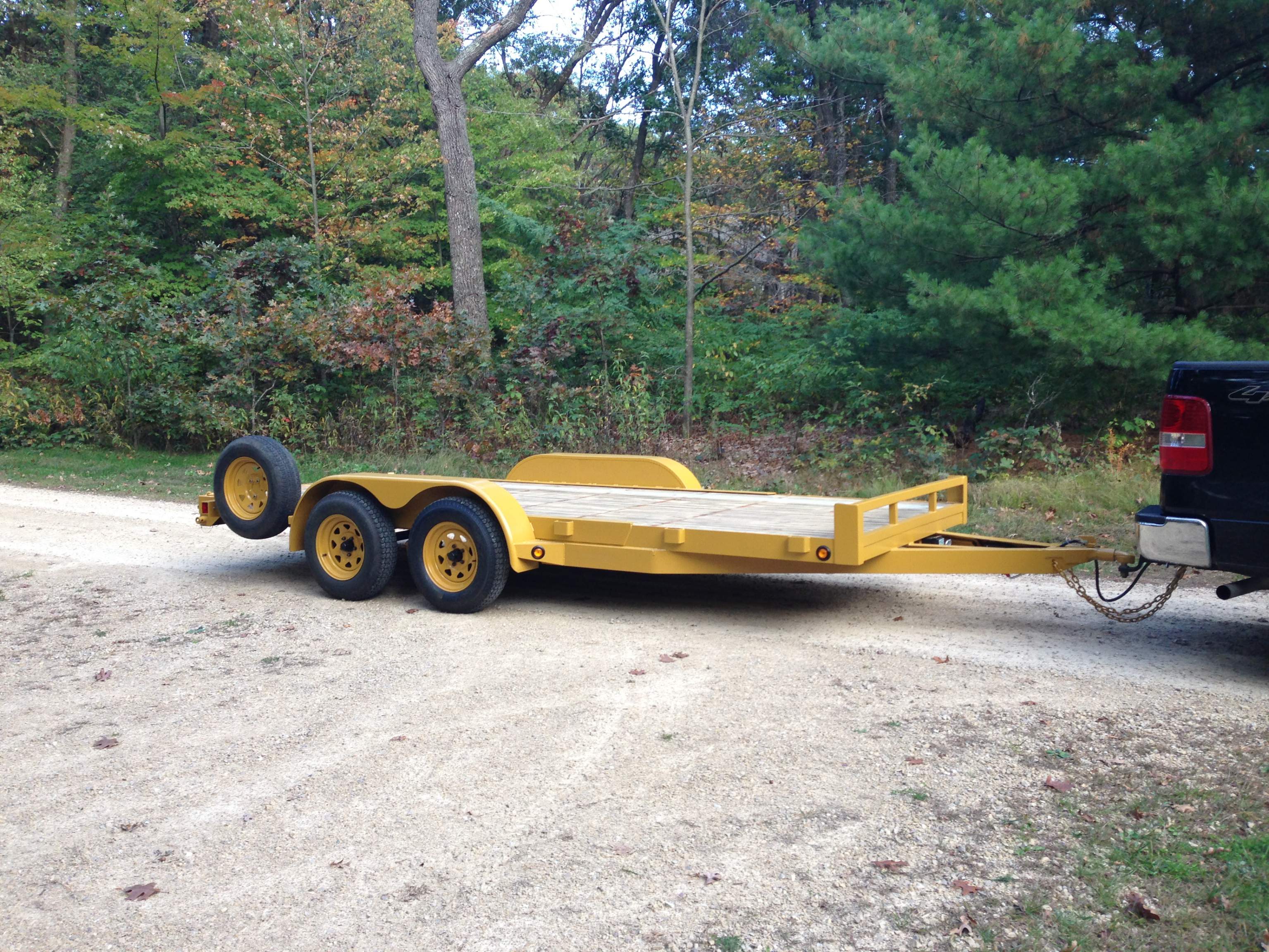

Then after about a week I thought, suck to have a trailer I don't trust to put my tractor on. I also hate junk, so began the end of my free time this summer. I started tearing it down to pieces, literally and rebuilt it from scratch. The only thing that stayed in tact was the front, but it got heavy modifications. As you can see I basically started from scratch. I pieced in a new side rails to where the bend started then also "sistered" another 3x5x.25 inch angle over top of where the axles are and over the weld joint to add strength. The pictures on the right are during during dissemble and the two on the left are the rebuild.
in the third picture, I noticed you shackles: 1 flipped up and 1 flipped down. I recently rebuilt all the suspension under my 2 axle trailer. Ever since I did, the shackles kept flipping to 1 up and 1 down. I most recently flipped them both to the up position and the trailer rides very low but seems to handle fine. My question is: should the shackles be up or down or what?
   / Trailer rebuild- a summer I will never get back. #43
Good eye, I missed that. They should both go up from the central equalizer to the springs.

Yep I figured out the shackle thing the other day. When I bought the trailer they were flipped but they are correct now. Found the easiest way to flip them was a little trial and error of driving either the front or the back tires up on blocks so the other axle was off the ground causing gravity to correct it.

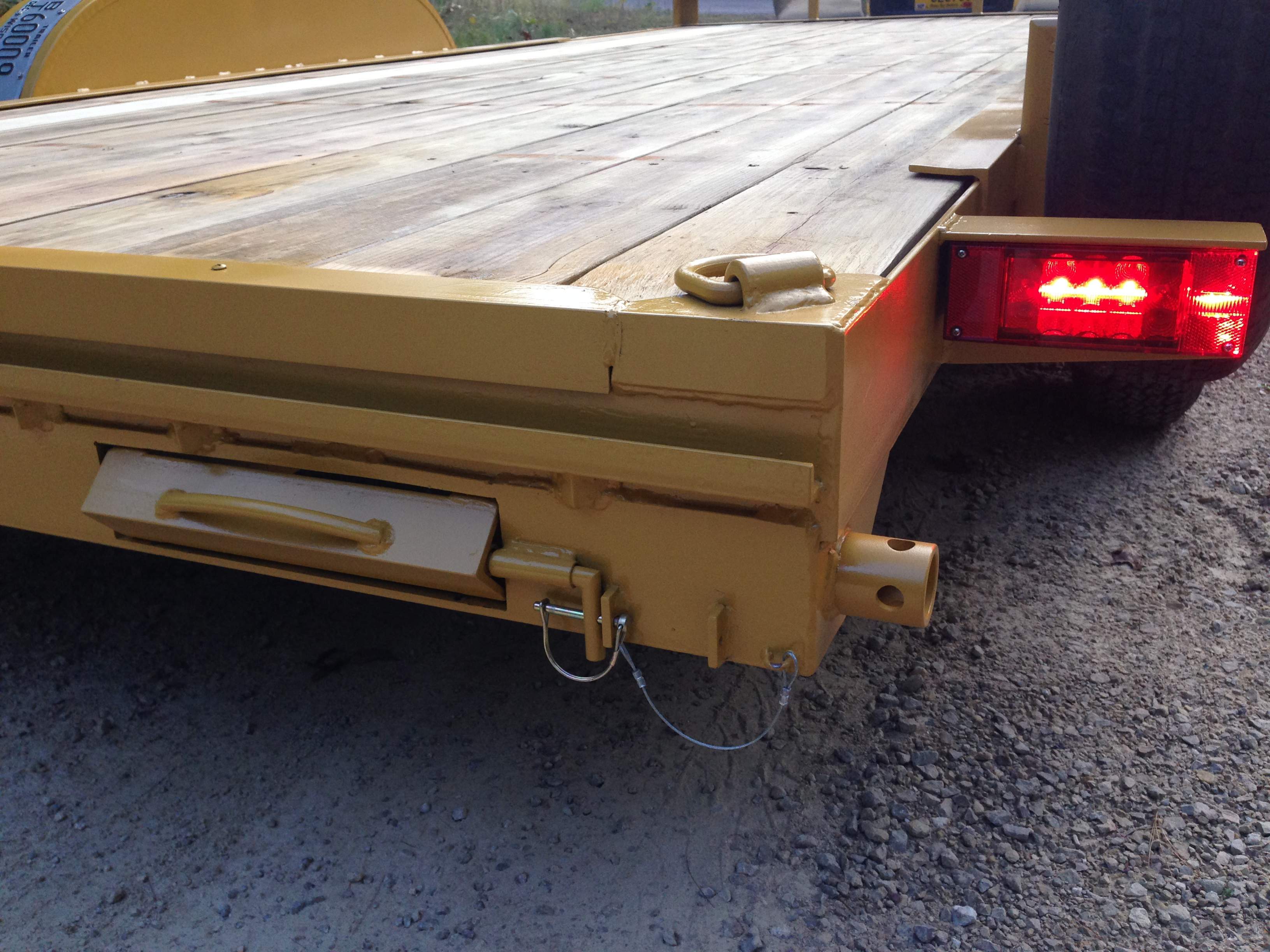

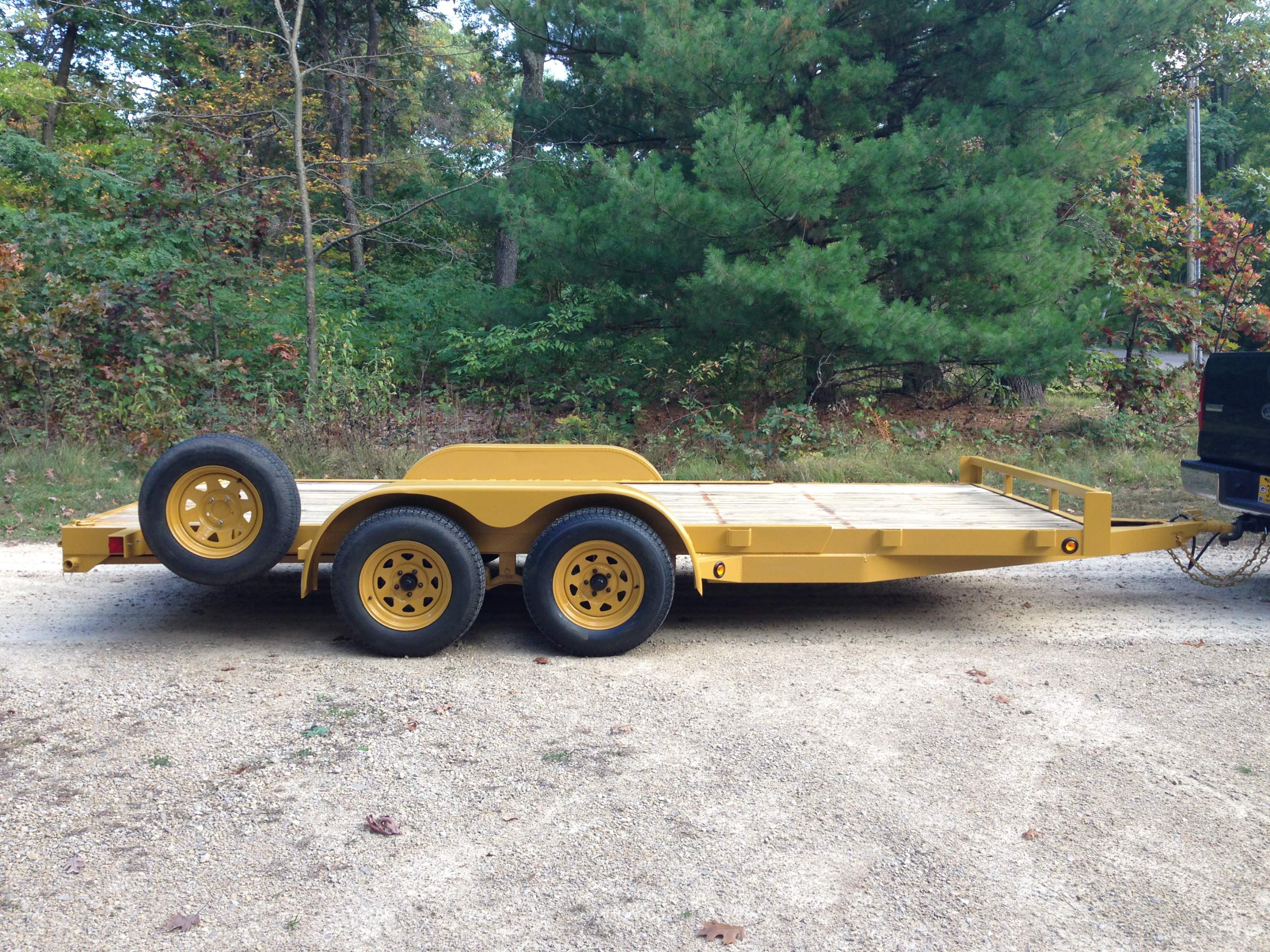

Gentlemen and the few ladies on this site, it is done, and here are the pics.
The pictures are a bit dark as the sun was going down

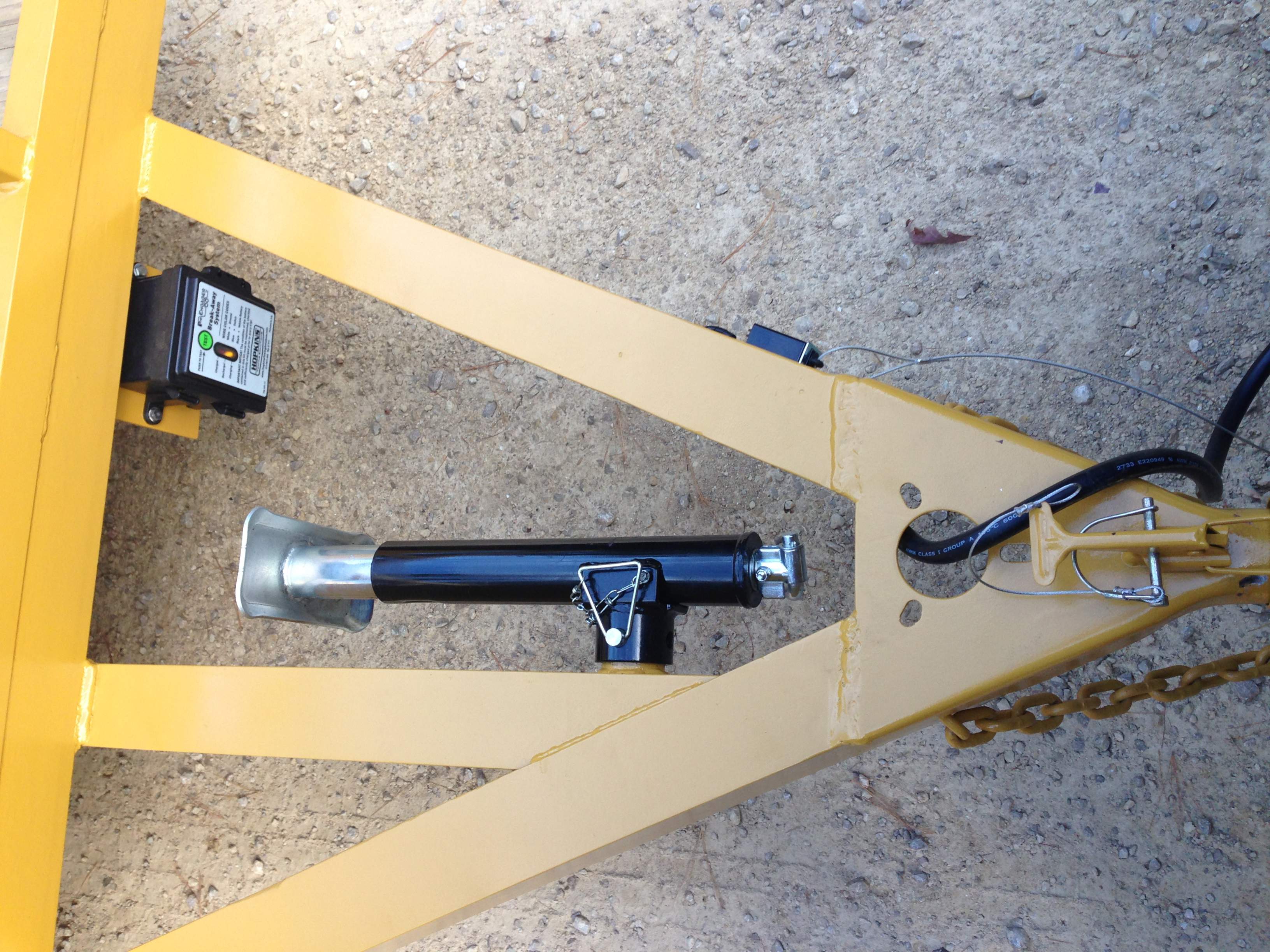

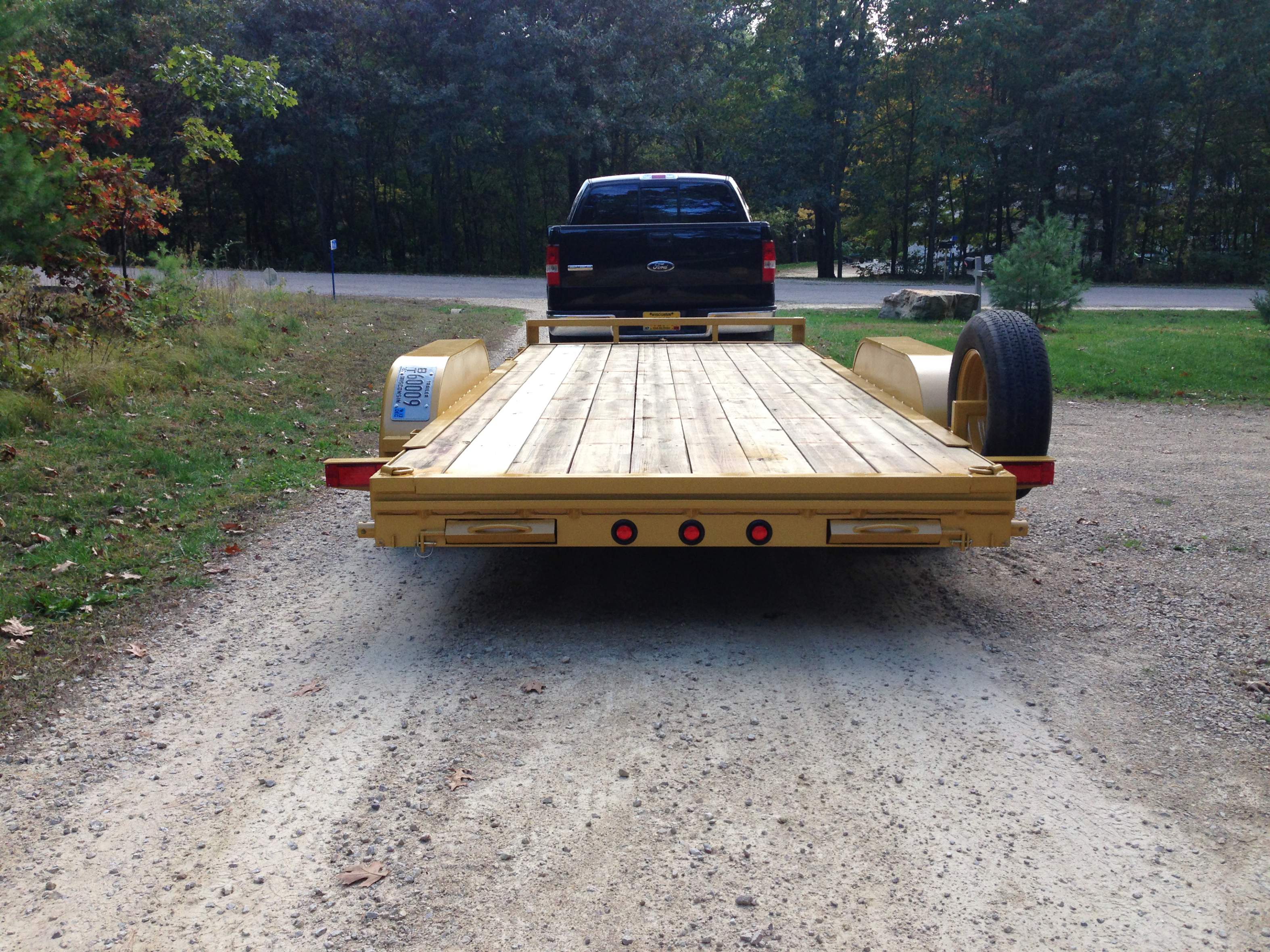

Here are some more pictures

Looks too nice to use..... I like the attention to detail with the little things like the lanyards securing all your pins to the trailer. I do the same on mine.
Chris

GREAT job!!!! :thumbsup:
   / Trailer rebuild- a summer I will never get back. #49
Very nice work!
   / Trailer rebuild- a summer I will never get back. #50
Well...
You just did it...
No way in hades I will ever show my rebuild after that job...
Great trailer and I really like the paint color...
