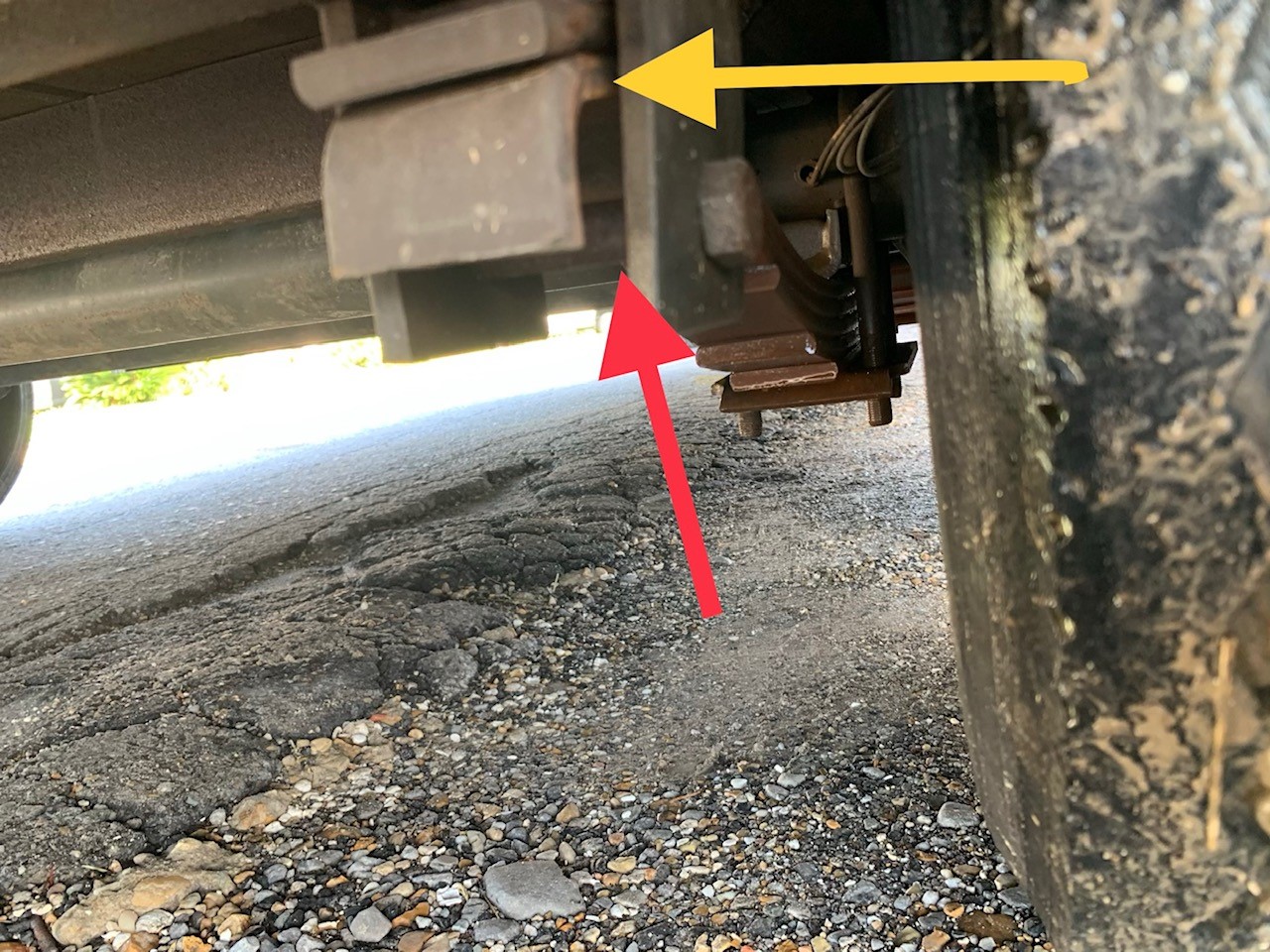

I had a similar issue on a 20' heavy duty bumper pull trailer. The dealer and I fought it for 2.5 years. We changed, rotated, and balanced tires several times and none of that solved the problem.
I was ready to trade the trailer, when my dealer called the factory to see if they could help. It turns out the bolt that the spring is supposed to rest on had been tightened too much and the spring could not rest on the bolt. After we opened up the shackle and allowed the spring to rest on the bolt, the bouncing went away.
In this picture taken before we opened up the shackle, you can see at the red arrow that the shackle is squeezed just a little and did not allow the spring to rest on the bolt.
Very interesting!
