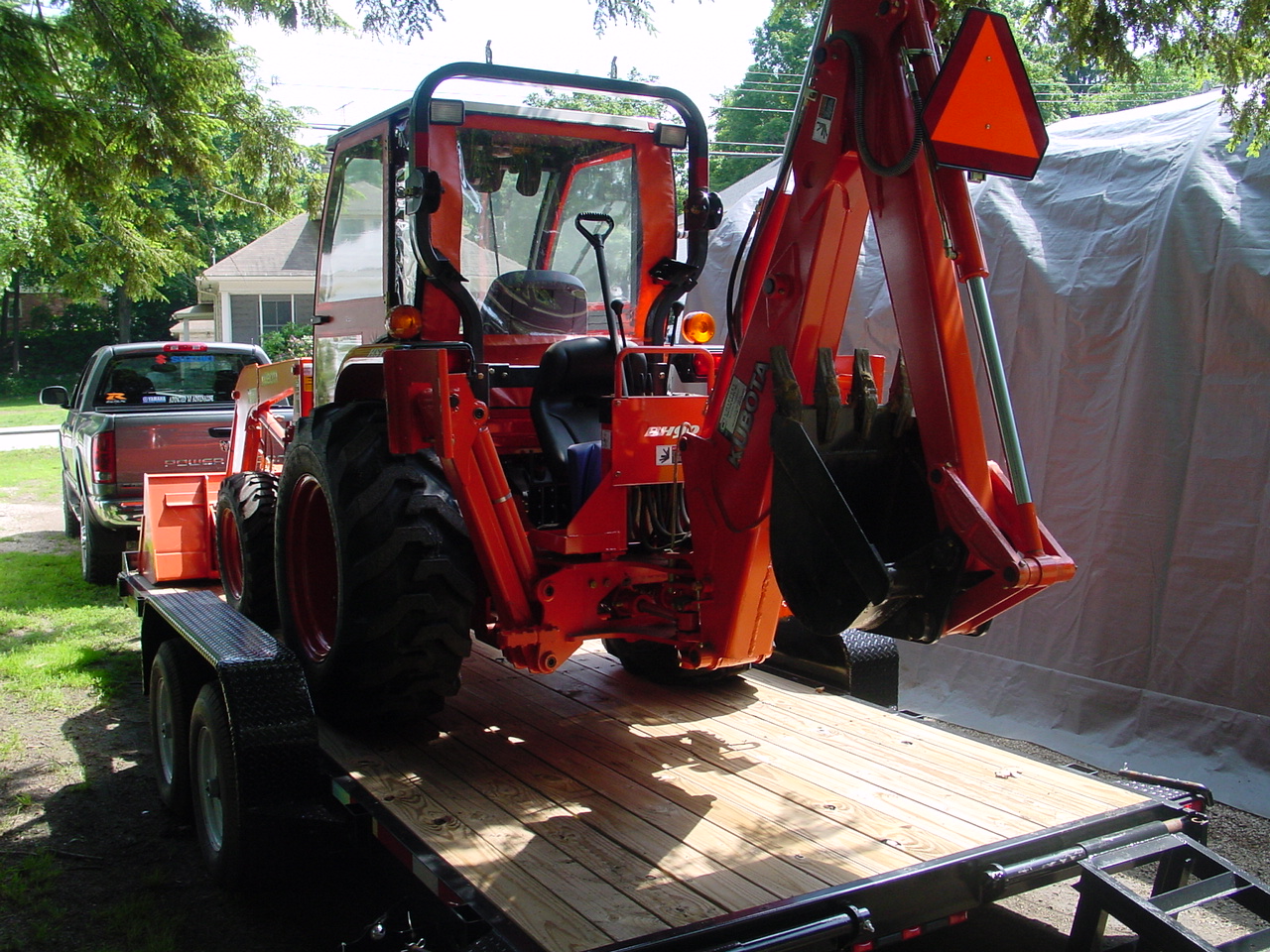

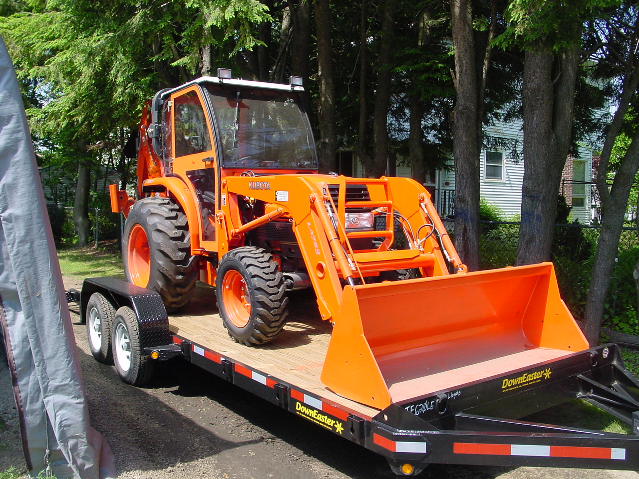

All he has in stock is a 20' 10000 GVW trailer. I figure that will be suffent. If the backhoe sticks out a little what can you do. When my tractor was delivered they used ratchet straps the big thick ones is that ok? I will only be transporting the machine about 20 miles or so. I just plan to groom a MX track. I may not even have a the hoe on it. As I plan to use a rear blade to smooth out the grooves. One other thing guys is a 84" rear blade ok for the 3130? My bota dealer said it will work excellent and did not reccomend getting a smaller blade what do you think?

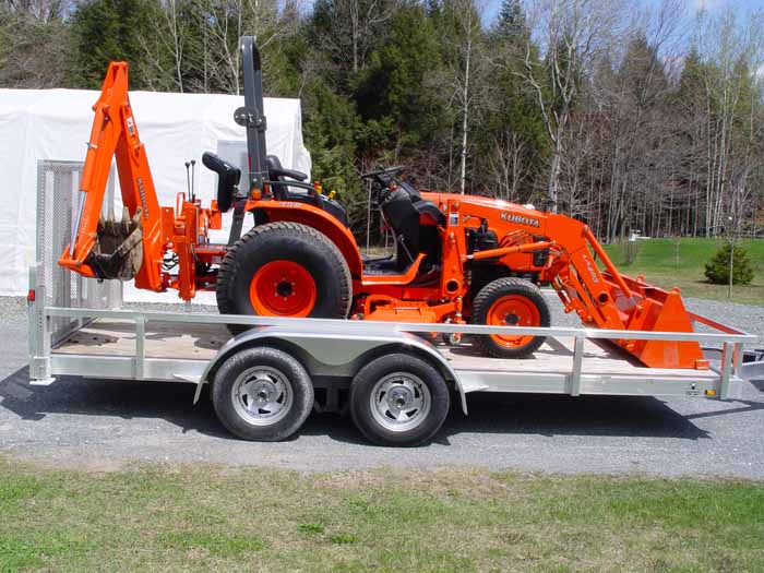

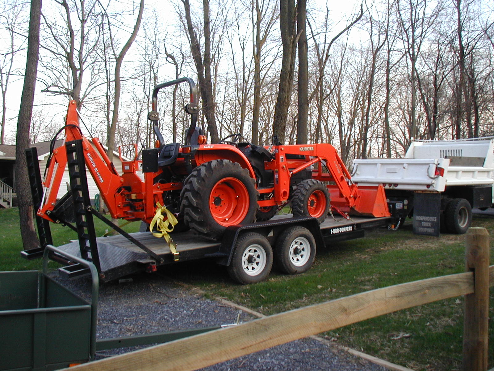

My B3030 TLB was tight on a 16' trailer :( . The best for a B3030 TLB would be 20'. So imagine a L3130 TLB. IMHO 20' should be the minimum.
   / Trailer size for a L3130 with backhoe #14
OK, I found the way to add pictures (I was restricted about the size). There is a 16' aluminum trailer and the other one is a 20' steel. Same tractor B3030 TLB.

I got the 20' trailer. It fits perfect even with the backhoe on it. It may have a slight over hang, But nothing to worry about.

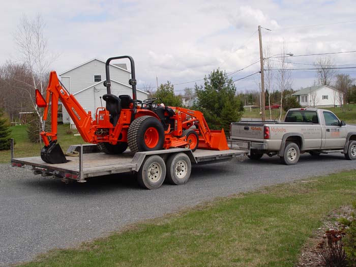

Heres my 3130 with loader and BL4690 on a 10000lbs 18ft trailer.

Sorry, I gave bad info on my trailer. It had 18' deck + 2' tail.
