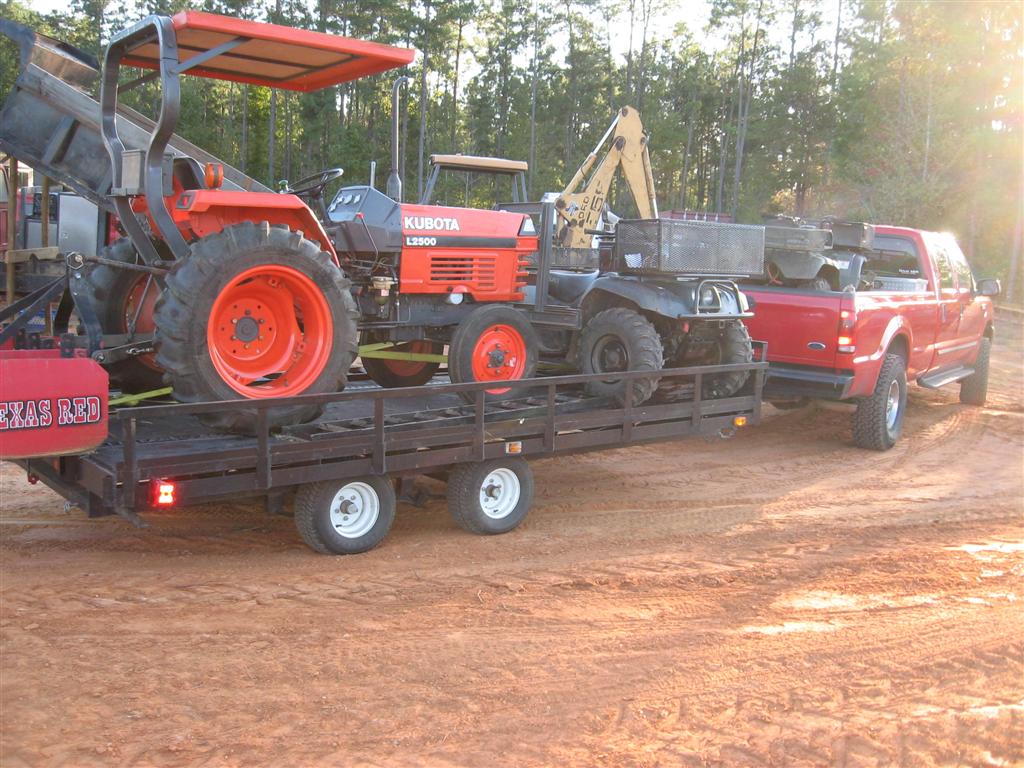

I think there are a couple more questions to ask...1)just how good is the deal on the 14' trailer, and 2) how much do you actually trailer the tractor.
I tow mine maybe twice a year. I built my 14' knowing I would have some things hanging off the back. But if I made it 16' or 18' all it would mean is the cost would have gone up and the tail wheel of the RC would be on the trailer. Not worth it IMO. If I had a FEL, I would do like 99% of the other folks in Texas do, lift it up and keep it above the pickup bed and move the tractor forward more if needed. The deck on my trailer is also 7.5 wide so I have some extra room up top.
Rob
