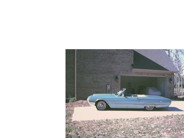

<font color=blue>Jeff, tell ya what. For $10,000 I will drive down, pick the T-bird up and drive it back to my place. This will let you forget all about this trailering stuff. No more worrying. No anxious trip and 10 grand too. Whaddaya think?</font color=blue>
That offer is acceptable with the one minor change I have made. Let me know!/w3tcompact/icons/smile.gif

<font color=blue>Anyways, good riddens to Corvettedom. I'm glad I experienced it but I wouldn't do it again.</font color=blue>
Why? (just curious)
BTW, your counter offer of $10K for the T-Bird almost tempted me! If it was 12 - 18 months from now, when the tractor is almost paid off....
