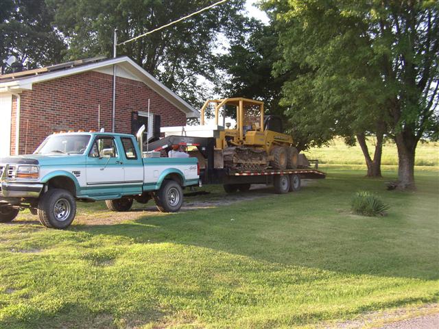

Here's a pic of my 20' gooseneck w/ 4" dovetail slightly overloaded. One thing to consider with a gooseneck you can get by with a shorter trailer by setting the FEL bucket up on the neck. I also have a 14' gooseneck dump and just bought some 90" aluminum ramps to load my tractor on this one. I'll try to post a pic of it later.
Kent

Slightly overloaded eh..... I am guessing 21000 lbs of equipment there on a 2000 lb trailer.
   / Trailer Troubles / Decisions #49
not quite. dozer 8500#, skid steer 6500# 14000# gvwr on the trailer and it weighs about 5000#
   / Trailer Troubles / Decisions #50
</font><font color="blue" class="small">( not quite. dozer 8500#, skid steer 6500# 14000# gvwr on the trailer and it weighs about 5000# )</font>
Only 6000lbs and about 7000 over on the trucks GCWR, I would imagine you drive very carefully with this load.
I know what 22,000 feels like behind my 3500 and it ain't fun.
