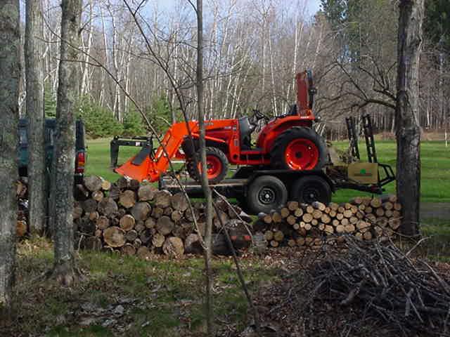

another one.
penokee /forums/images/graemlins/smile.gif

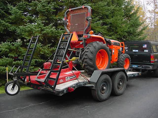

last one.
   / Trailer Troubles / Decisions #33
With that setup and my luck, I would have teeth marks on the tailgate before I got out of the driveway! /forums/images/graemlins/wink.gif
Jeff
