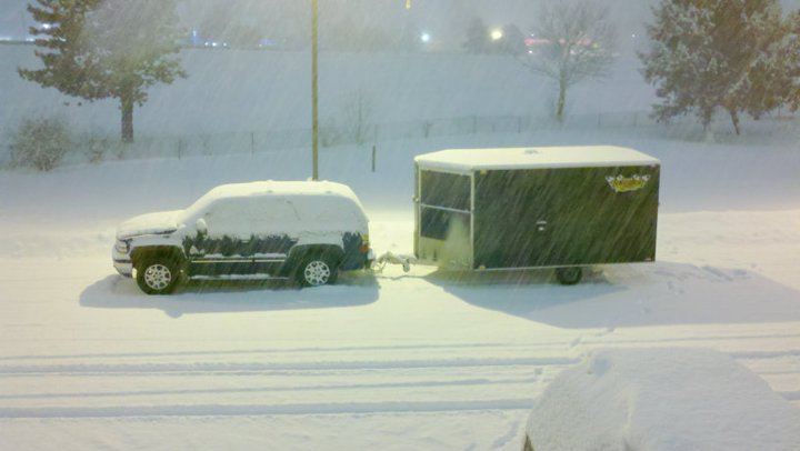

I spent almost 10 years towing this every weekend of the winter, without brakes. Not saying it was right, but the fact that 80% of my driving was on snow made me always think and plan. (Amazing how many times a 4x4 blasts by you on the expressway not realizing they are on ice and couldn't stop or turn if they tried)
Next trailer had brakes, man are they nice!
