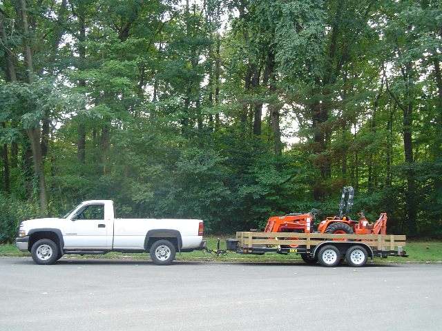

I have a big tex ch60. 7000lb gvw 16' deck that I pull with my chevy 2500hd. I put the tooth bar all the way to the front and set the backhoe down on the deck swung off to the side a bit. It rides great. It has brakes on both axles. I had a 1/2 ton before but a v6 wasn't enough motor. Rode fine with that truck except for power. I think it was $1800. I know it's a bit high, but I live in the northeast where everything costs more.
