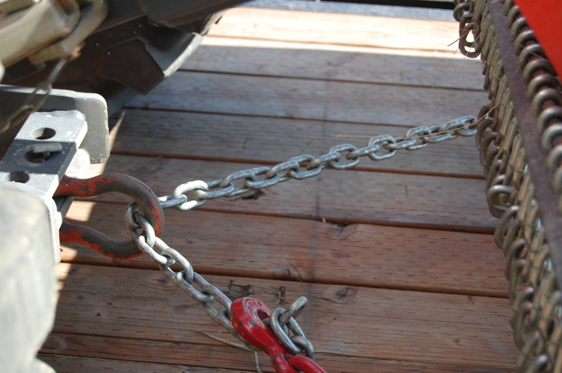

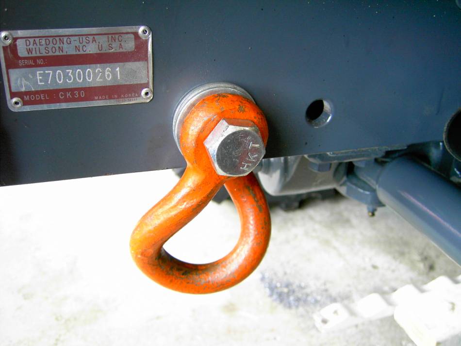

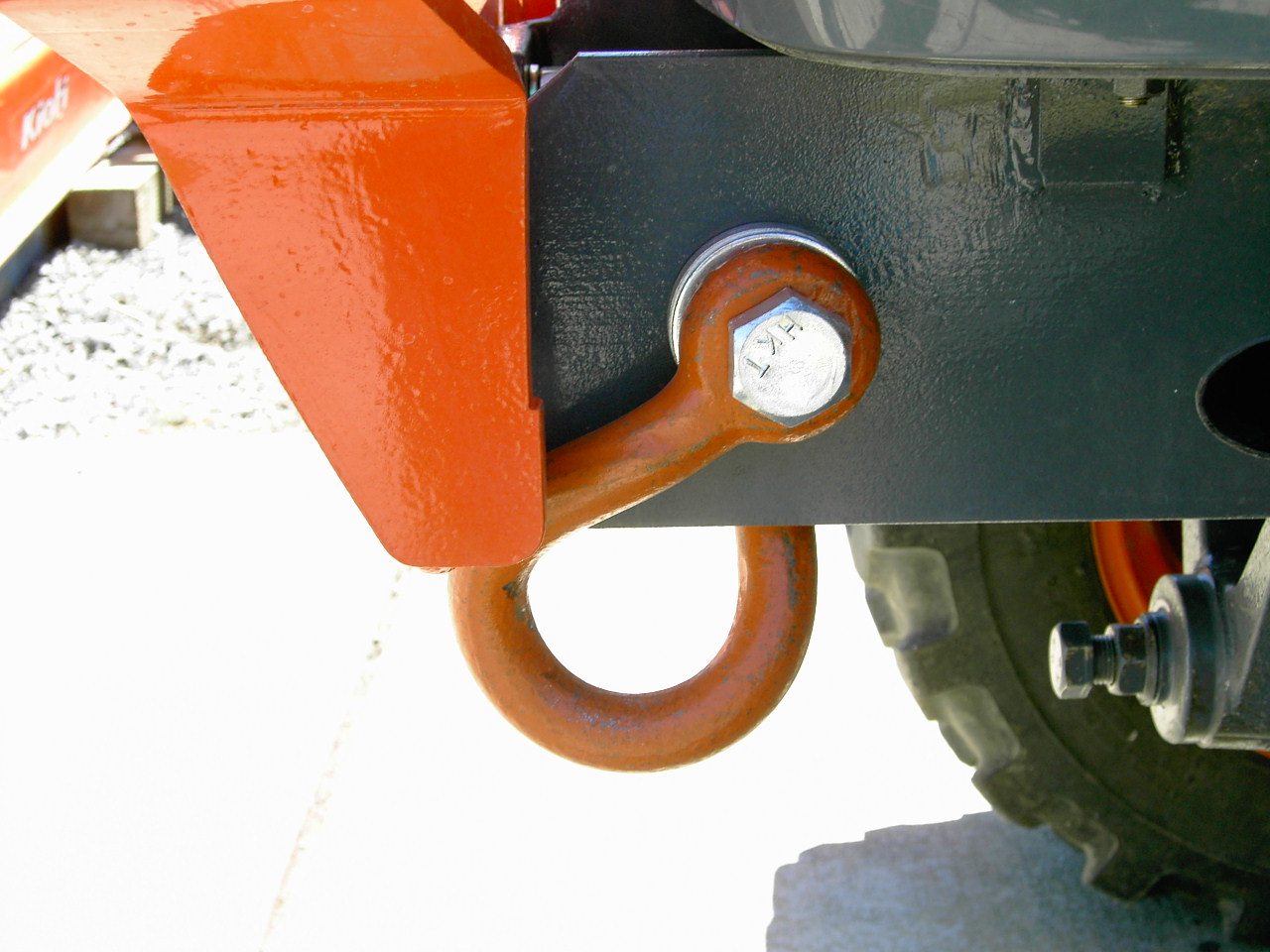

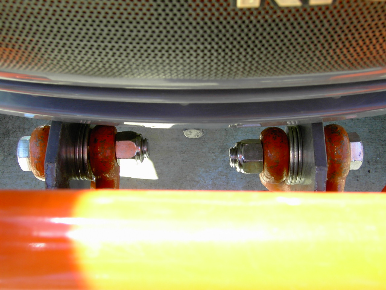

O.K., here's my input, when I had my CK20 all I did was to install a clevis with a 3/4" pin on the draw bar and ran a chain thru it. On the front I installed a pair of "twisted" cleviss', one on each side of the frame, you have to drill out the holes from 18mm to 19mm (3/4") and use heavey grade bolts 'n' nuts then ya just run your tie down chain thru them. I use this same set up on my CK30. Simple and effective.

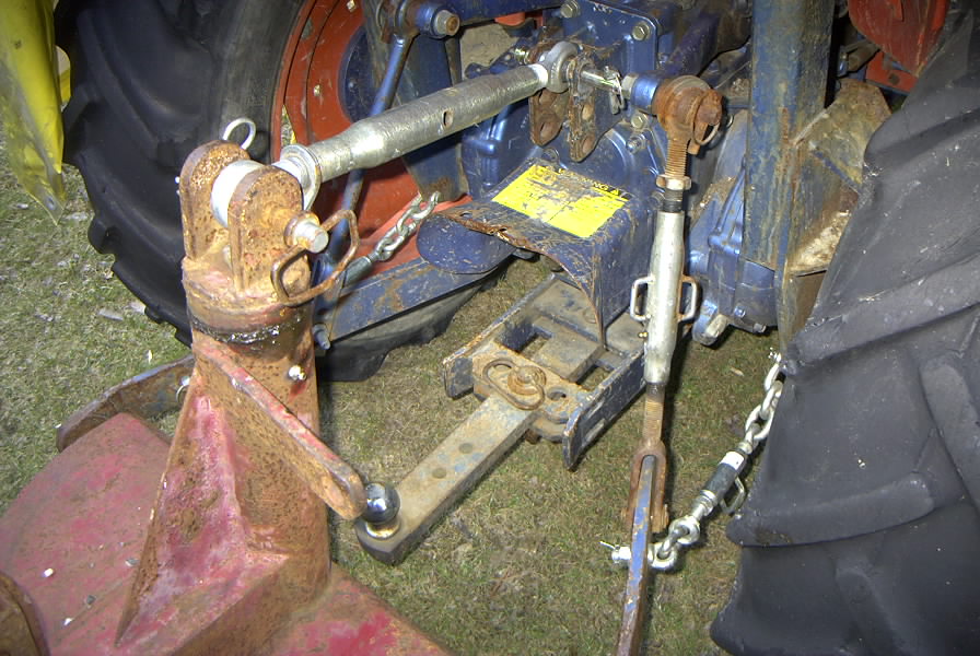

I'm confused dirtauler. Maybe it's the mix of CK20 and CK30 pictures but I didn't think that my CK30 had the top front corners of the frame cut off. I found a couple of other differences but maybe those are just the CK20 pics.
On the rear clevis, do you still use two chains or just one pulled all the way across the trailer and through the clevis? I would be awfully worried about a lack of side to side restraint if you only used one long chain. Though I see it done all the time on yellow machines.

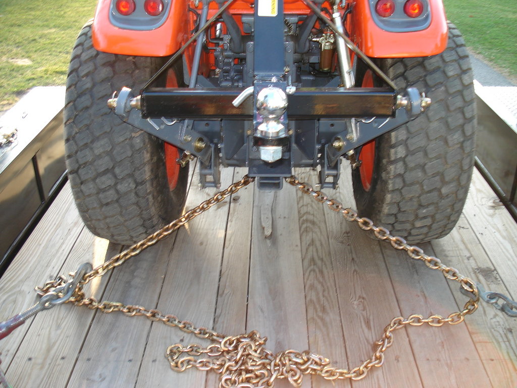

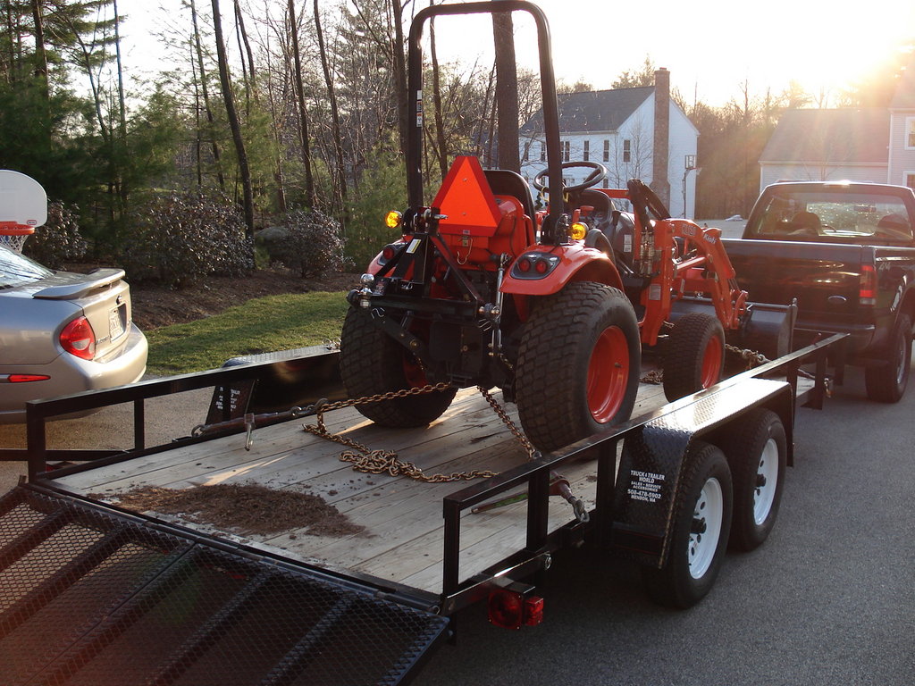

Highbeam.....I know I'll get "flak" about this but yes I use one chain thru the rear clevis from each rear corner of the trailer which is about 45 degrees and the same for the front, the tractor is "streched" between the two points and doesn't move and I know alot you out there are gonna gasp for air and grab your chest but I've hauled my tractor alot of miles and have even "tested" this one day when some idiot decided to flip a U turn in front me while I was moviin at about 45 mph and had to lock 'em up, alot tire smoke but the tractor never moved!

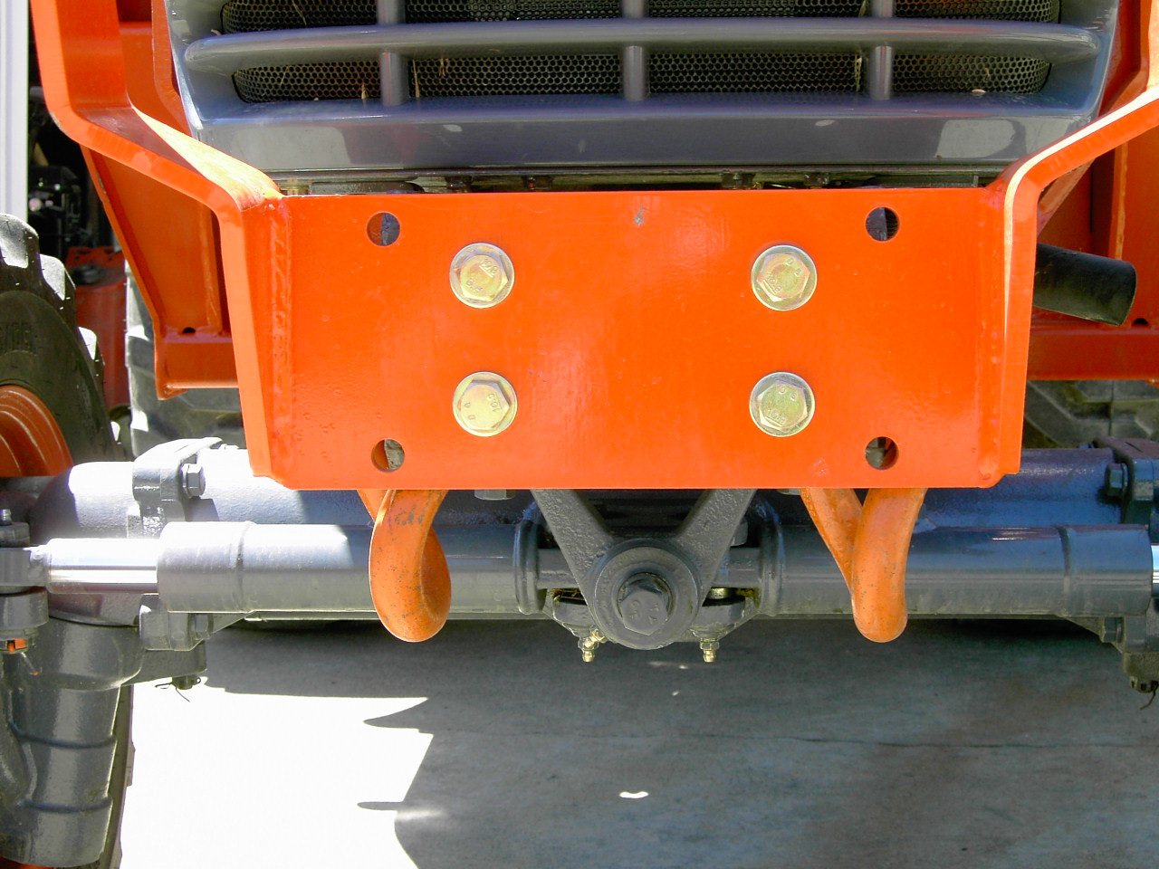

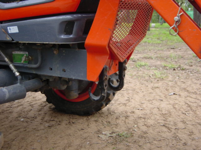

Took a pic of my hooks, Jeep tow hooks I had laying around.

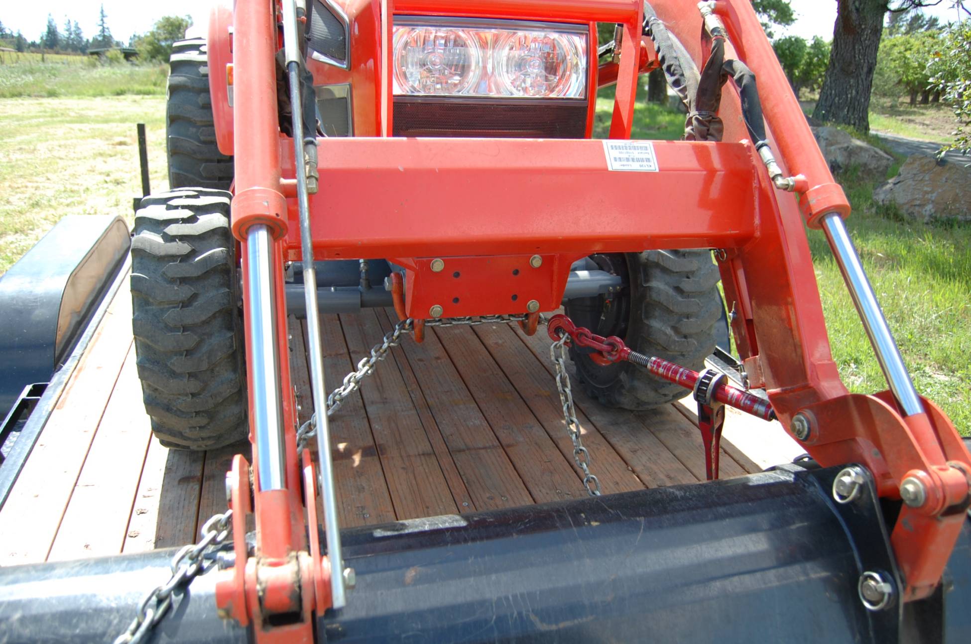

O.K., took a couple pics of my CK30 chained down. The front method works for CK20/25/30 I just used the existing holes on front sides (drilled out to 3/4"). On the back, I used this clevis but with the draw bar attached on my CK20.
On my CK30, I removed the draw bar (too long) and have the clevis attached to the draw bar hole.

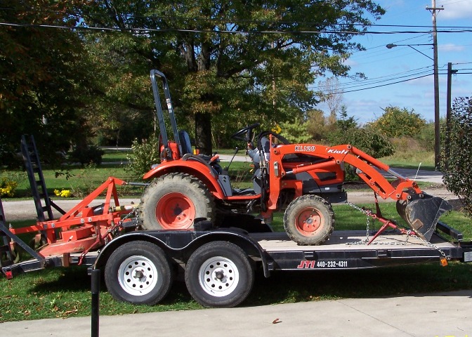

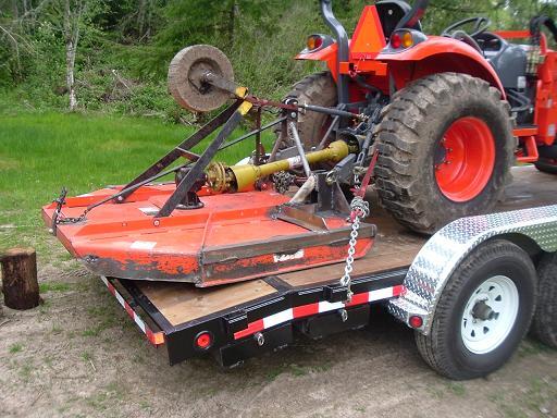

If you are buying a trailer, get an 18'. If you already have a 16' it will work, but it will be a tight fit. To get my CK20 with Backhoe loaded and correctly balanced the hoe actually extends beyond the end of the trailer.
Attached is a picture with the RFM, if you look close you can see the rear mower wheels just off of the end of the trailer. If I could have found a deal even close to the deal that I got on the 16' I would have spent the extra money for an 18'.

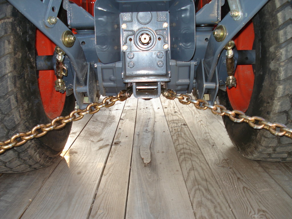

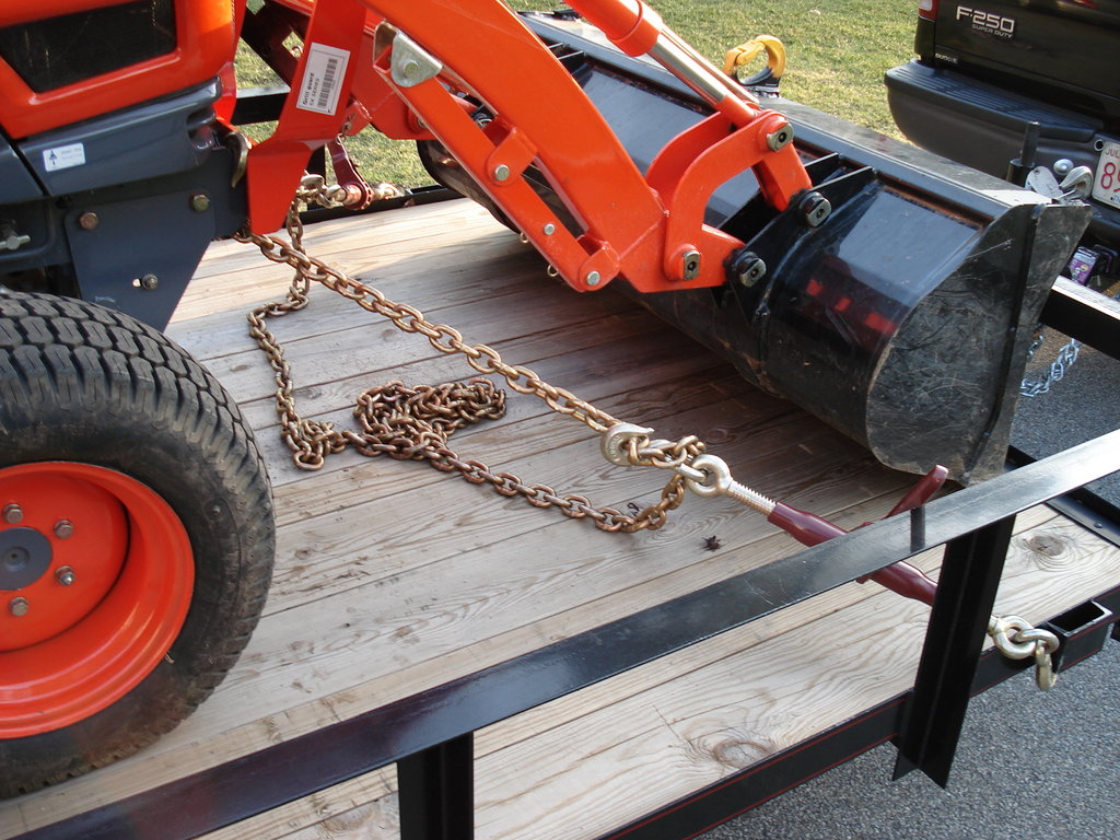

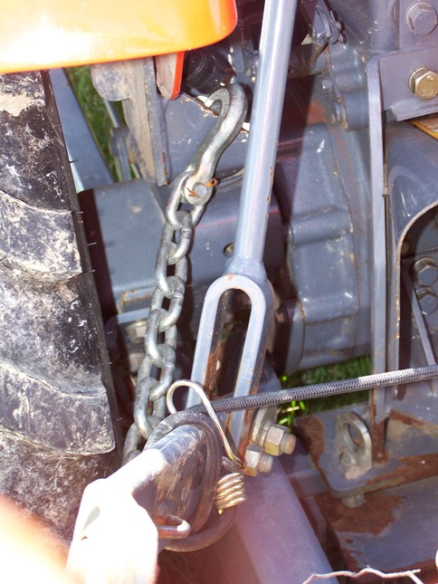

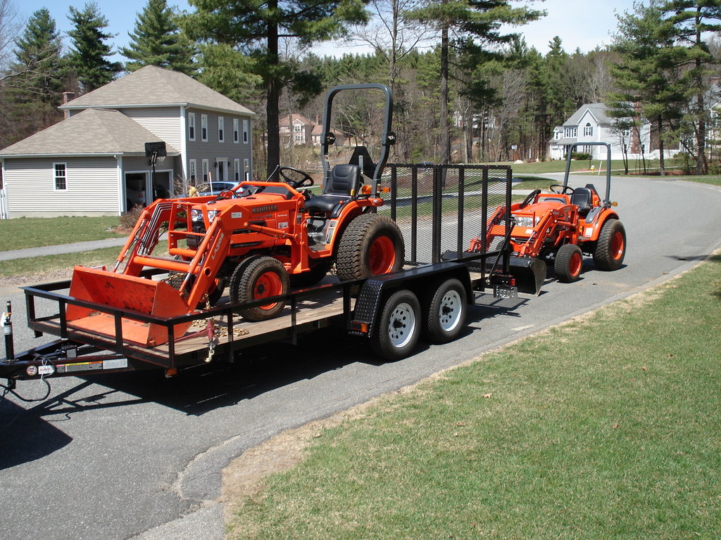

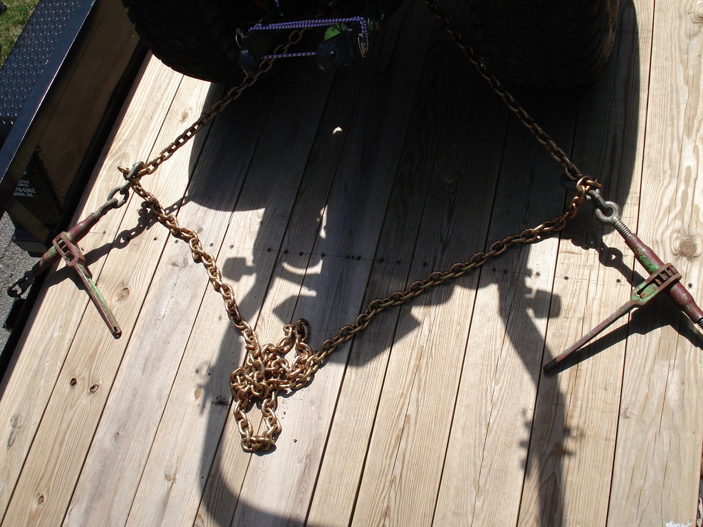

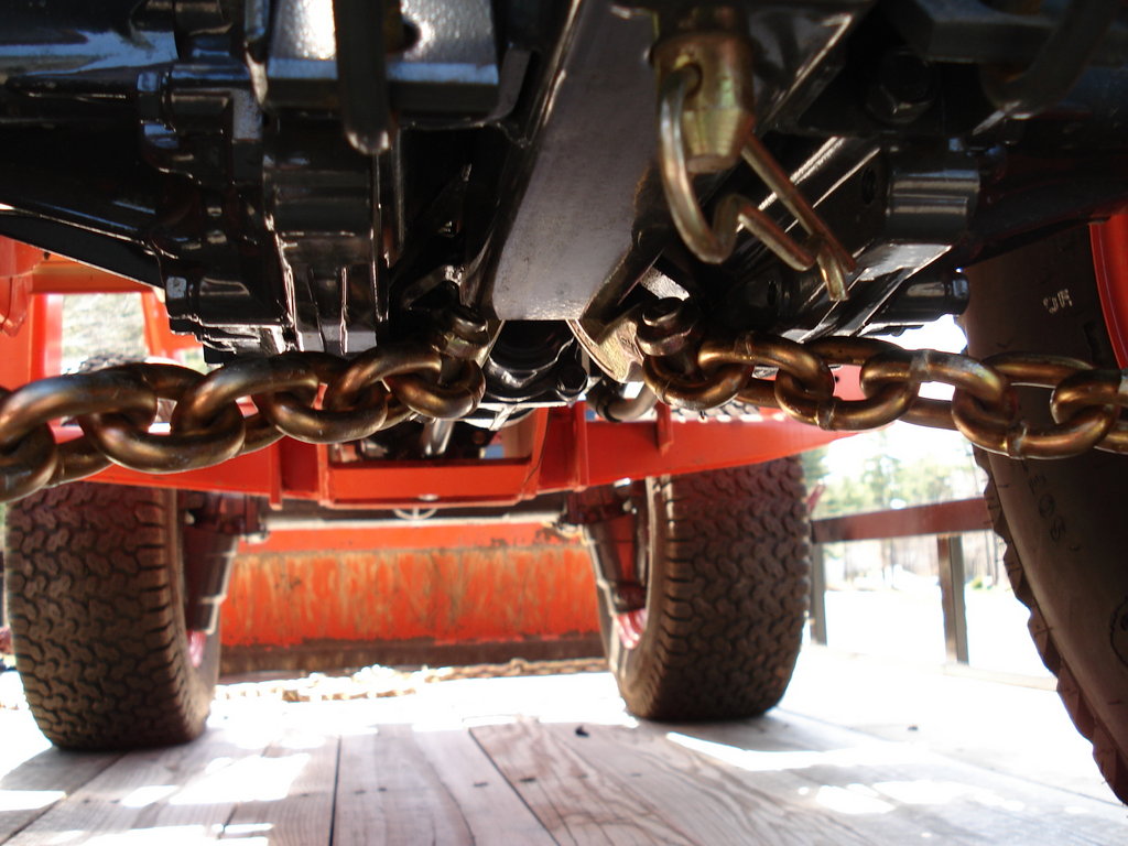

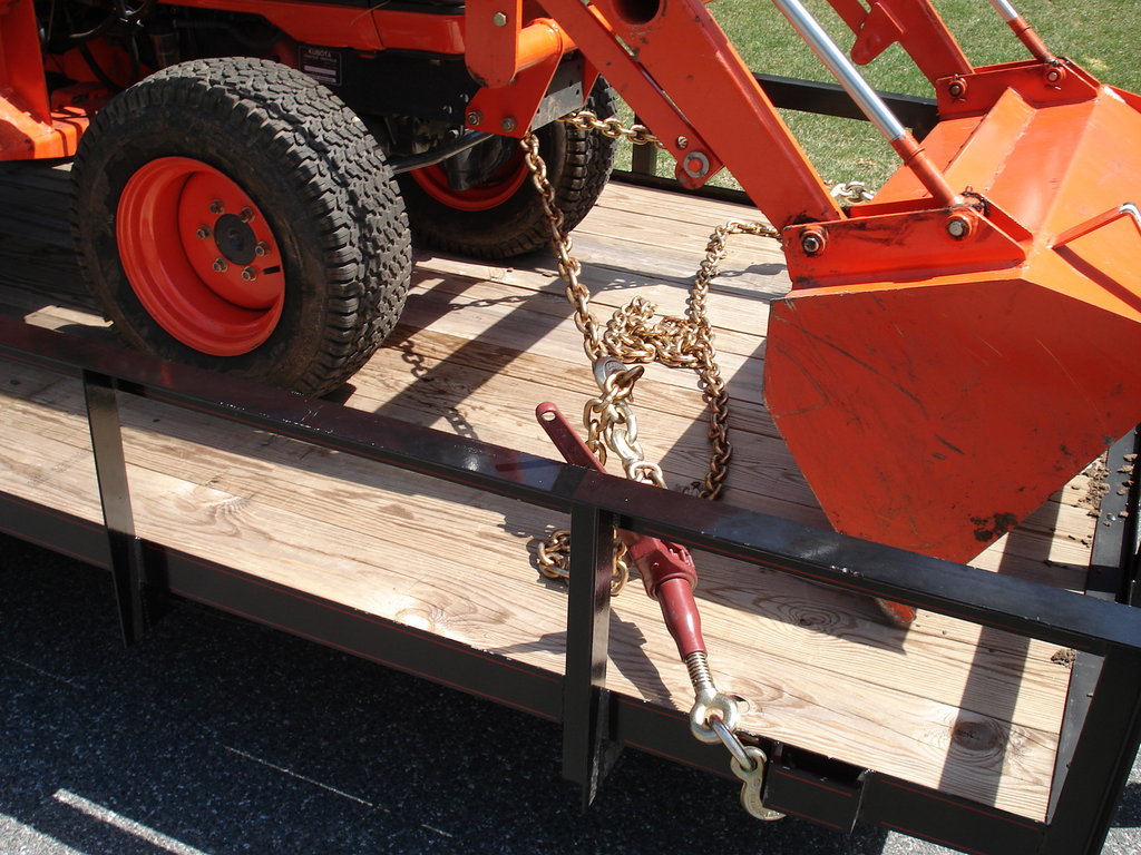

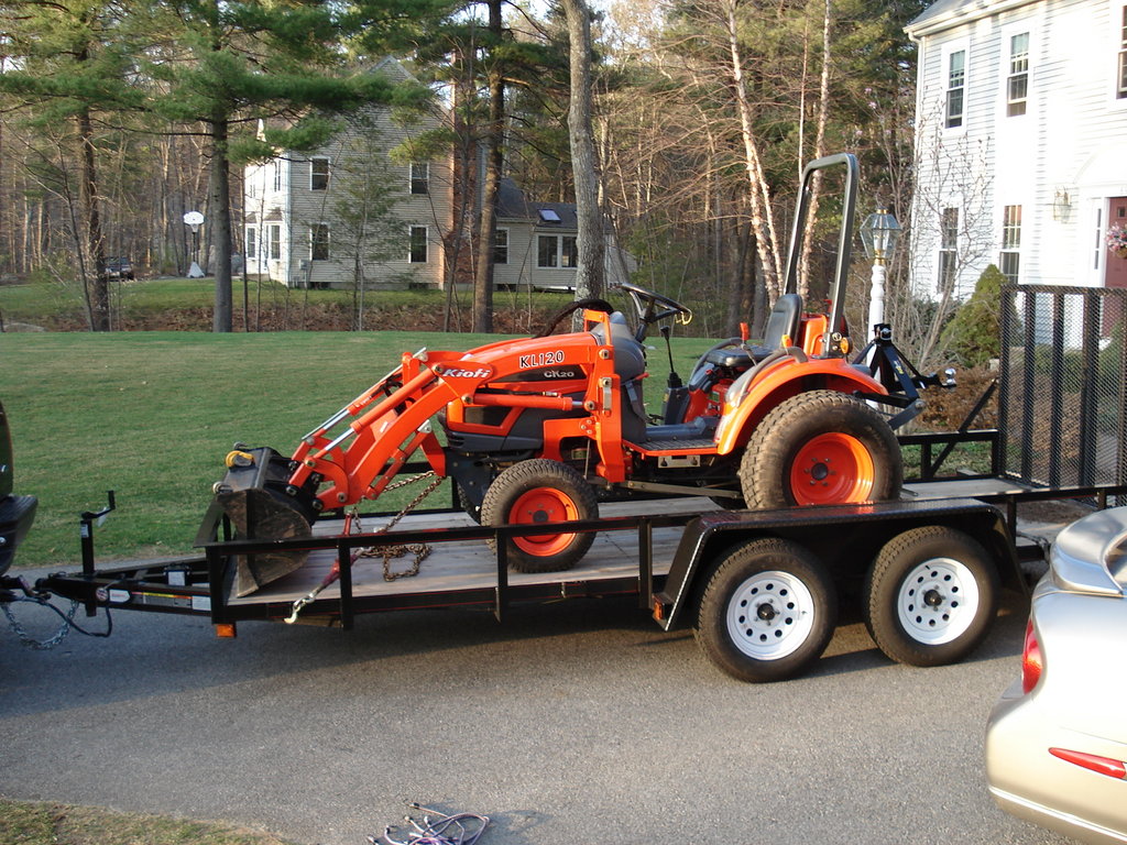

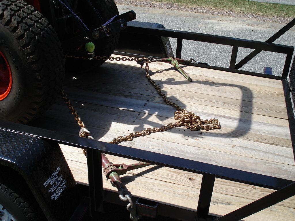

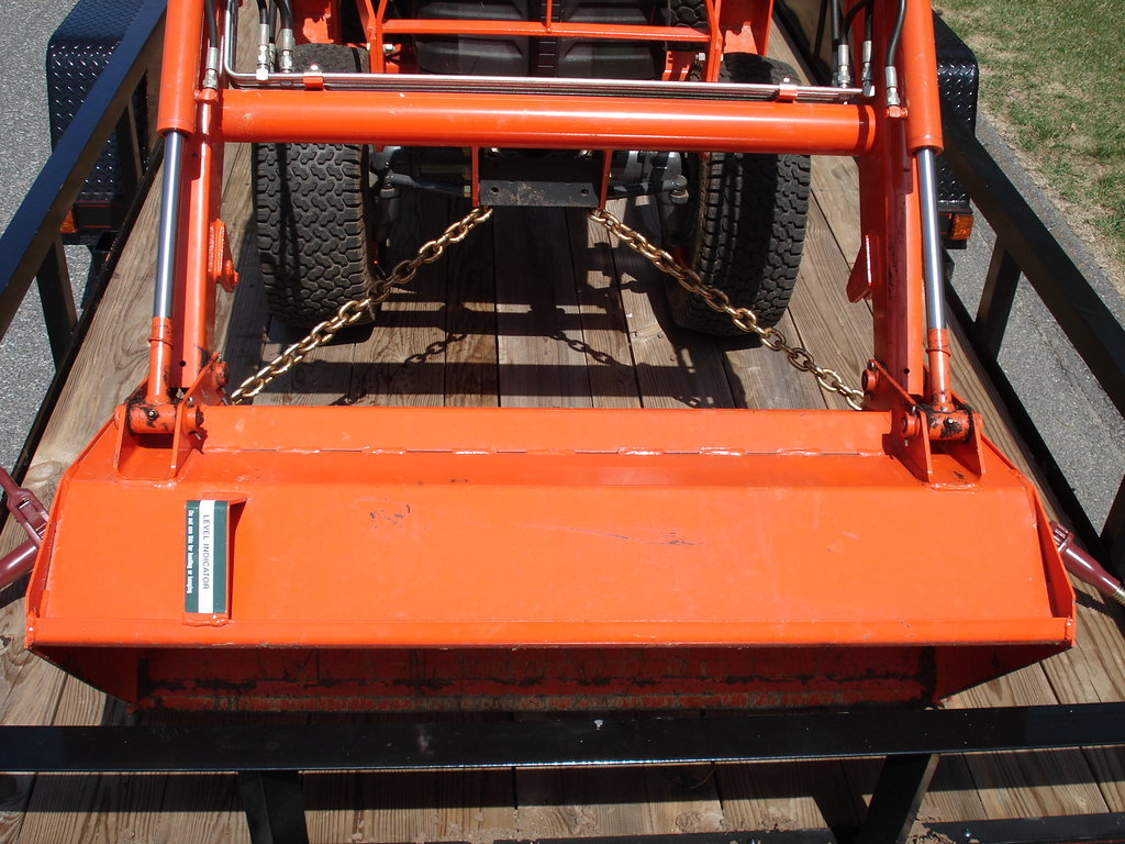

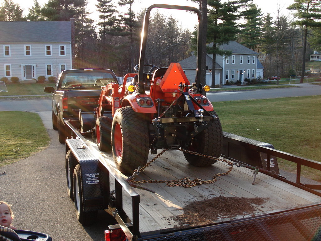

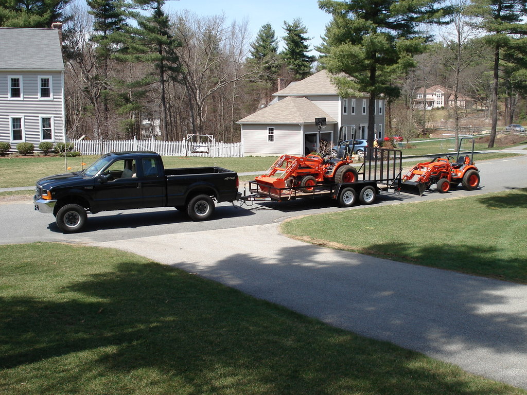

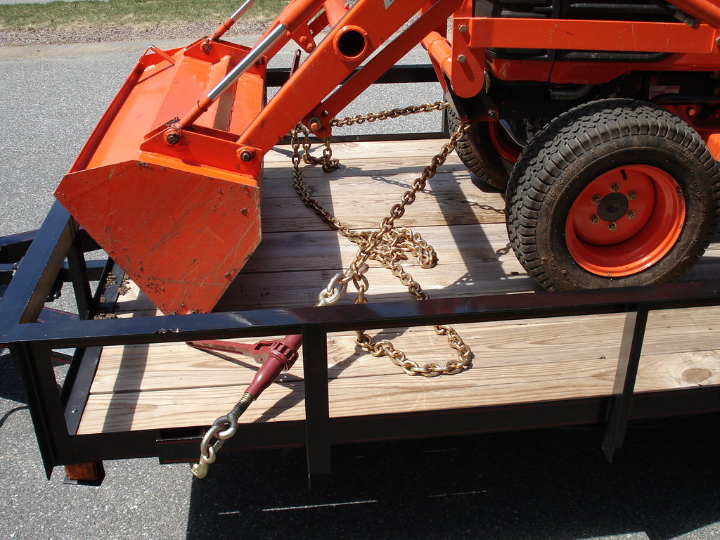

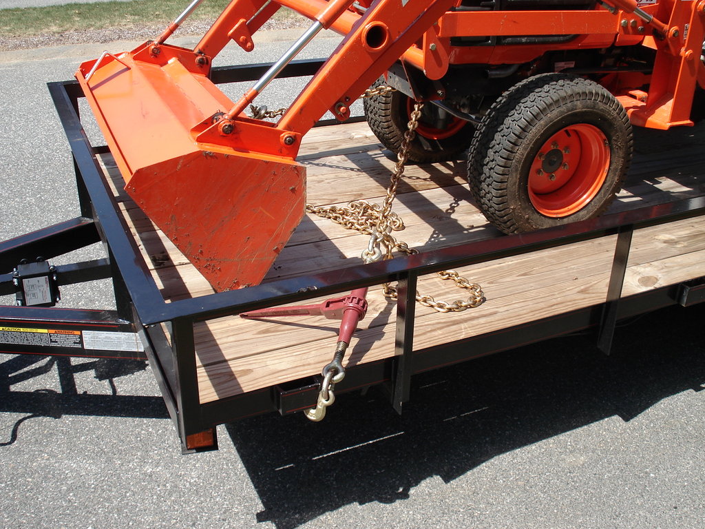

Jeff and I finally got to try out the new trailer today. We set it up w/ his B7510 for a trip down to Rhode Island. The method used to hold down the B7510 is precisely how I will hold down the CK-20. We're using the rear drawbar housing w/ grab hooks that grab beautifully and ratchet binders to the trailer hold down pockets on the side. The chains are grade 70 tow chain 20' each w/ grab hooks on each end. I may cut the chains in half and add grab hooks so we can attach the chain to the trailer the same way they are attached to the front frame of the tractor where the hook wants to stay hooked (open end facing down) w/ gravity acting on them. Then the ratchet binders can simply hold two separate chains together for each corner.
This trailer is capable of 7000' w/ brakes on all 4 wheels. The rear gate is landscape style however the bars back there are sqaure tube instead of angle or channel and take the weight of the turf tires nicely. We got this thing for $2200.00 from Truck and Trailer world in Mendon, MA and we're very happy w/ the results.
Jeff reports this rides nicely at 65 MPH w/ no sway what-so-ever on the highway. Went over plenty of bumps around town and the tractor didn't budge -- it's bound down nice and tight.
I'd like to thank all of you who took the time to reply and offer pictures. This thread appears to have been helpful to lots of folks. In return, I'm going to attach pictures from today's activities.

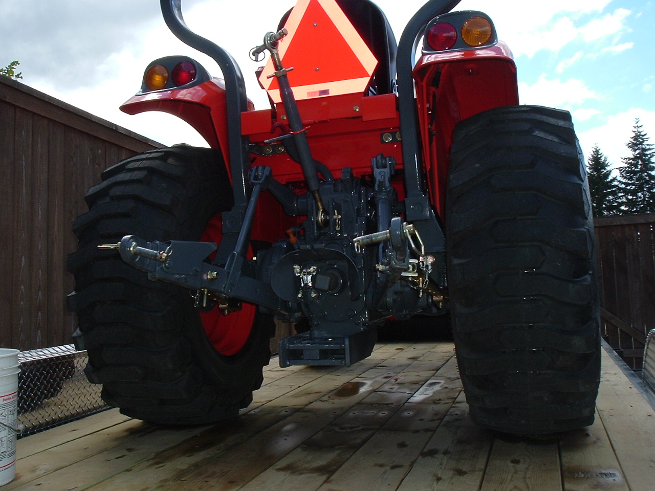

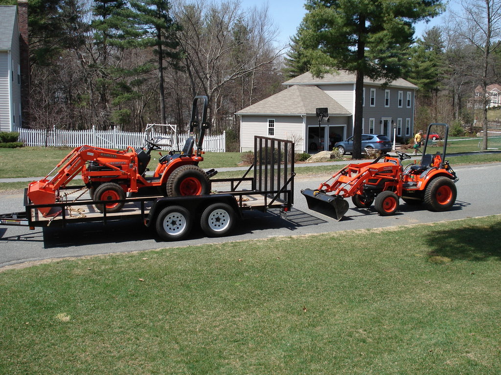

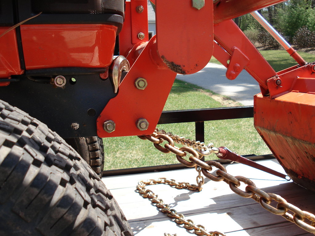

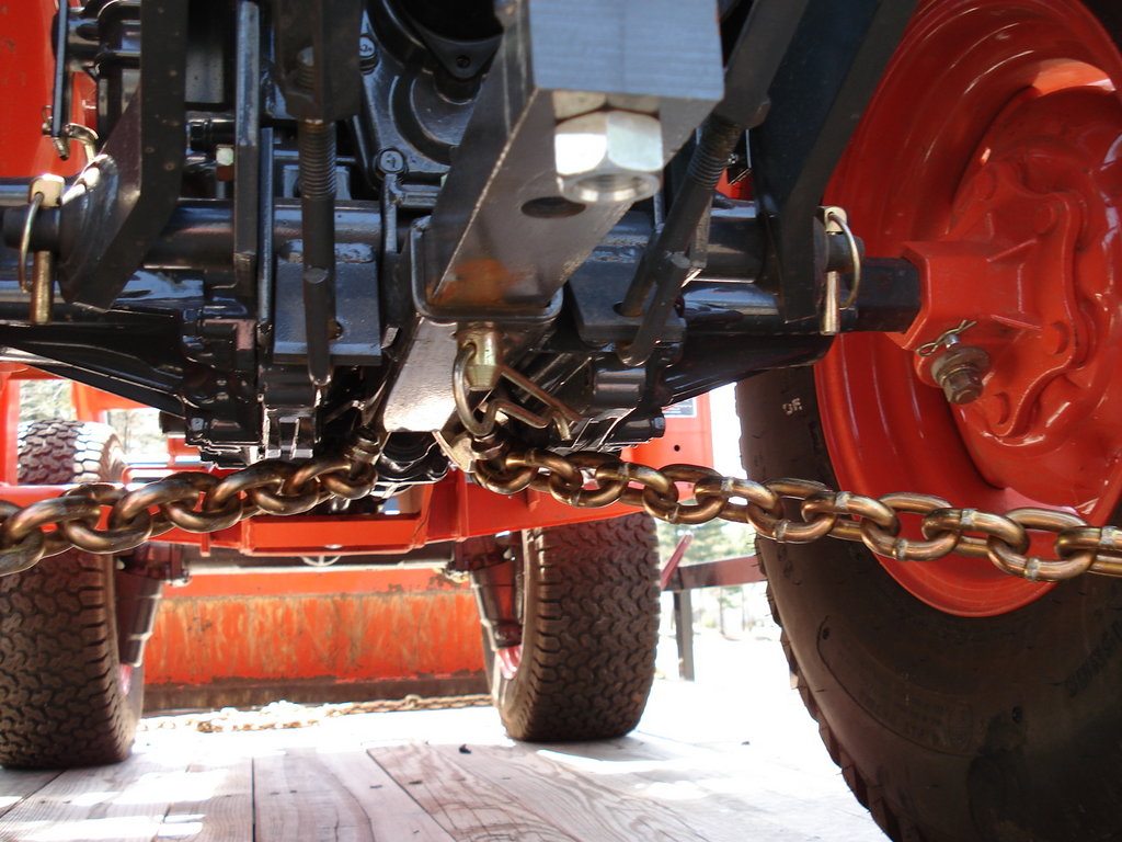

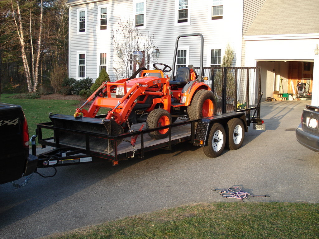

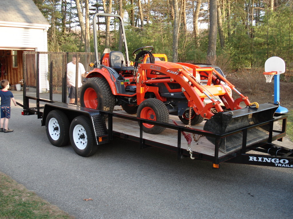

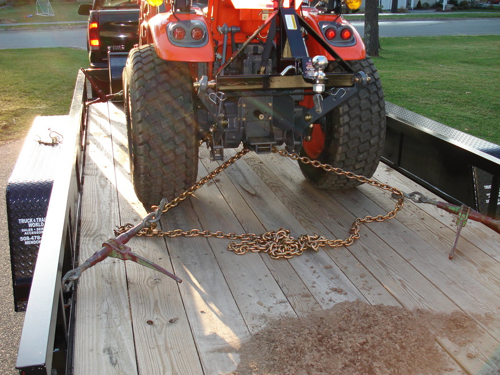

And we had some time later to put the CK-20 on there. Got a nice close-up of the grab hooks going into the drawbar housing -- works great.
Here are the pictures.
