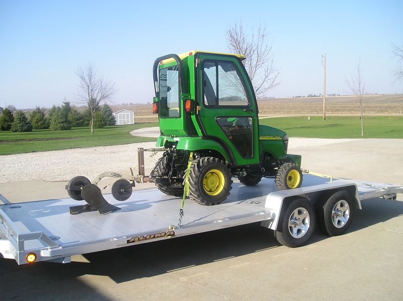

I hauled my 2305 with a 2" strap on all four corners of the frame. I wouldn't trust anything smaller. I also had an 8 inch chain hooked to the stake pocket that each strap hooked into. That way there was nothing touching the strap to chafe it. The straps were 20' long when new but I cut them down to 6' to fit my rig and not have to deal with all the extra strap. I found a spot on the ROPS mounting brackets for a large welded eye-bolt to bolt to on each side. The strap hooked into it. The straps have a 3333 pound WWL and cost about $20 but they are on sale for as low as $10 each last fall. I always buy a couple when I see them that cheap.
But if you already have the chain then that is the way I would go. It is just heaver and slower using chain.

Anyway, IMO there might be more angles/tricks to using straps the best way than chains (if there is a best way), but shortening 'em and adding anti-chafe extensions is a great tip. (Thanks!) Might have to tweak mine & try 'em again. Left to that, I'd want wheel chocks in there somewhere too 'cuz I'm usually more cautious than confident. I can't imagine using a come-along to anchor anything heavier that 1/2 its capacity. Straps seem to be rated much higher, but I don't know if the ratchet mechanisms are as tough as that implies. If the OP gets good dope on 'em I'll be taking notes.
