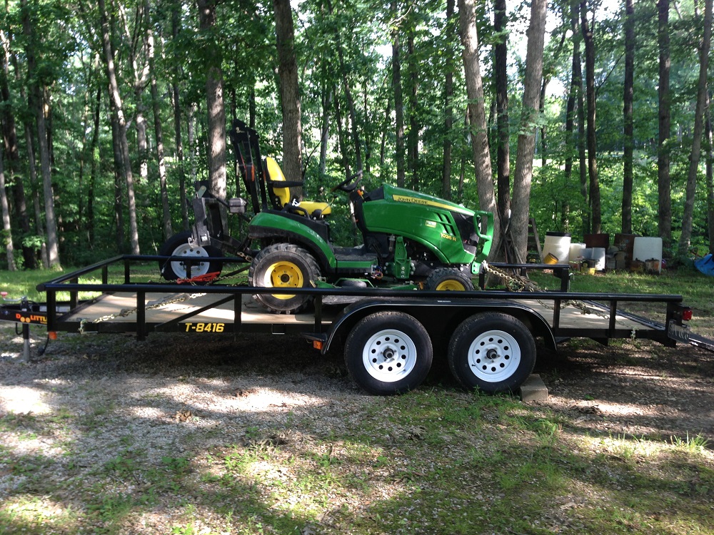

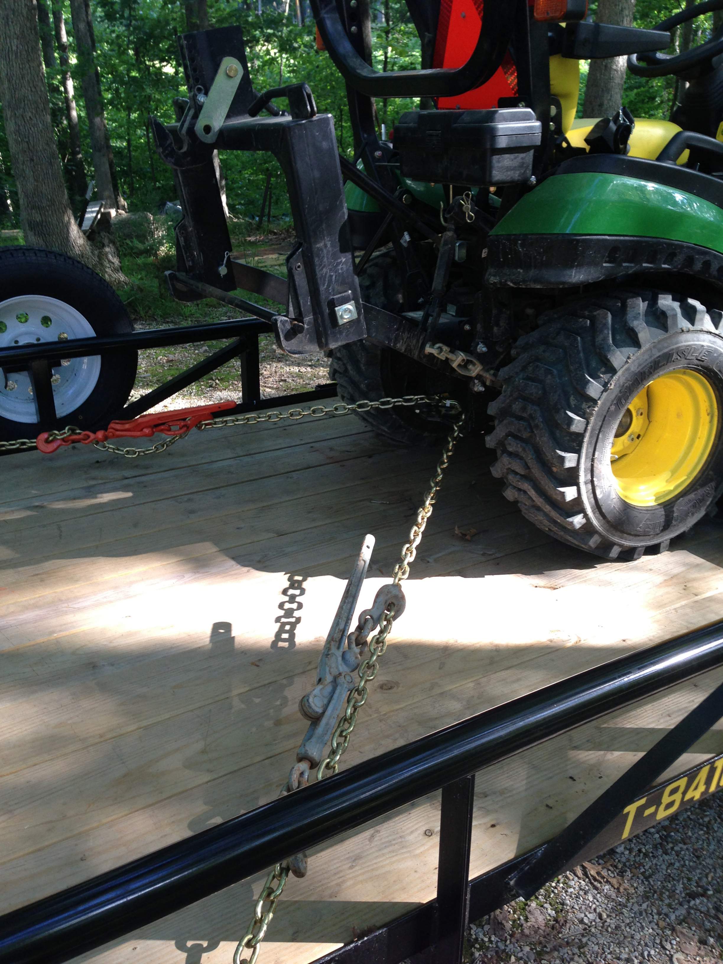

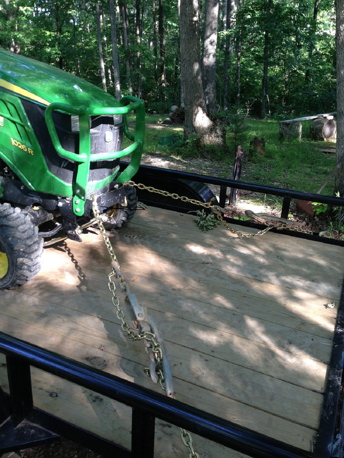

I made this post a long time ago and I haven't even trailered my tractor since I made my post, I went out and invested in some grade 70 5/16" chain, my dad already had 3 trucker boomers and I went out and bought one, here is some pictures. I will be sure and wire the handles of the boomers down so they won't come loose while driving down the road.

Looks great!
Just so you know some states (maybe all? I have no idea) require you put a strap or chain over any implement (like a backhoe bucket or box blade). Not like it will fall off but I guess always better to be safe

I don't know if Missouri does or not but I will prolly throw a chain over the implements when I haul them. I had ratchet straps I always have so much trouble with them, you get them so tight then I have troubles getting them loose. I figured I would do it right the 1st time and buy Grade 70 chain it will never wear out and have to be replaced. I only bought the size of chain I needed I have other chain but I hate all that chain laying around on the trailer or wrapped around just to take up slack. Chain prices in my small town are really different, Orscheln's Farm and Home wanted $5.99 a foot and Tractor Supply wanted $3.79 a foot, but what was funny was the hooks to put on the end at Tractor Supply were $8.99 each and at Orschelen's was only $6.79, pays to shop around.

What is the chain hooked to on the bottom of trailer ?

The chain is hooked to the stake pockets on the side of the trailer.
