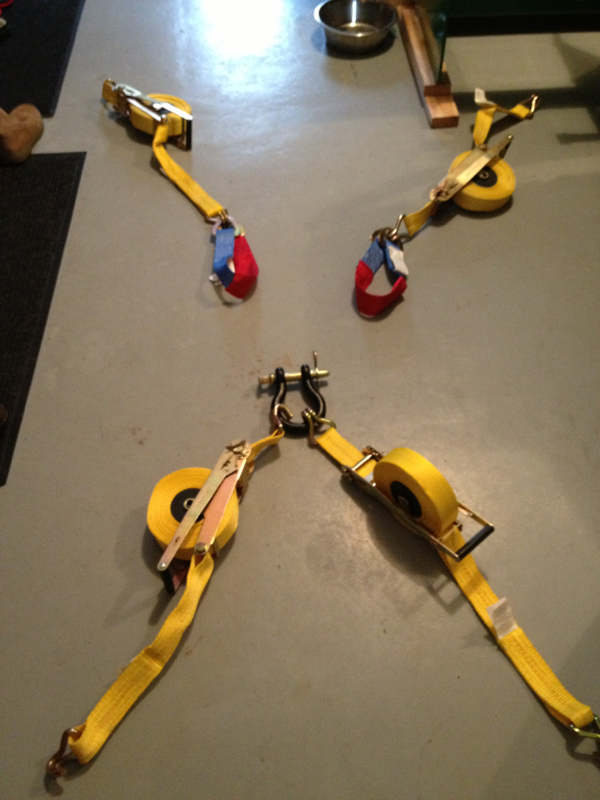

I want to haul my John Deere 1026, I may have my loader and a rear blade on when I haul it. What size ratchet straps do I need? Break strength? I really hate ratchet straps I always have so much problems with them, I have seen those retractable ratchet straps that you push a button to release then tension on them. I might look into getting some of them. Any thoughts?
I have a JD 3320 and use Quick Loader retractable straps. They work great and I would recommend them to anyone. I hate the traditional ones! I got them at Northern tool. They're rated at 10,000 break strength. This is how I set it up and I think this would work for you...
Put an axle strap on each side of your front axle and secure to trailer. Put that D ring on your drawbar and then secure each strap to you trailer. Your good to go!
