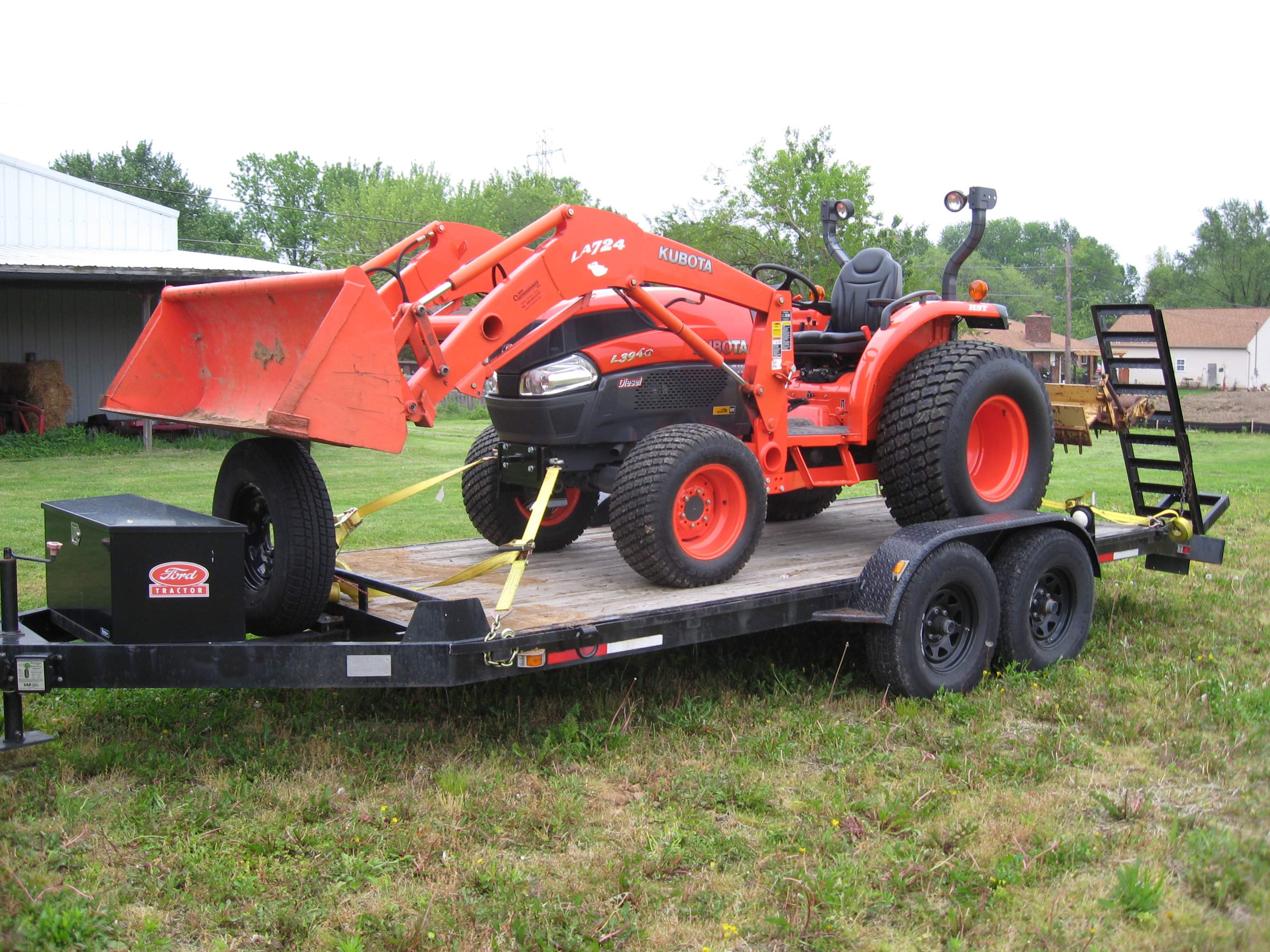

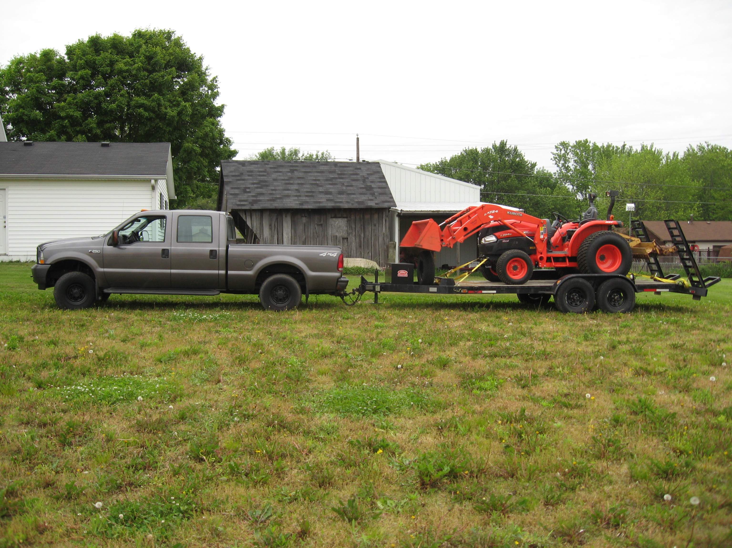

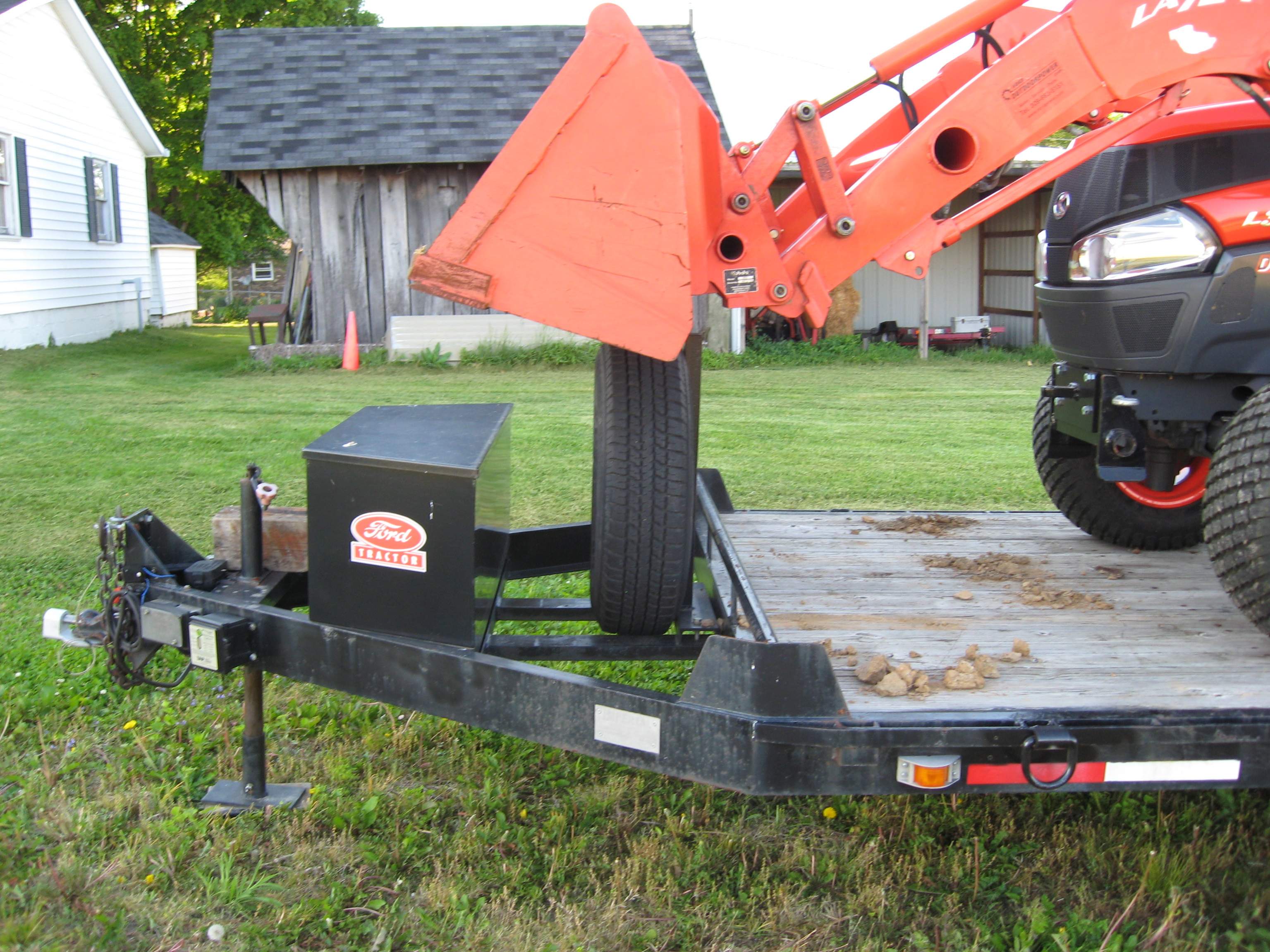

Here's how my new B2320 was delivered, (he had two tractors to del).....:)
Yea, thats kinda what I had to do to get it on the trailer at all but didn't have the bucket that far forward. The tongue on my trailer isn't as long as that one so there is not a lot of room. Really scary when making turns - don't want to put a big old dent in my tailgate. :mur:
