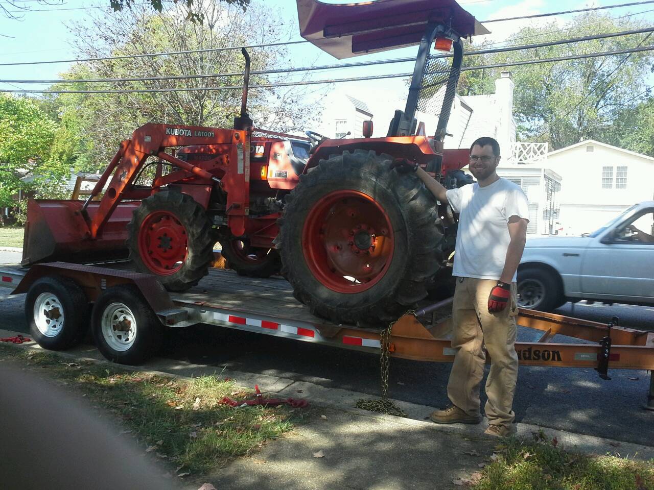

I know there was a thread on this last year but I CAN'T find it.
Tractor/trailer:
Tractor (4K lbs) w/ FEL (1.6K lbs) and loaded rears (1.3L lbs) I'm guessing at about 7.5K to 8K lbs, with a little fuel, chains etc.
Trailer 12K Hudson, w/ wd hitch
Tow vehicle 2002 F350 7.3 dually, w/ only about a 2K lb payload.
I've taken the canopy off for travel.
It fits either way.

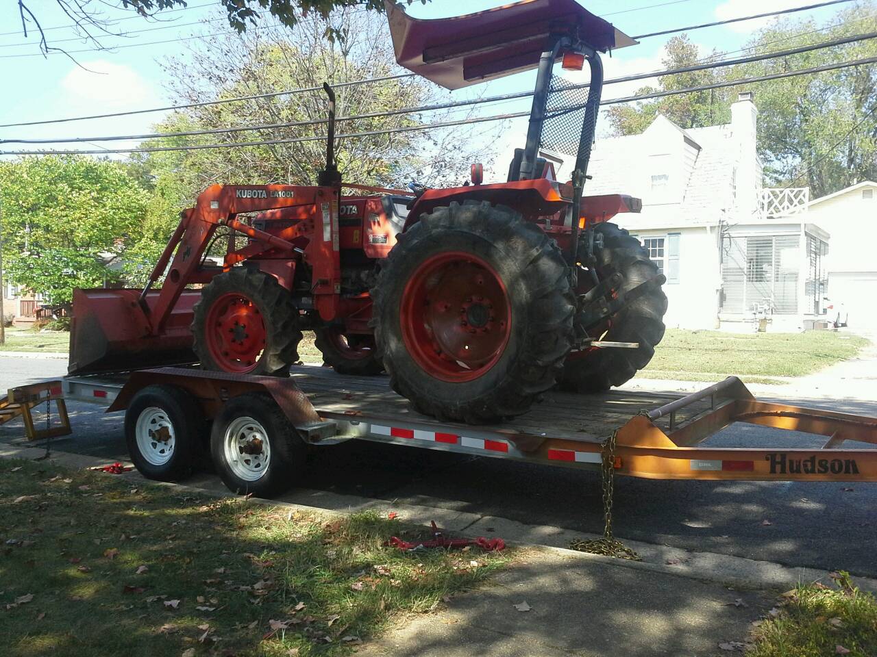

The butt of my dually sinks 2.25" with the tractor backed on all the way
This is the "heaviest tongue weight" and I suspect about 15% based on my other playing around w/ tongue weights.
It sinks 1.25" with it backed on

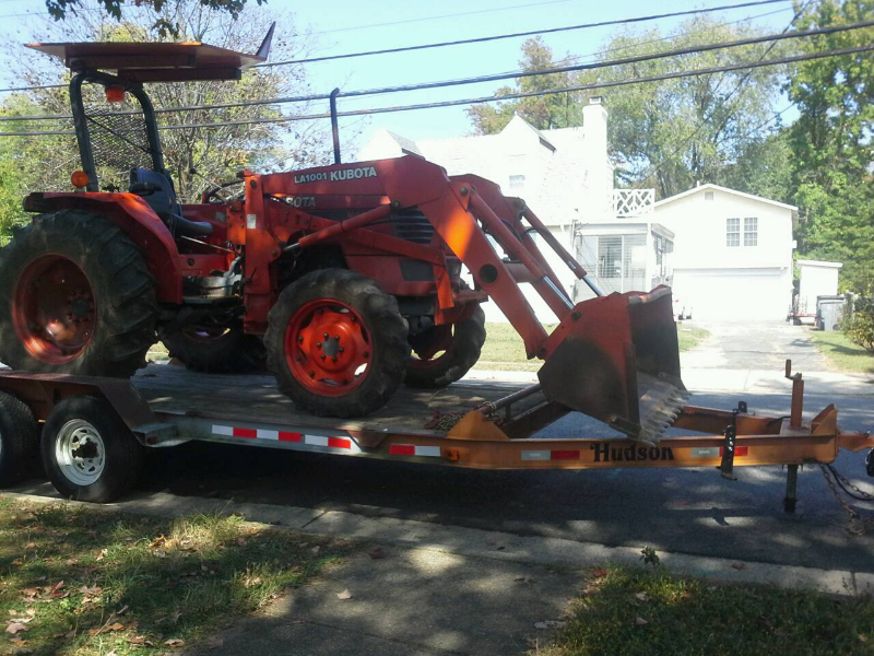

And with it pulled all the way forward, as in the first pic, w/ bucket over the frame it sinks about 1.75".
So I can put it on either way. What does the collective TBN mind think is better? Forward or backward?
Your receiver hitch on your pickup has a tongue rating. Don't exceed that. The pic with the tractor backed all the way up on the trailer looks front heavy.
Also your ball has a rating, often people will buy a draw bar for 10K lbs and have a ball for only 6K.
Based on this thread I'm planning on taking the tractor down facing forward and I'll throw a strap over the hood.
This way gives me approx 1,000 lbs tongue weight (measured w/ scale), w/ chains still in tongue box.
So I figure
trailer - 2000 lb
tractor - 4000 lb
FEL - 1600 lb
Extra weight of loaded rears - 1100 lbs
Total weight - 8,700 lbs
10% to 15% is about 870 lbs to 1300 lbs so I'll make sure I have a little more weight in front.
Darn glad I DON'T have a 10K rated trailer :)
