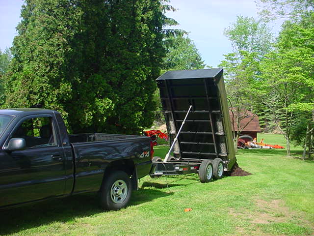

Hi Norm.......
Well let's see if I can answer these questions while not "slamming" anyone's equipment or ideas. As I stated before, this is what worked for me.
I owned the car hauler (18') long before I bought the dumper. In fact that's how the dumper came about. I had put a "blue tarp" down on the car hauler and loaded yard trash, leaves, tree limbs, old composte, ect. and the wife and I headed for the local composte site. The idea was to pull the tarp with ropes tied at the corners to empty it. Wrong, could not move it. Another Bud was also there so we tied the ropes to his truck hitch and the wife pulled at the sametime with my truck and trailer in the other direction. Wrong, all tires spun. So the composte site guy happened to be there and he came over with the front end loader and dragged it off, tarp and all.
Anyway, wife says...."there is no way that she is gonna go to the composte site by herself and do that, we need a dump trailer".......got my vote and dump trailer.
1. yes they make a dump trailer big enough to haul a tractor, well compact tractor.
2. I like and don't want to give-up my car hauler, it's just too handy for me.
3. My dump trailer is small enough that I pull it around the yard with the BX22 till loaded.
4. My truck is a Hv. 1/2 ton with small v8 and I know if I had a bigger dump trailer I would overload it. (the truck)
So..yes I thought about it, but for me, this worked better. In fact I need to buy and haul 3 29.5 ft steel beams and neither trailer will work. Oh well.
Hope that answered your question? George
