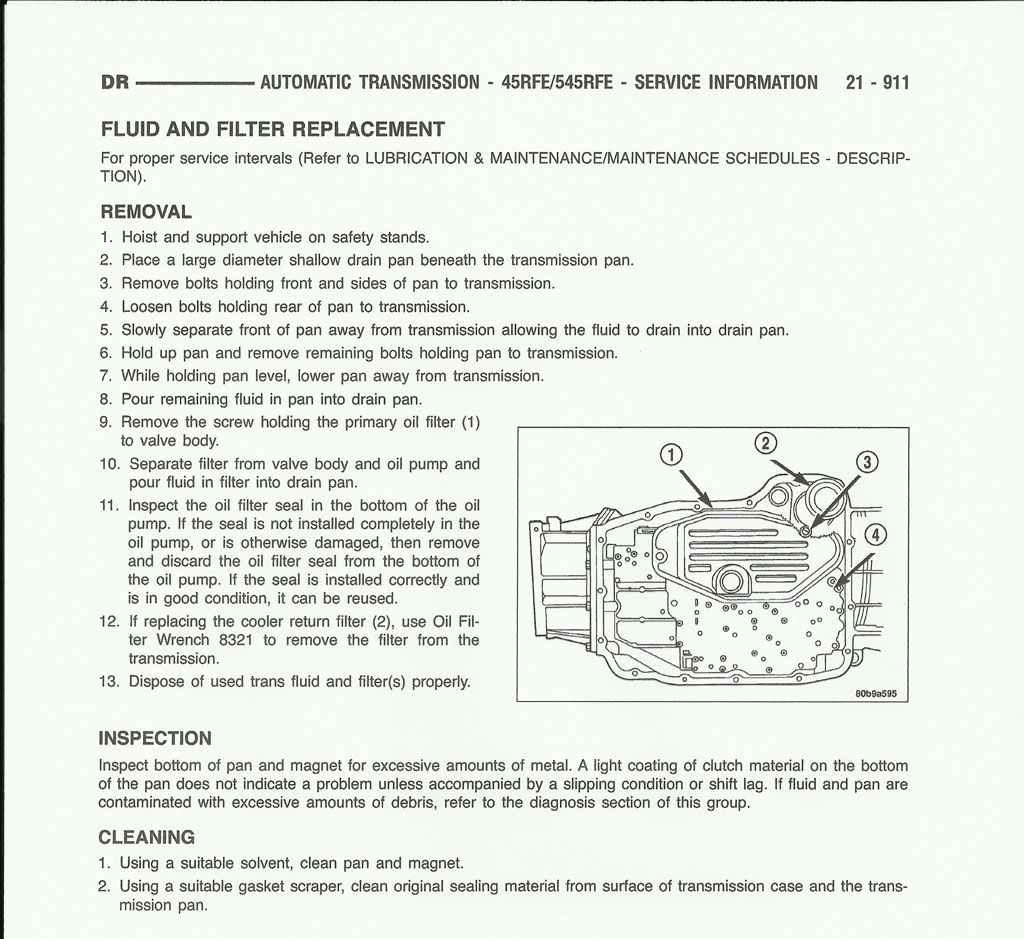

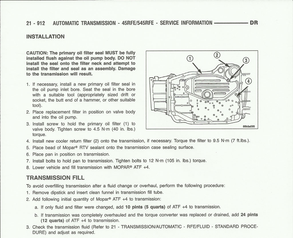

I have no dog in this fight as I do both "change" and "flush" depending upon the circumstances. But in reviewing the 9267 page FACTORY service manual for Dodge trucks which includes the 5 speed transmissions, the attached is the ONLY reference to servicing the transmission. Of course in order to further confuse the situation, MOPAR refers to this procedure as Fluid and Filter Replacement.
Note lines (2) a & b under the Transmission Fill paragraph. To me it suggests a standard fluid replacement is pan only.
Make you own judgement on what they are suggesting.

So far, (despite several invitations on my part), one person has stepped up with a scan from a service manual. Read the pages he posted and tell me this: Whose view does his service manual support? Here's a hint: Before the text detailing the recommended change procedure, it says this in plain-as-day English:
"For proper service intervals, refer to lubrication and maintenance schedules..."
So what's an owner to do? Well, you refer to the schedule....which we all *seem to* agree upon. Then we go to a service manual where it tells us how to go about doing it. And what does it tell us to do?
Do the manual pages he, (and he alone), has posted leave the recommended procedure up for whole lot of interpretation? C'mon....someone dissect the information he posted from a service manual and "interpret" what it means for me. Apply all the ol'-fashioned, down-home, folksy "common sense" you want and see if you can twist what's on the service manual pages into something that supports your point.

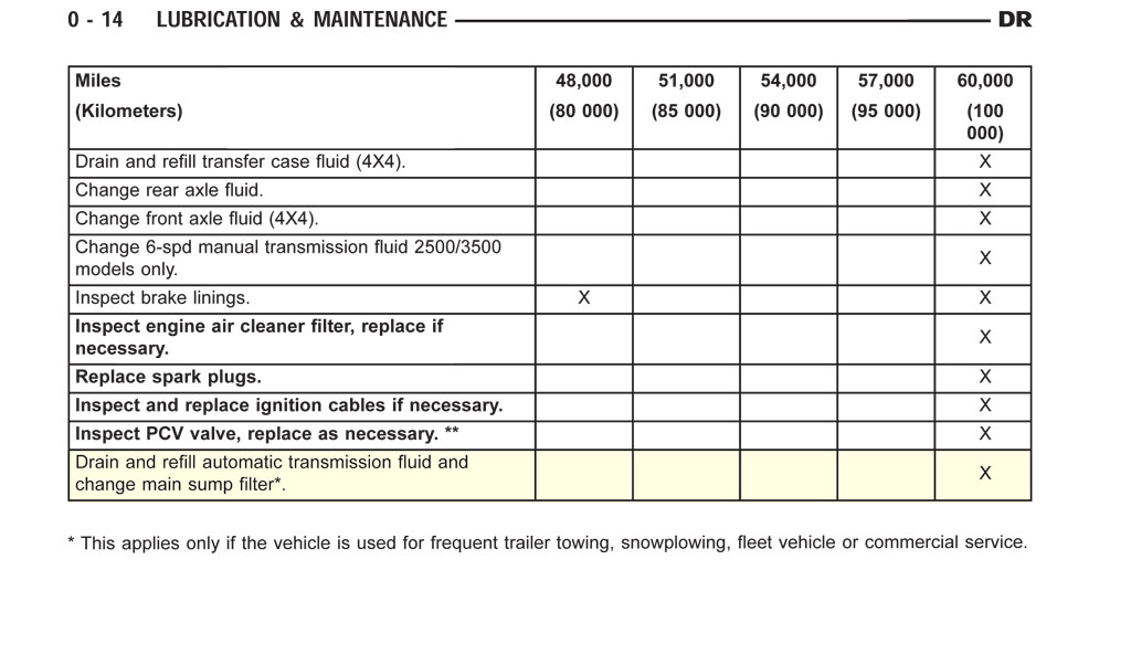

Broke, since you have the manual. How much trans fluid does it tell you to change?
