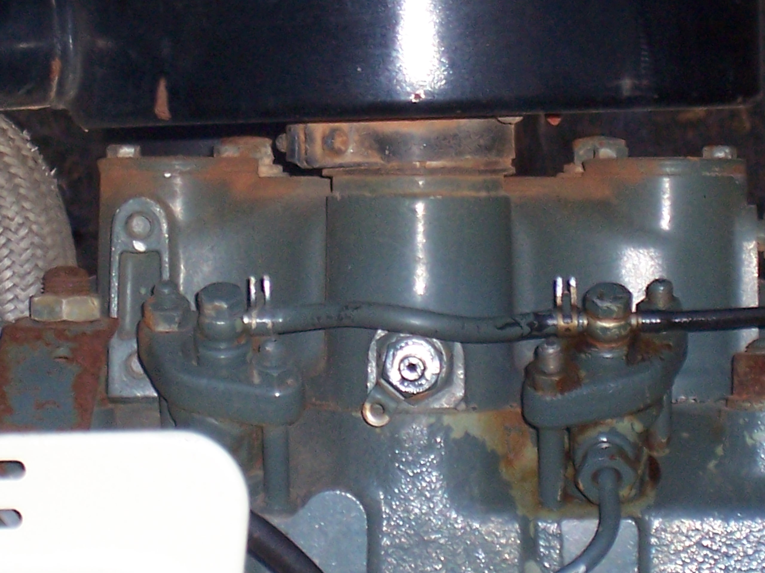

I also checked...I do not have the thermostart on mine. Probably just the standard key switch though.
But thermostart would be nice to have. Can some one shed some light on how I can install one. I have read that there were 2 kinds...one with a bottle (resevoir) and one without ( I guess with just a supply hose).
I would prefer to install the one without the bottle. I can find the electric plugs fairly easily online. Just wondering about the fuel inlet etc

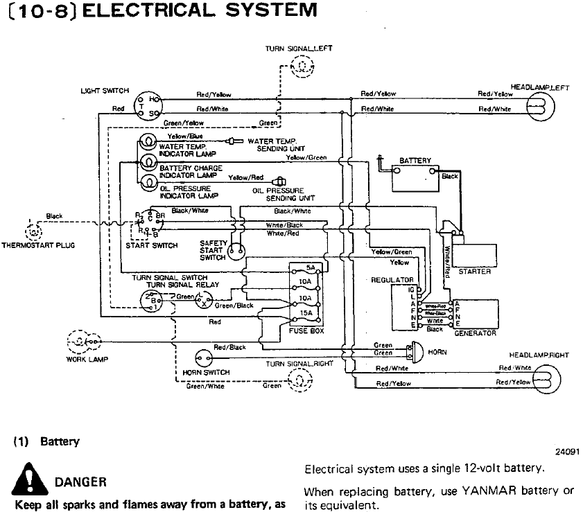

Just went through TS and how I done it on the Cheap and easy. Look back to Thread 1/13/10 Block heater/Bennett Man should be the same as yours. I never use mine so I wasn't going into my dash and wire my Ign. switch. Quick connect straight wired it but here is the Wire/Diagram for the 240. Basicly just a jumper and then a to the TS. The way I did it works good and you won't have the problem of any geld up bad fuel plugging up the cup or line from sitting in it.
Carey

I think I can do the wiring easy enough.
How does the fuel hose get routed?
Any pictures?

Yes. should be every thing you need. Also on page 3 A parts Diagram.
And on Hoyes web site under. Tech Info, go to Thermostart Plug-New. Aaron tells how everything works using a photo of the same tractor you have. Is that cool or what:cool: and then it will make sense what I did If I would so happen need to use it. Or set yours up correctly ;)
Carey

OK. I checked all the photos. I still cant see how the fuel hose would be routed if you eliminate the fill-able cup.

If the glow plug is there this is all you need. There is a check ball in the Glow Plug that opens when it gets hot to let the fuel in. I ran A wire from the battery POS. to the Glow Plug to make sure I had power. Not for long 10sec. 15 sec. Should be more than plenty of time.

Thanks. I would like to have mine installed a little more permanent since I will be using mine probably more than you would in GA.
I had read that it could be plumbed in line with the fuel somehow so that there is no need for a tank or bottle

Yes Hoye has the new style bowl to do that.:cool:
