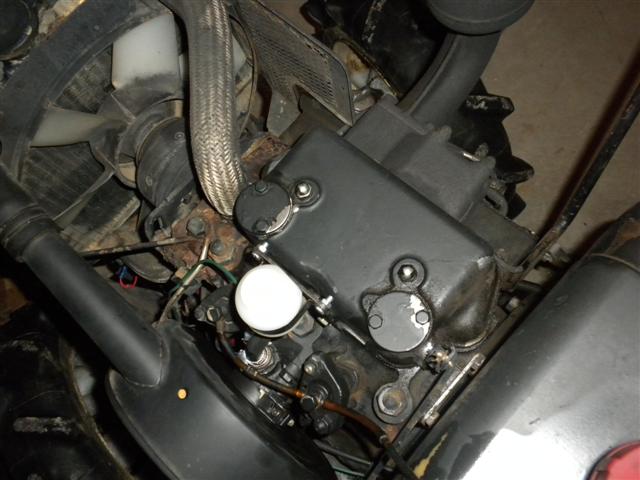

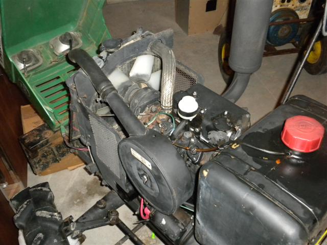

my engine does not have mounting holes on the top of the head
It should bolt to the valve cover- not the head.

Aaron, if your air cleaner pics are correct, he either has a 16oo or a lot of non-1500 parts on his tractor.
   / Transmission sheared gears #63

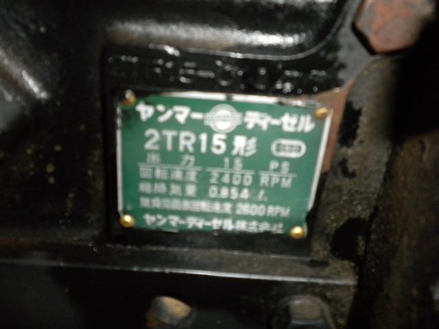

I would be very curious what the serial numbers are on the side of the trans. I cannot find even one YM that does not have a diff lock. There are too many differences, IMHO.
Our air cleaner picture is correct. His picture does look like a 1600/1700/1900 engine. None of those have a 2 piece pinion gear though & all Yanmars have a diff lock.
Edit: Ohhh... I think he was just using a picture that Careyo63 originally posted of his tractor.

So . . . the plot thickens;). Why won't normal Ym1500 parts fit on his tractor:confused:?

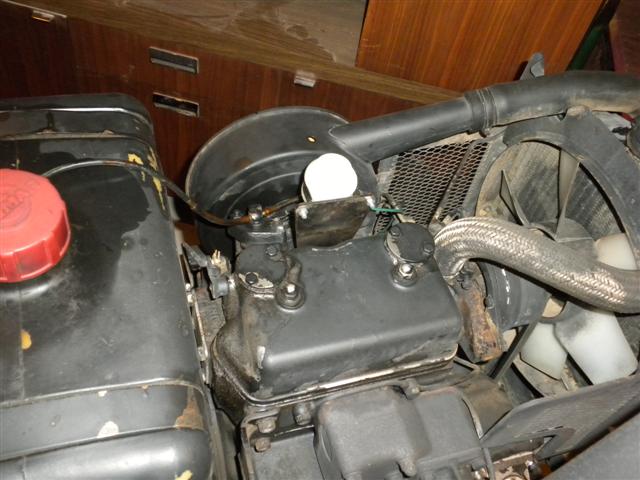

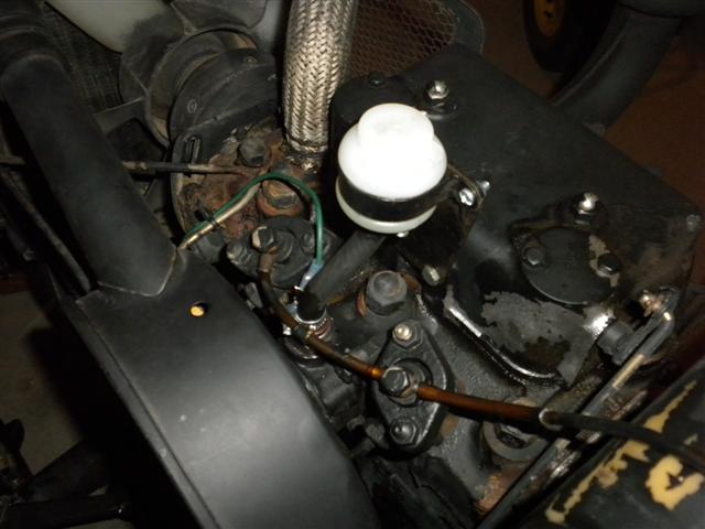

Here are some pictures of my engine. No holes on top of the valve cover. Only holes on the side. Had to straighten the bracket for it to work

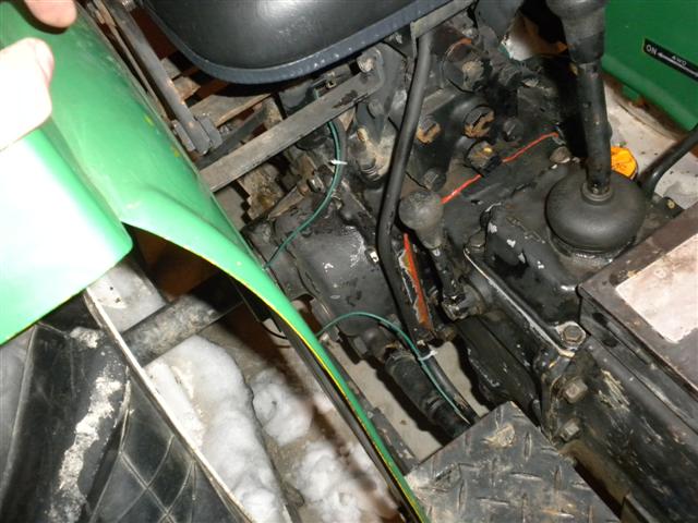

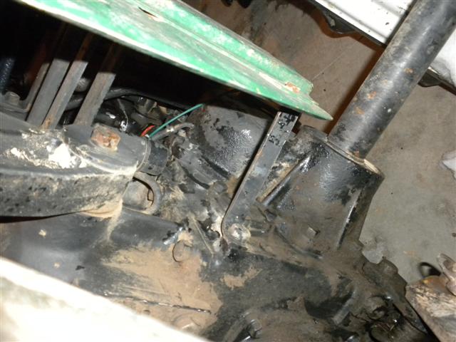

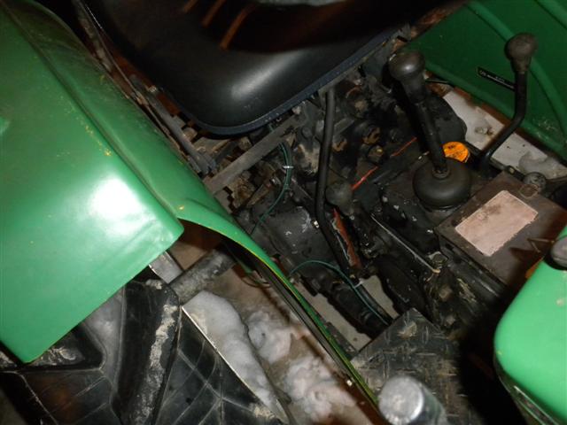

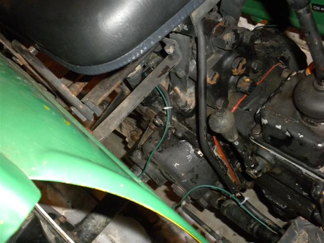

I also took some pics of where the diff lock would be. No lever, or anything.

I'm a believer:confused:, must be a really early model. Valve cover is certainly different, and if there were a diff lock, the shaft should exit the case right above the brake. Is there a plugged hole there?
   / Transmission sheared gears #70
I reiterate that I would really like to see the serial number stamped on the left side of the transmission case. By the left ankle when you are sitting on the tractor. In a clear spot should be a number which "should" start with "YM"
