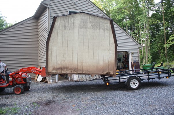

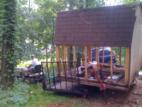

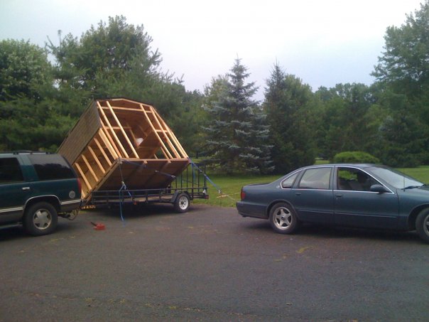

This is an old thread, that I realized I never updated. I wound up transporting a 10x10 shed about 30 miles on my 5.5x10 landscape trailer. Feel free to scold me!
With the siding stripped off:
Pulling it on with the help of a couple of highlift jacks and a Craftsman FF20
Pulled it around to the driveway on the other side of the house, and the shed fell off. Oops. We needed a car (a cool Impala SS) to pull it back on.
Structurally braced it and secured it to the trailer.
After a 30 mile, uneventful trip.
/ Transporting a Shed #18
Congrats...I don't believe I would have tried that one though.:eek:
/ Transporting a Shed #19
I bet the weight was not all that bad once you got the siding off. Maybe 1,500#?
Only ooops I see is were you tried to move it before securing it fully.
Good job.
Chris
#20
Hey, thanks. Yeah, weight wise, it wasn't bad, although probably technically over the limit of my 1500# trailer, which is not a massless trailer. It was light enough for my tractor to lift half of it, so it had to be under 1500#, actually. Last photo:
