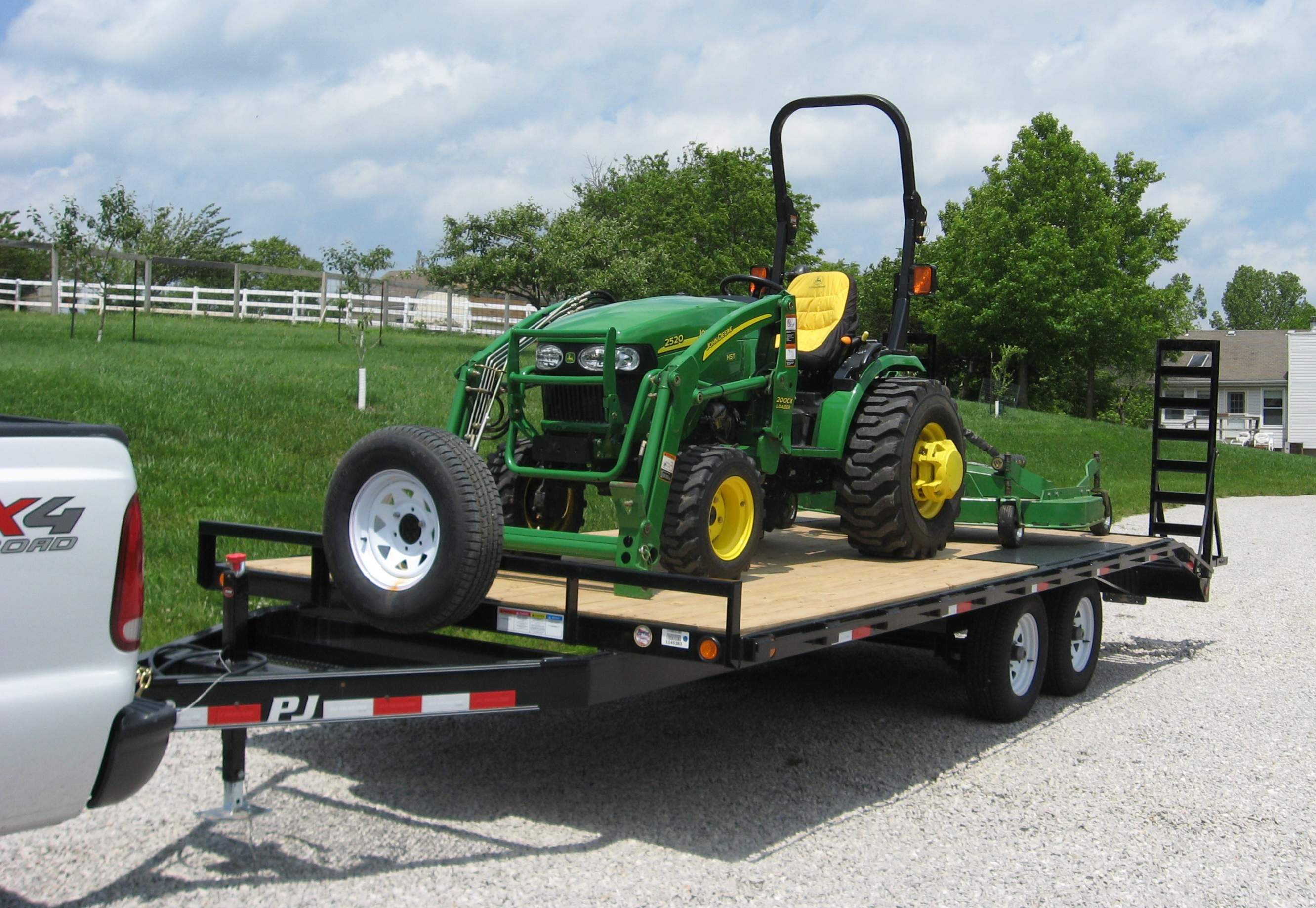

I use a 20 foot (17 flat/3 dove tail) PJ deckover for my 2520.
You might also want to browse the "Trailers and Transportation" page in this forum to get some ideas.
/ Transporting Your Utility Tractor #4
Looks like an 18' deck would be a better choice - especially if you have a number of attachments.
Runner's 17' deck is about right with the mower; but it would be better with the bucket on the loader and then you could stack a box blade inside the loader bucket, etc.

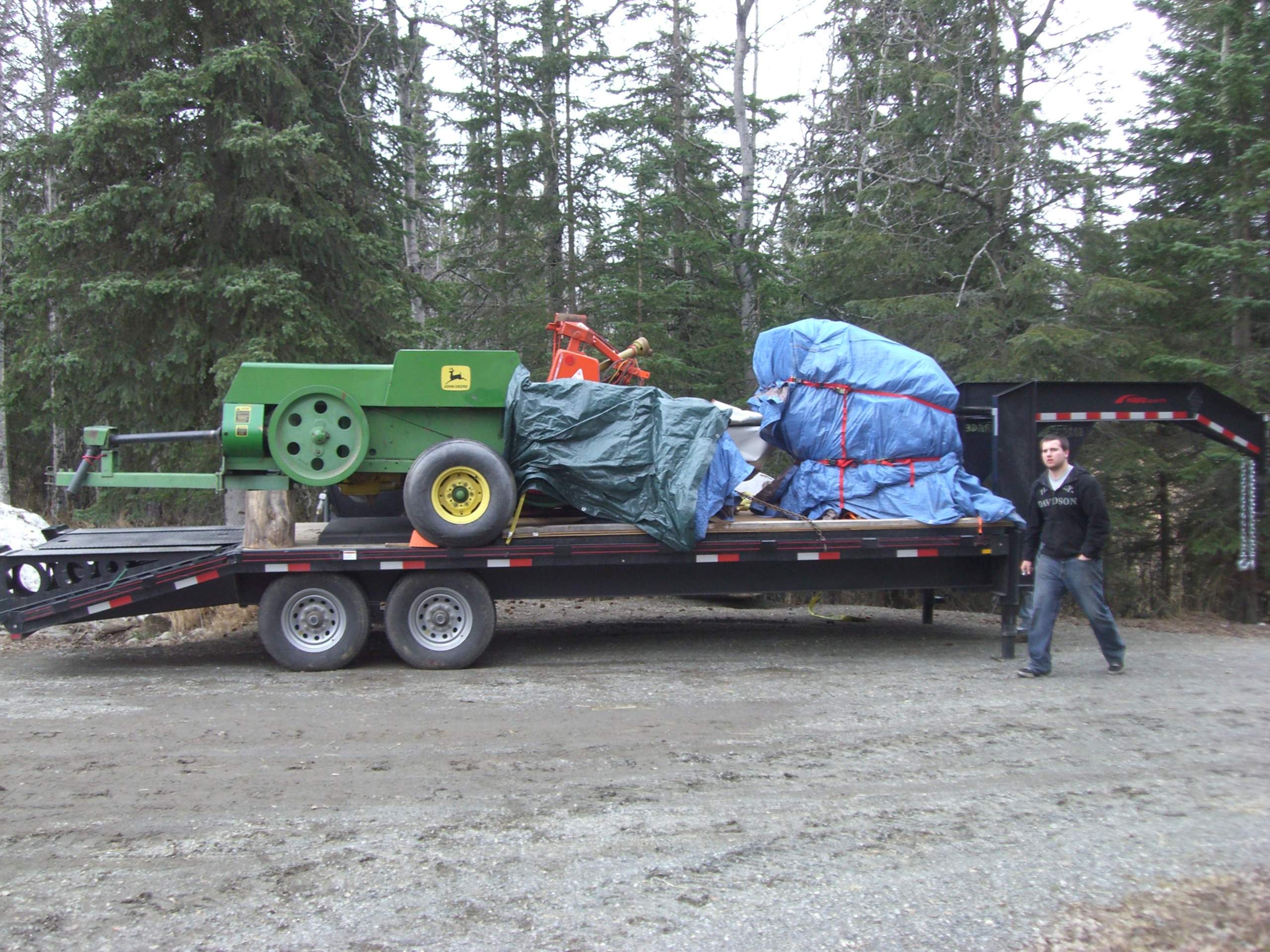

I've hauled a fair number of "odd lots" with my trailers - balers, mowers, rakes, tedders, waterers, hay bales, tractors, Bobcat loaders, tracked excavators, etc.
One of my 14K tilt-trailers had D-rings. My current 15.7K deck-over gooseneck has stake pockets and a rub-rail.
Any guesses which trailer has greater ease of securing a load? And greater flexibility to accomodate odd-sized freight?
Yep... stake pockets with a rub rail. :thumbsup:

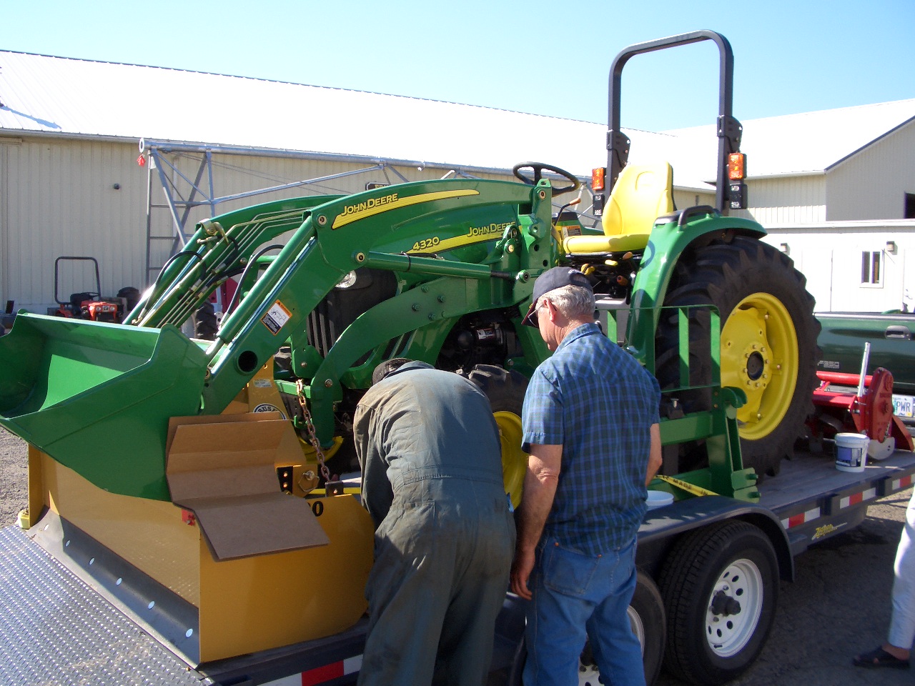

Here's a picture of what can be loaded onto a tandem axle 16 foot flatbed rated at 10,000 lbs. This picture was taken prior to transporting my (then) new JD 4320 + 400X FEL + Bucket + Pallet Forks + Box Blade + Rototiller from the JD dealer to my ranch 325 miles distant over the Cascade Mountains in Oregon. The load was pulled using an F350 7.3 liter turbodiesel. So, a 16 foot flatbed with electric brakes should work just fine for you.
I have since moved up to a JD 5083E Ltd for which I use a 24 foot flatbed rated at 25,000 lbs because of the larger size and heavier load weight with implements.
There ya go! I don't think I could see the deck boards! Great use of space.
