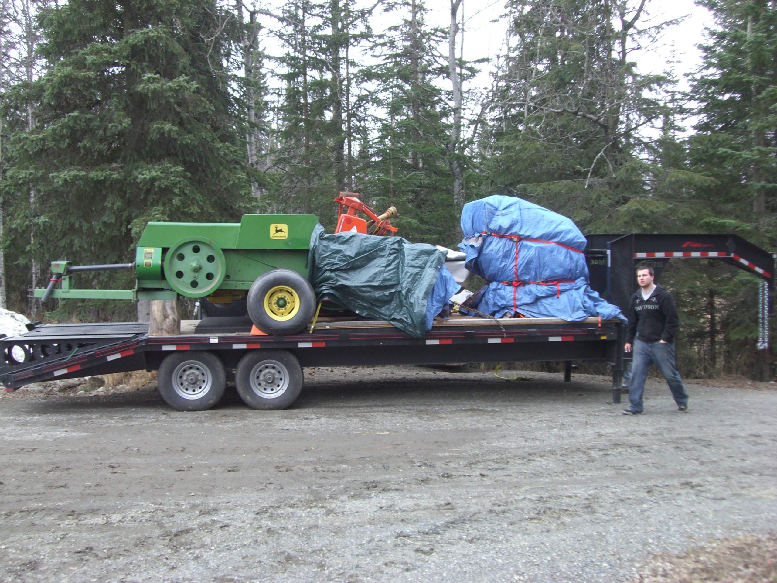

Depending on your truck off couse, when you go to 12k+ tandem axles trailers (fender or deckover) you get big tires (mine are E-rated 235/85-16) and BIG brakes (12+ inches) which is a nice-to-have.
Other than that, agree can't have too much trailer for plain utility.

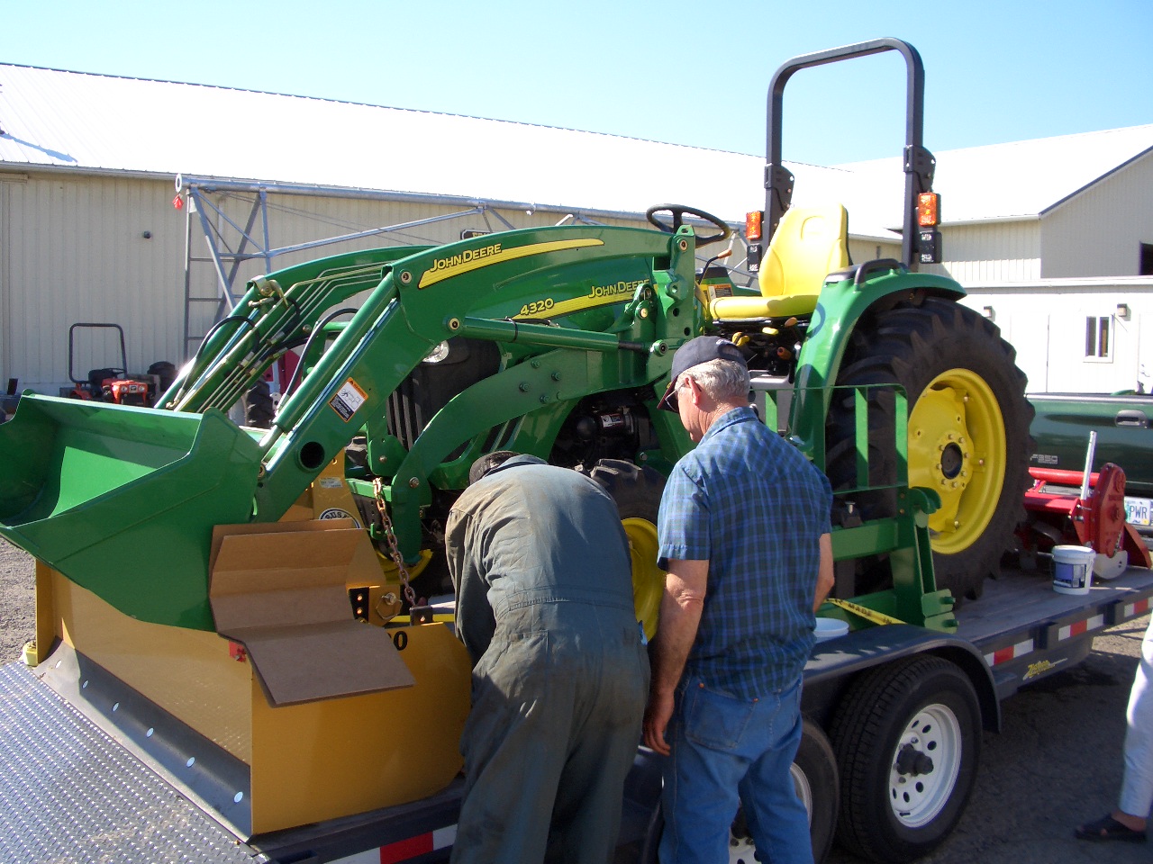

I have a 16' pj utility with sides and a rear ramp gate...drive the tractor on with the bucket all the way to the front, put parking brake on, shut the gate, and away i go. No chains or straps, couldn't be any easier. If its gonna go somewhere it'd take a heckuva ride to jolt it off the trailer...
Of course in states where they require tie down its easy enough to tie it to the side rails or anywhere in the extra stake pockets.
The front sides come out, and double as ramps for loading a atv or whatever sideways... taking them off makes it easy to set a pallet or whatever on as well.
Hope you don't go to far like that :eek:
I wouldn't even pull that around my yard!!
Are there states that don't require secure tie down of equipment on trailers??
I even strap down loader bucket and rear implement separately.

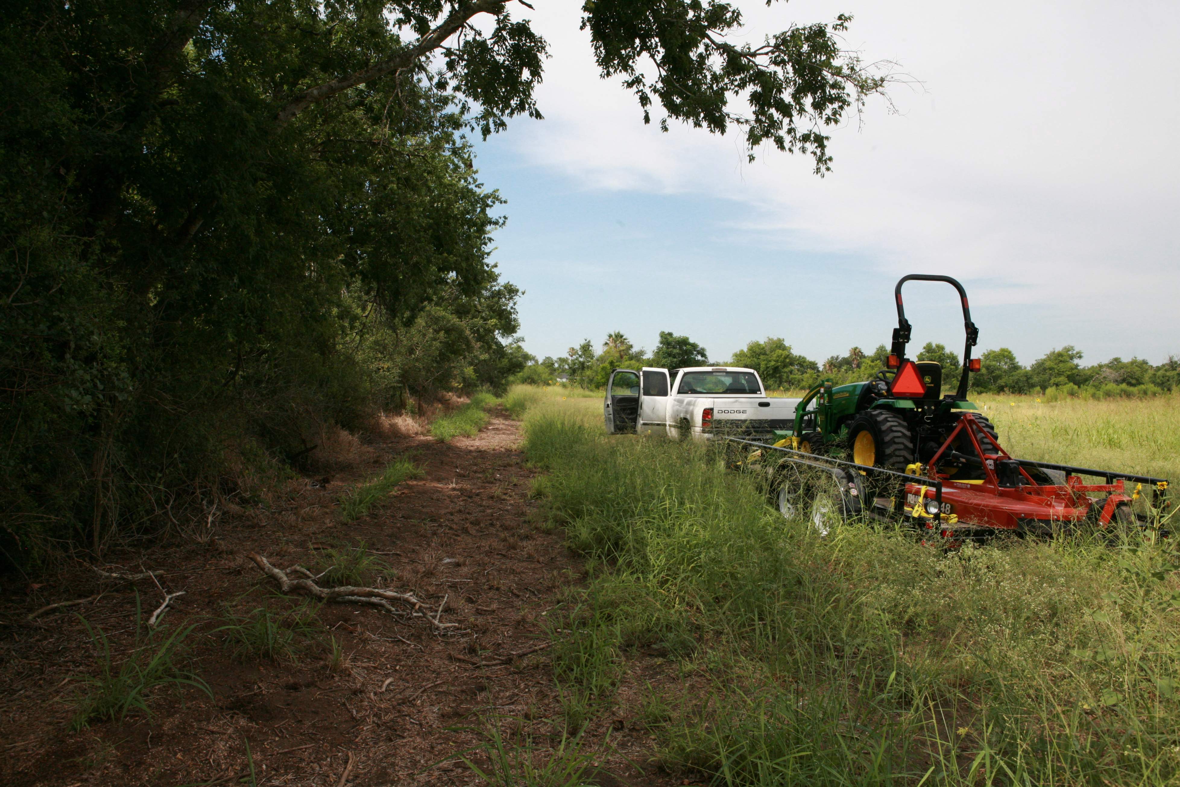

I use a BigTex 70P 16 ft. to haul my 2520. If I'm hauling the loader w/bucket and my cutter, the wheel of the cutter extends beyond the trailer. The edge of the cutter rests on the edge of the trailer, sometimes it goes beyond. Right now it only has brakes on one axle and haven't had a problem stopping.
JB
I agree! Common sense says tie it down! Maybe driving carefully around a golf course or something would be ok....but on the street or highway? Sure...you'll get away with it for a while...until something happens. That "heck of a jolt" could be you hitting another car that pulled out in front of you and that tractor may just impale your back and jam you against the engine. Or tip over and crush someone else. Think about it! Oh...thats right...I shoulda known...that stuff only happens to other people.

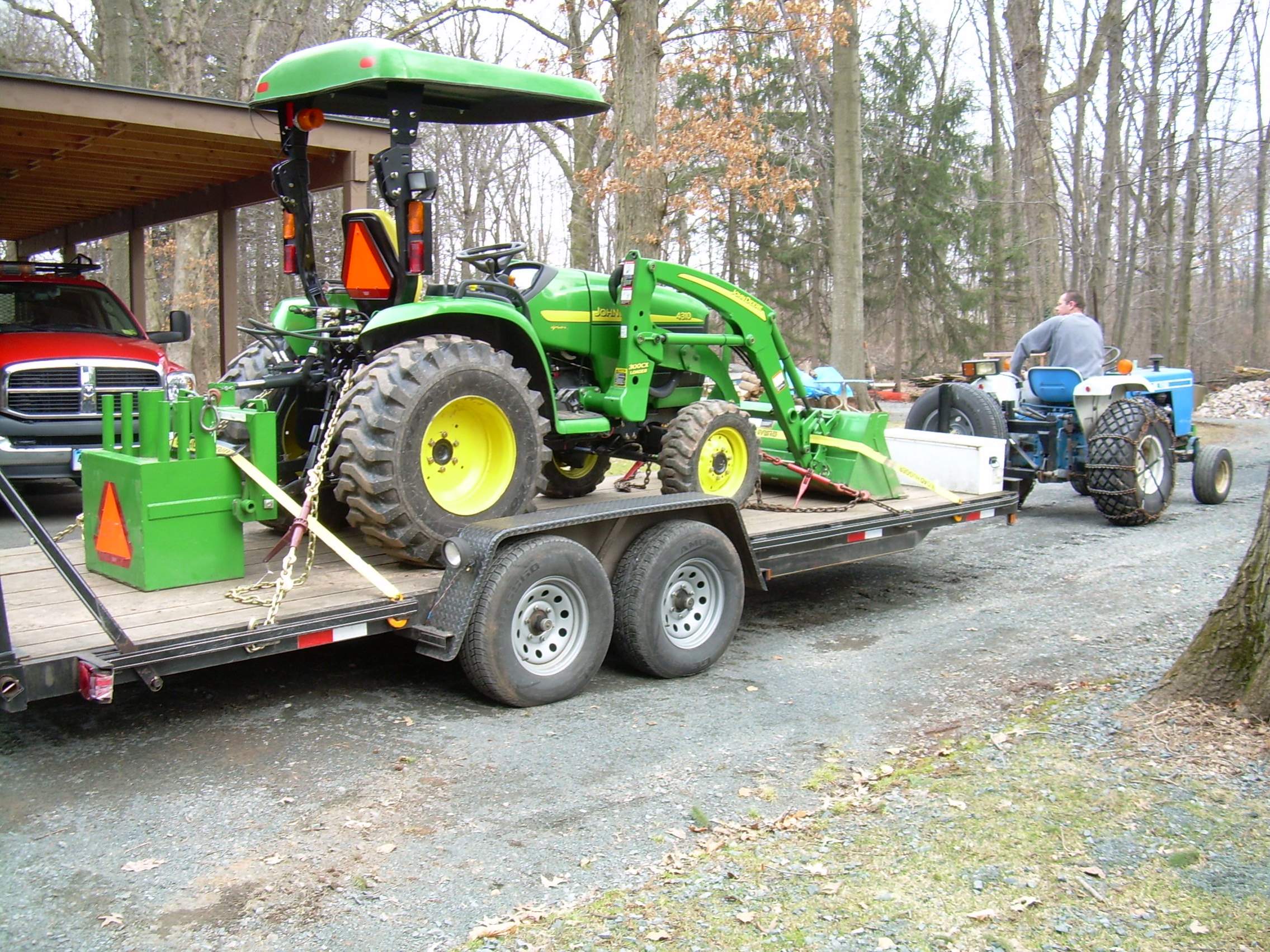

Here is my trailer and planter loaded up. Just got back from putting a plot in.
That looks like the load is fairly well balanced, but the way way the load is secured looks like it could be better. especially for going any distance over the road.
I'm not trying insult you, just some constructive criticism :)
I may not be seeing it all either, so it may be fine.
