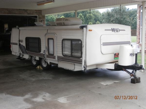

I later bought a HiLo trailer than is built like a shoebox and the upper half raises and lowers hydraulically. After living with it for some time I would no longer recommend them, but despite being heavy (5000lb empty), I would get 18mpg towing it with the exact same truck as before. If you go long distances, that makes a huge difference. However, the aerodynamic fiberglass trailers do just as well through their reduced drag and usually reduced weight.

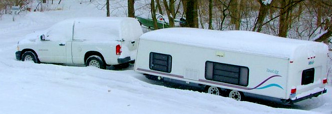

Could be that my 5000lb Hilo is much lighter with a much lower centre of gravity than your trailer ? My Superduty curb weight is over 7000lb vs the 5000lb trailer. With the Ram, it is more like 4000lb truck to 5000lb+ trailer. Not to mention that the trailer is much longer than the truck.. Of course people pull much heavier, taller and longer trailers than mine. But even the Hilo is a challenge behind the Ram 1500 without the anti sway hitch.
