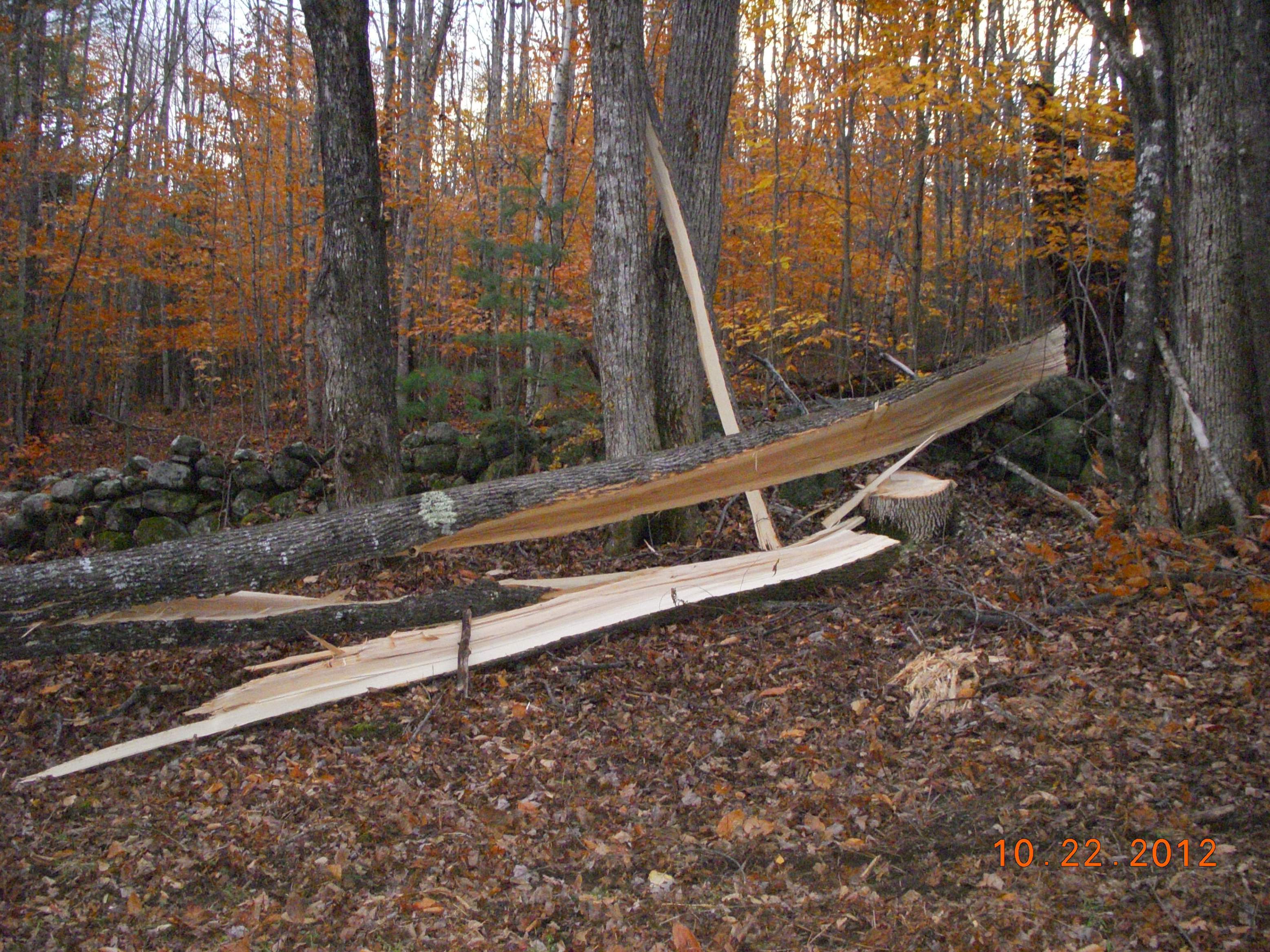

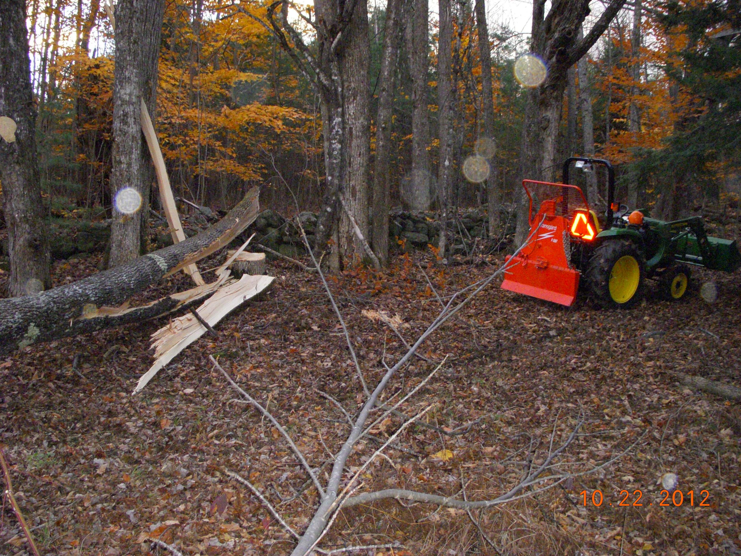

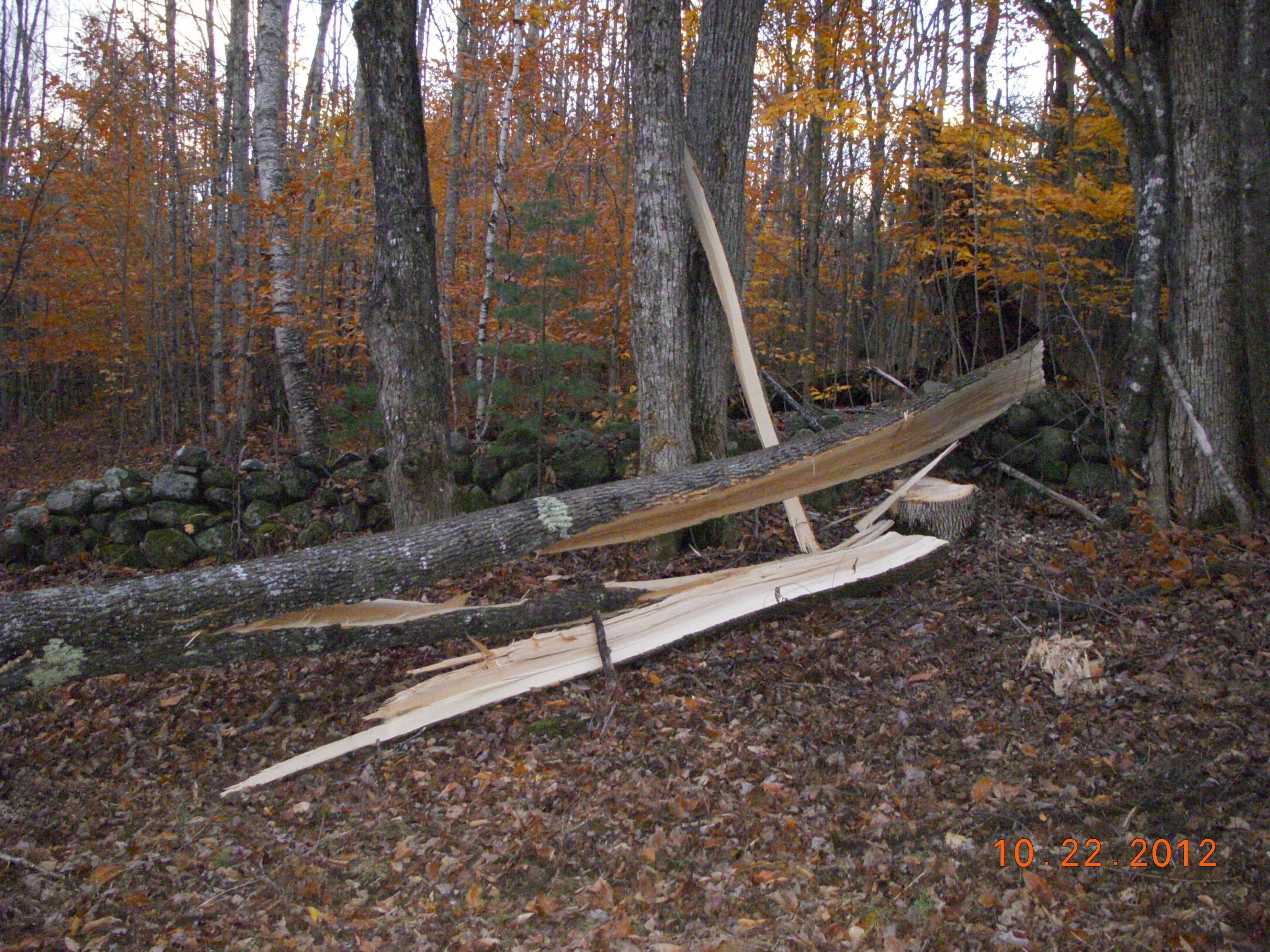

DSCN0403.jpgDSCN0404.jpgDSCN0406.jpgSo I was going about my usual logging. I was cutting an ash bout 18" at the butt. The tree was leaner so I was confident of direction of fall. Before I finished the cut the tree "BLEW UP". Never seen anything like it. Once my razor sharp reflexes kicked in I fell backwards and planted my face in the ground. :rolleyes:
There are several scenarios for 'widow makers'. Add one to the list.

That's something. It doesn't look like it was rotten in the middle or anything. Looks like it just split down the middle. Not sure how you could possibly have seen that coming. Yet another reason why leaners are dangerous. I wonder what a professional arborist or logger would/could have done differently.
Glad you didn't get hurt.
PS: I'm assuming you're not a pro, but if I'm wrong, I apologize, and I'd love to hear more from you on the topic. I drop a tree or two every now and then, but only the "easy" ones and I'm always interested in learning more about safety.

Always remember on leaners ( widow makers ) there is abundant stored energy in the leaning tree and the ones it is leaning against....hard to know what the reaction to making the cut will be....very scary situations...Think of huge rubber bands pulled tight and then you cut into the main one....Yikes ! Glad you are OK...

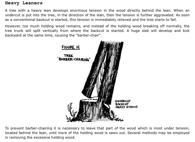

That's what is called a 'barber-chair'. Certain species of tree with specific grain structures are especially prone to this, ash being one of them. Leaners are even more prone to this, because of the extra stress on the holding wood during the backcut.
See this thread for a good explanation and some tips: http://www.arboristsite.com/tree-care-videos/177328.htm

With a lean you need to make your face cut then plunge through to make your hinge (being careful of kickback and not leaving your hinge too thin) then cut from hinge to the back instead of from the back in.
You can also chain the tree above your cut to help prevent it from splitting out.

No, I'm not a pro. I put up 6 cords a year for the following year.
A pro would probably have seen such a thing before and put on his spikes and started from the top down. Or find someone else to do it. ;)

Bob, the tree was a 'natural' leaner. It wasn't hung up on any thing. This was the initial cut. I've been known to leave cut leaners alone and let the next big wind bring them down for me. If it falls in the night I really don't care if anyone heard it. Sucker is down and I'm safe.
Good vid. Exactly what happened. And I did hesitate on the back cut. It's a habit of mine. I pay alot of attention to the hinge to angle the fall to where I want it. It was when I took a moment to double check my final situation before sawing through. The decision was made for me.
