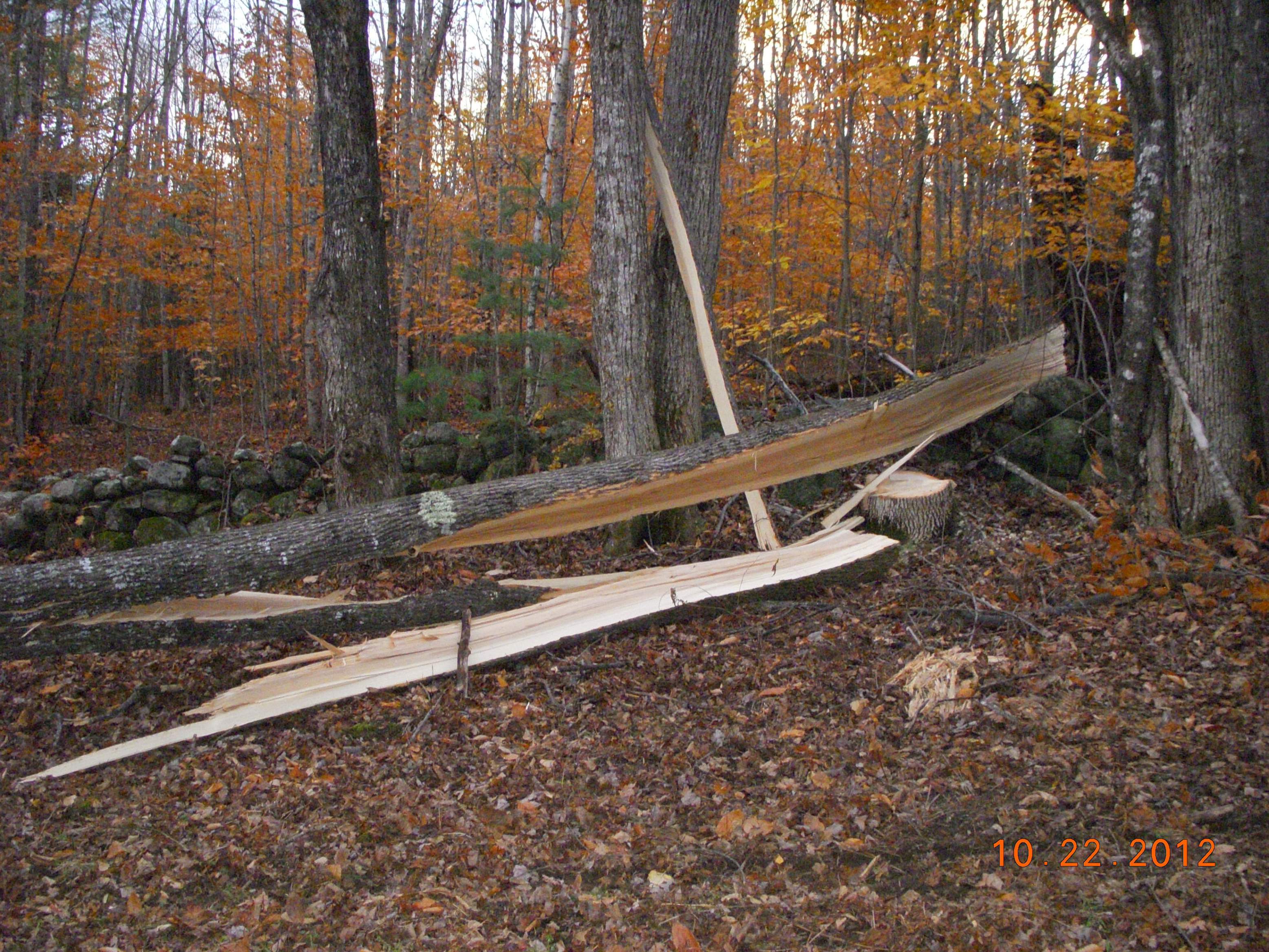

The longer the dead (EAB) Ash stand, the more prone to barberchair they become. Once the bark starts to split and fall off, the log will check, in some cases I've seen it go all the way to the pith. Turns a slight leaner that would have been an easy drop into a widowmaker.
Ed
/ Tree Felling danger #26

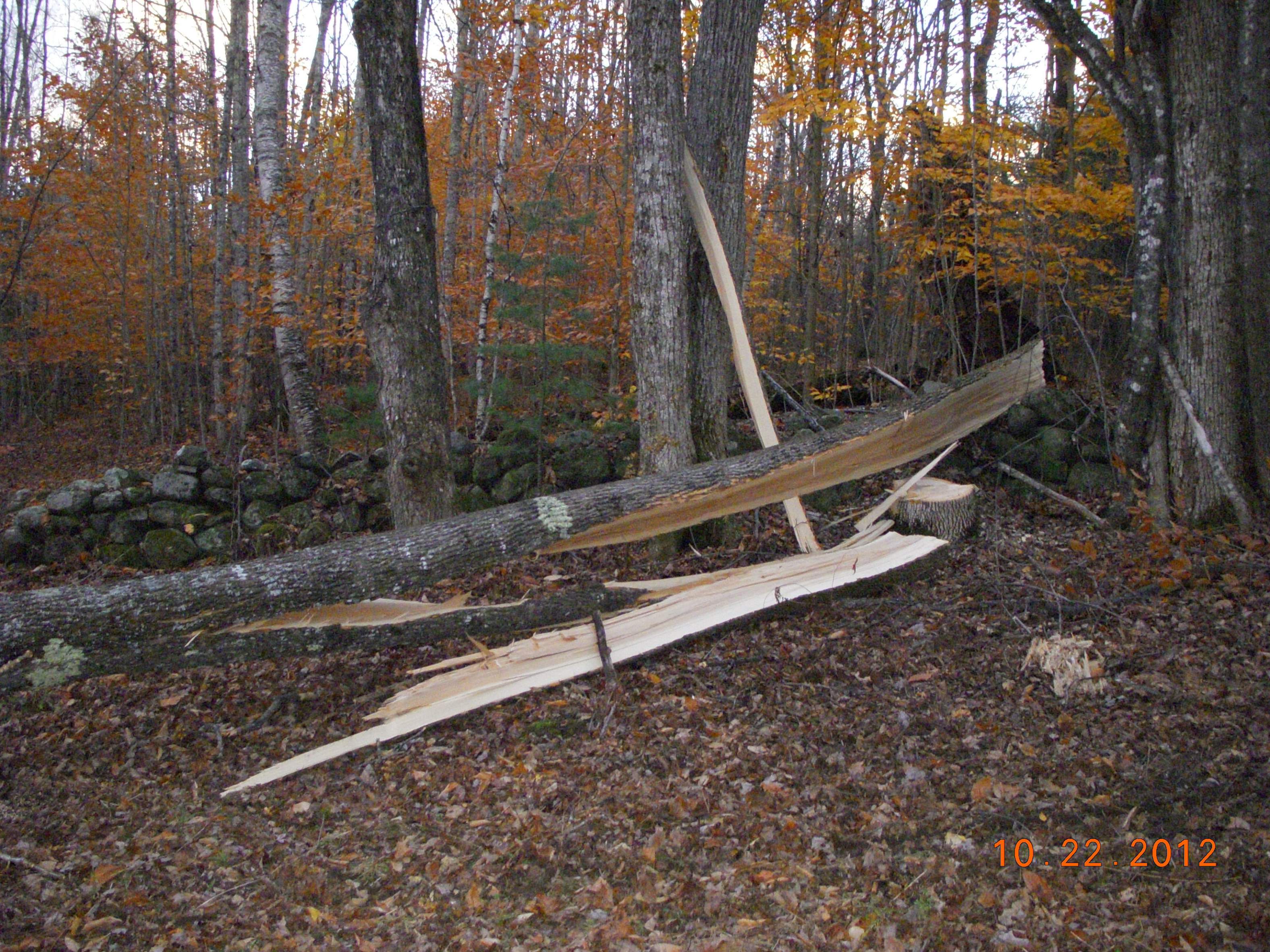

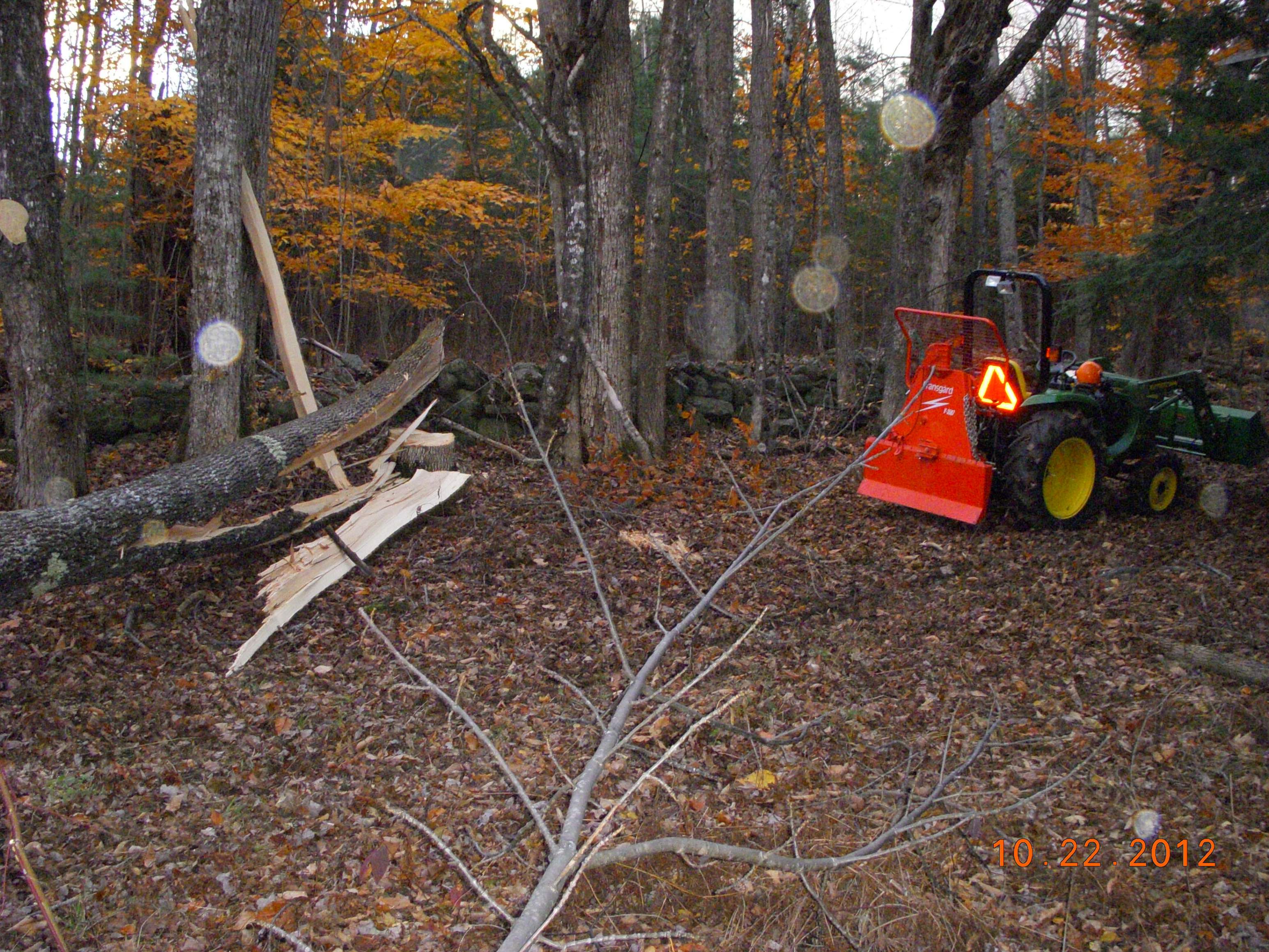

View attachment 286311View attachment 286312View attachment 286313So I was going about my usual logging. I was cutting an ash bout 18" at the butt. The tree was leaner so I was confident of direction of fall. Before I finished the cut the tree "BLEW UP". Never seen anything like it. Once my razor sharp reflexes kicked in I fell backwards and planted my face in the ground. :rolleyes:
There are several scenarios for 'widow makers'. Add one to the list.
I am a bit of a naysayer when I hear all accidents can be prevented, sure they can, stay in bed. I am by no means a professional lumberjack but I have cut allot of wood with a chainsaw in my 50-years. This weekend I almost got taken out by a 8" 40' tall dead cedar I could finally get at due to the low water level in our pond. Easy tree, leaning the way I wanted it to fall, perfect hinge, except when I went to step back from the tree my foot was stuck in the mud. My lighting reflexes dropped the saw and I grabbed the trunk with my right hand as if I could stop its momentum. Physics took over and threw me on my butt which jammed the heck out of my wrist but fortunately knocked me out of the way. Fact is none of get out of this alive and we all should raise our beers to dumb luck and not try to over analyze every situation. Glad you and I were not seriously hurt. Maybe next weekend :laughing:

I learned to chain leaners a few years ago, after watching a few barber-chairs on Youtube. Small slow saws are killers too... the longer you spend behind the tree making the back cut the longer you're exposed to danger if a gust of wind catches it.

Lots of good info here, but nobody discussed the notch.
It's hard to judge in those pics, but I don't see much of a notch on the stump. Having no notch or too little of a notch can dramatically increace probability of barberchair. Essentially this creates too much holding wood. When wood is "held" and not free to hinge over, the momentum and pull of the canopy will split the wood along its grain (barberchair).
/ Tree Felling danger #35
Even a too shallow notch will do it. My only real barber chair happened that way. Tree fell correctly until that undercut closed and then it split.
Harry K
/ Tree Felling danger #36
I can't tell from the picture but it looks like the notch was at 90 degrees? On the beheading I mentioned above, the guy had no notch what so ever. It was his first and last tree he ever cut.
