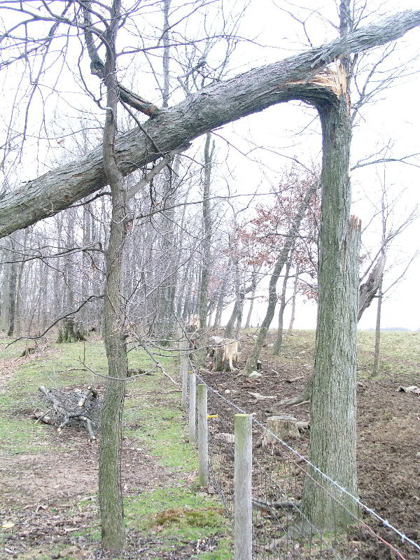

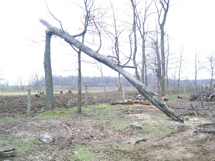

I may have missed something in the comments above but from looking at the photo it looks like the problem is the responsibility of the neighbour as the tree fell from his side. That's the way the law works in my area. Of course it is neighbourly to offer to help but not do the whole job of fixing the problem.

There's no issue about whose problem it is. I just was looking for ideas to get the thing down without damaging the fence. I even get all that nice hickory firewood to heat my house next year! :) I don't mind cutting up the tree at all, and the neighbor's hired hand doesn't mind the work of getting it down. We just don't want to cut or smash the fence.

Based on that chart, averaging the diameter of what's hanging there, I have a section about 30 feet long weighing in at somewhere around 900 lb. with one end still attached 14 feet or so above the ground and 5 or 6 feet on the other side of the fence we don't want to harm.
My 54 inch wide tractor will lift about 1200 at most, and to get hold of this thing at the balance point I would need to raise my bucket to nearly the full height. Factor in the uneven ground and I think trying to pick it up with my tractor and set it back over the fence is a recipe for a rollover, even if there was room to swing it, which nearby trees prevent.
I think I'll just wait for the big front loader to get it cut from the other side.

IMO this thing is being grossly over engineered. The problem is how to remove the broken top without hitting the fence.
That will require propping it up so it can be 'chunked' back as far as possible without the chunks hitting the fence.
Simplest way is a set of shear legs, an A-frame of 2x or 4x stock crossed at the to form a 'V' notcth for under the top. Bottom best on the tree side of the fence leaning over it. Per the chart it only weighs 900 lbs which is partly supported by the tree.
Now cut back the top as far as possible without the chunks hititng the fence.
You now have the tree standing solid, the 'stub' solidly propped. Neither can go any place assuming of course that the broken hinge doesn't completely let go and per the picture that is extremely unlikely as long is it isn't allowed to move.
Just a matter of falling the tree away from the fence, as it falls the stub will follow clearing the fence. You can be assured the tree will fall away from the fence by either pulling on it from the pasture side or pushing from the fence side with bucket (use a 'push pole' if needed, if so another A frame will do). Probably could just push on the stub to start the tree in the right direction.

Okay, the tree is down, all on my side of the fence, no damage to the fence.
With the hard freeze this weekend, the neighbor brought his big Cat payloader in to where the tree is. He set the bucket (about 10 feet wide, at least!) where he could chain the tree to it, then set about cutting the hanging part free from the stump. It was still hung up in my small tree, so we cut about 6 feet off the top (ground contact end) and then he managed to move the thick end over on his bucket. After cutting off about 3 feet of split section, he dropped the rest down on my side of the fence.
I had underestimated the size of the thing. My 16" chainsaw bar was too small to cut completely through the log at a point that would have been about 15 or 16 feet off the ground on the standing tree. That, in conjunction with the handy chart provided a few posts up, plus the fact that my DX29 was not able to lift the shortened section laying on the ground leads me to figure the whole part that was over the fence was pretty close to 2100 lb. maybe more. It would definitely have been a not fun situation if I had managed to dislodge the thing with my tractor.
The butt of the tree, cut off and set over the fence, is around 14 feet long, probably 18" diameter at the top, and somewhat bigger at the base. Using the chart again, this shorter section of hickory comes close to 1950 lb. Again, not something the DX and the LX114 loader is going to move.
