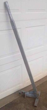

with over 4,000 x-mas trees in the ground, I have an ongoing need to pull the dead ones so I can replant. I've been using a HD Brush Grubber, which works fine for the trees on the edges of the fields, but I can't use it in the middle of the fields because the tractor would tear up the other trees.
After reading this thread, I decided to build a weed wrench copy like Brad_Blazer - I went with the simpler design of the original, which works fine - this thing is great, works good on my trees up to about 4 foot tall - and a lot quicker than using the grubber.
Jeff
