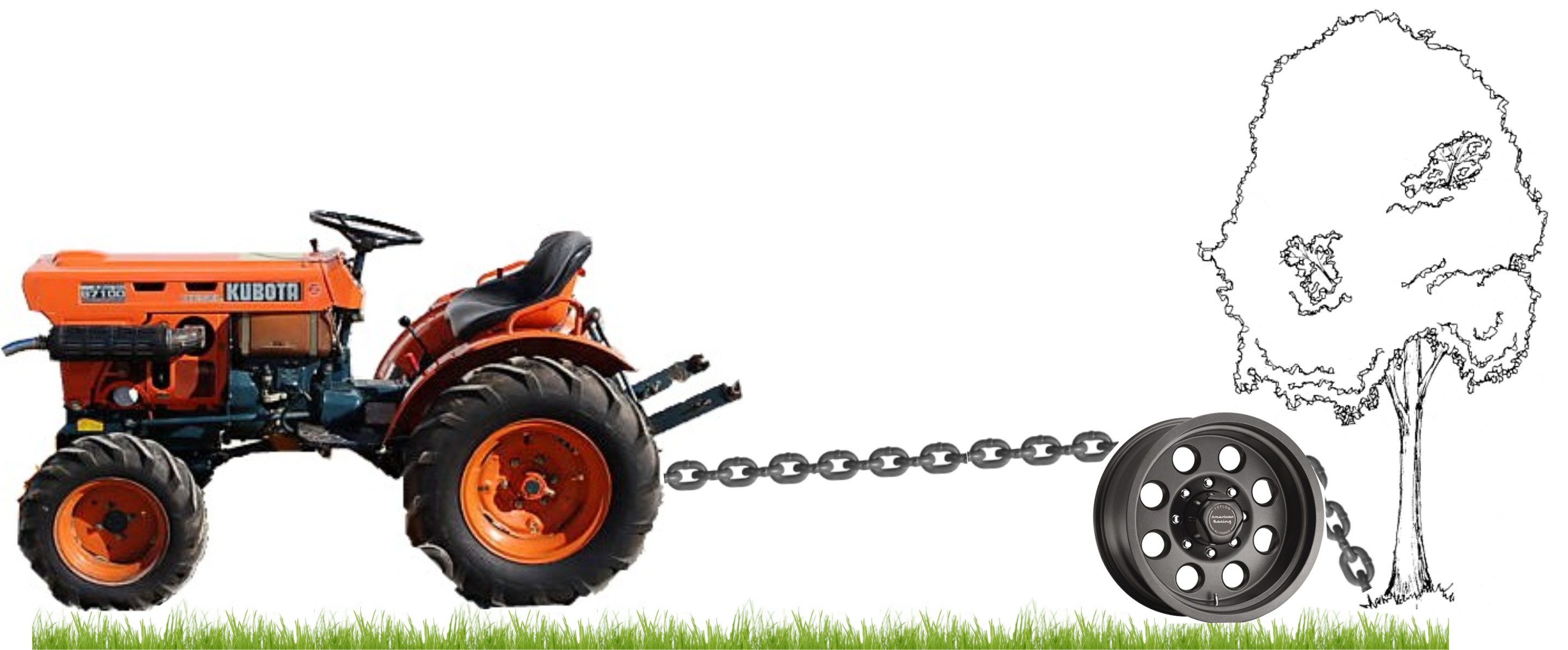

Call me dense, don't get it. I know you don't mean with the tire on it.
Never have tried the rim myself but am sure one side could sink deeper than the other but gee, how precise is pulling trees. Could not one leg sink deeper also?
The rim is the outer part of the wheel which basically retains the tire on the wheel ... I'm picking at you a little bit but now days so many people talk "Rim equals Wheel" which is not true since the rim is a part of the wheel assembly!

Sorry for the confusion, my error, rim to me means a naked wheel without a rubber tire mounted.
   / Tree Puller for hard to get at trees #23
That was a nice solution to your problem and there was no problem or confusion ... I agree the wheel is also good way to go ....

I am still a little confused. Should you use just the rim or the entire rim/tire assembly?
A wheel with tire mounted I believe could be unstable (tipping to the side)(although I can't say I've ever tried it) Also it could not keep the chain aligned as well as a bare wheel, and could allow the chain to slip off to the side. (but again I've never tried it)
A bare wheel shown here is being pushed down into the ground fairly hard. If it leans far enough to one side, where the down force of the chain is beyond the footprint of the wheel, it could flop on it's side. That is why I suggest using the widest wheel possible.
Also that is why I made the bipod frame with a wide stance and big feet.
Hope this helps.

hi, i think the "rim idea" is great, but it does not offer the "lever advantage" that Sherweld's bi pod does.
the rim feature is, it changes the pulling force to lift. the pull to lift ratio remains at 1:1 because there seems to be no fixed pivot point to determine a pull to lift ratio.

The wheel does indeed offer a couple of advantages:
it does change the direction of pull,
it is quick (no construction involved),
it is cheap,
and there is indeed a small mechanical advantage (perhaps as much as 2:1) at the start of the pull. (but that's another discussion)

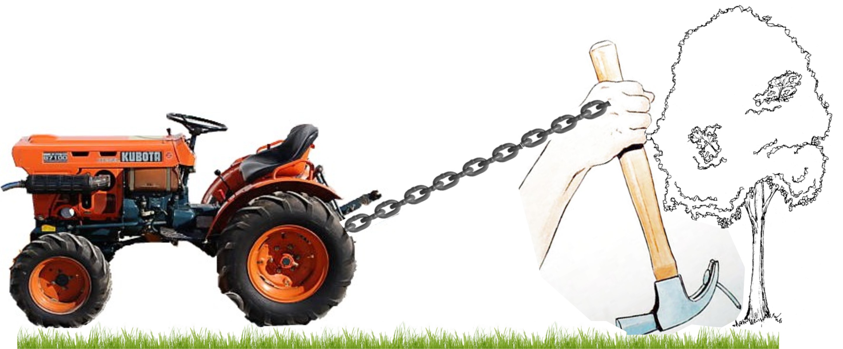

However, before we got on that wheel tangent, I was going to post the analogy of a claw hammer or wrecking bar.
The thing to remember about this scheme, is that the link from the base of the tree to the top of the bipod (or post, or 4"x4", or whatever) is fixed, making it basically a triangle lever. The mechanical advantage is determined by how far the "foot" is set from the tree.
Set it close, and there is enormous mechanical advantage. Either the tree is going to come up, or the "foot" is going to sink in (large feet help here)
In practice, I found that the bipod sometimes had to be reset a couple of times, that is, close to the tree to get things loosened up, then reset further away to get the tree out of the ground. (much the same way that putting a small block under the head of a hammer will help pulling a difficult nail)
Hope that helps

the chain over rim is not rigid, so no mechanical advantage.

As Sherweld points out, there is a fixed length of chain from the bipod connected to the tree. Then there is the connection from the bipod to the tractor. The two connections don't need to be in the same place. In fact, for a given connection (bipod to tree) the higher up you connect the bipod to tractor would give you more leverage.
It's like holding on to the claw hammer example.
The higher up you hold it on the handle, the easier it is to get the nail out.

I stand corrected, a pole that has the chain fixed, will act like a leaver. (add a pulley and its all out the window.) I am the skeptical type and did have to do the math and I did come up with an advantage.
As mentioned previously, get the post as close to the tree as you can, and have your tractor pull the chain as perpendicular to the post as you can.
Guess I was asleep at the switch on that one, my bad.
