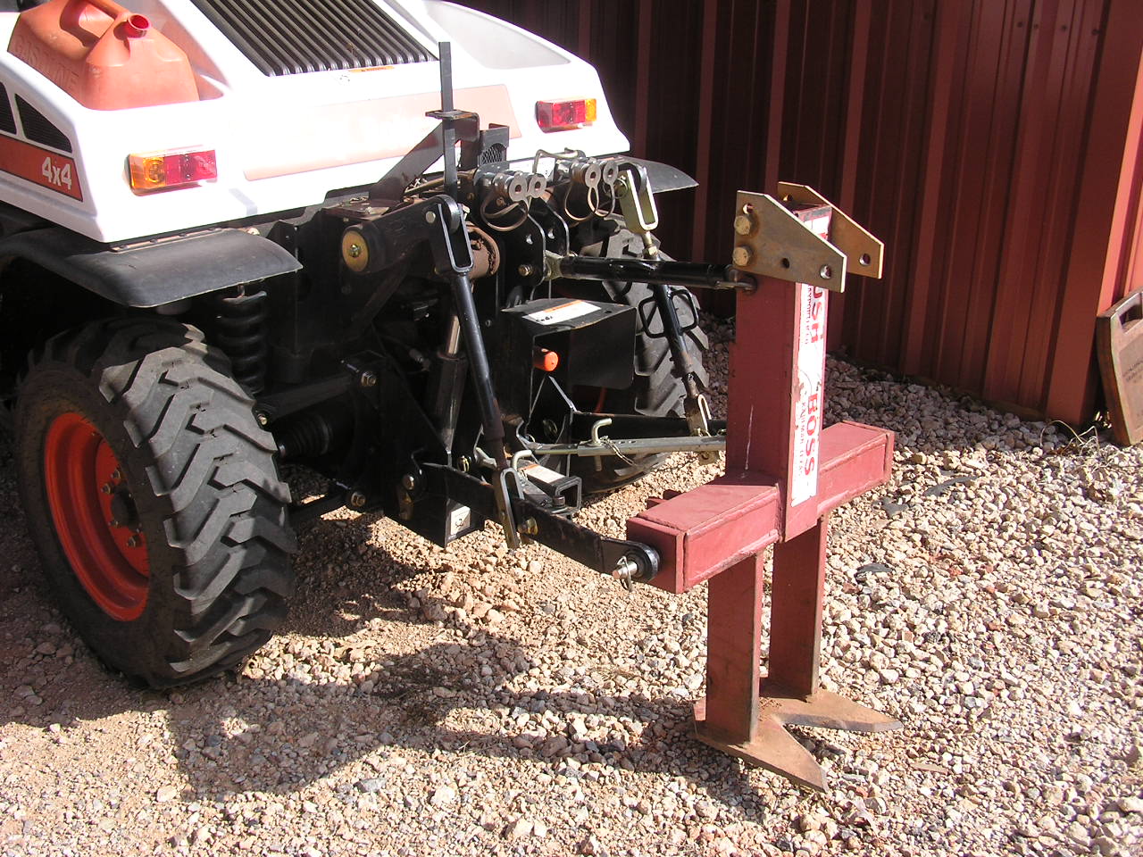

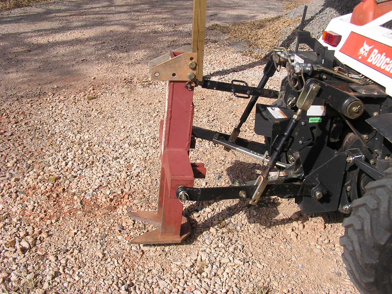

Many years ago I had this on a MF240D 3 point.
View attachment 334383 View attachment 334384 View attachment 334385
It was too much of a hassle backing up to each tree, so I turned it around. any tree that I could drive over it would pull out.
I took some pictures that show all of it and the bracket for the top link, that allows it to be turned around.

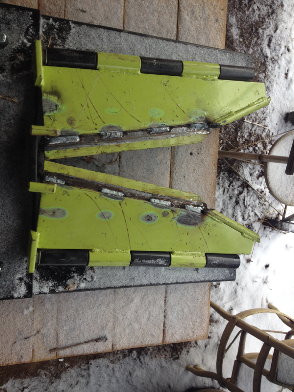

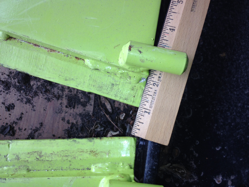

Brush Grubber BG-10: I bought one of these and soon learned the gap was too big for most of the trees I wanted to remove. I'm wanting to pull out willow trees, 1-1/2 to 2 inch diameter. My co-worker suggested grinding off the welds and re-welding the plates so I can grub smaller trees. My modified tree puller is shown below -- before and after...
   / Tree Puller? #48
Well, does it work like you want?
   / Tree Puller? #49
Not sure yet. We still have snow on the ground here and I'm more of a fair-weather tree puller! Will let you know when Spring arrives. I'm hopefull this modification will do the trick.
